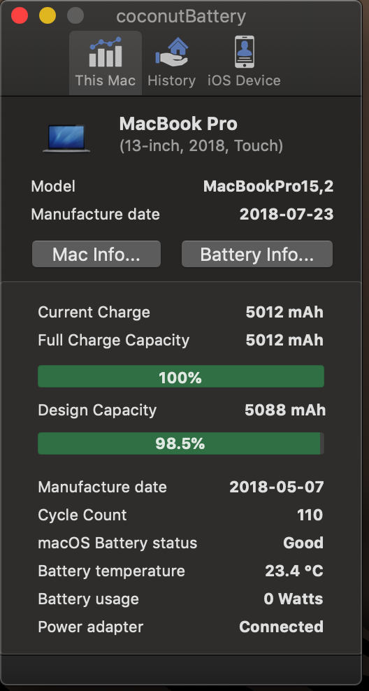

Disclaimer: Both devices have the latest updates and same software versions. The Pro has 110 cycles on the battery but Coconut battery reports 98.5% life left. The Air is new. Both devices are base models with 8gb of ram. The only difference is my Pro has 512gb storage and the Air has 256gb of storage. Both devices were wiped clean and each app was installed in the same order mirroring each device. All settings have also been mirrored between devices. No other apps were in use during the below tests. Bluetooth, wifi, location services etc were left on to simulate day to day usage. Bluetooth was not connected to any device. Wifi was connected to the same 5g connection on both devices and they were side by side 15 feet from the router. Auto-brightness left on both devices in hopes to have roughly the same level of screen brightness on each device since I don’t have a meter. True-Tone is turned on for the Pro. Volume was at the same level on each device.

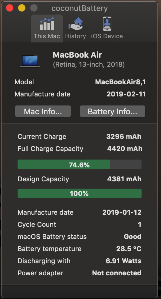

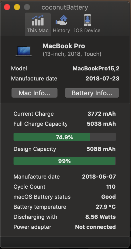

Battery Life (Full capacity verified with coconut battery. Air would not go above 99% in CB even after 2 hours of being plugged in. Pictures below):
Same Youtube Video, played in Safari, on loop for 2 hours from 100% charge.
- Air down to 74.6%
- Pro down to 74.9%
Mac OS showed 78% for the Air and 79% for the Pro which I found interesting.

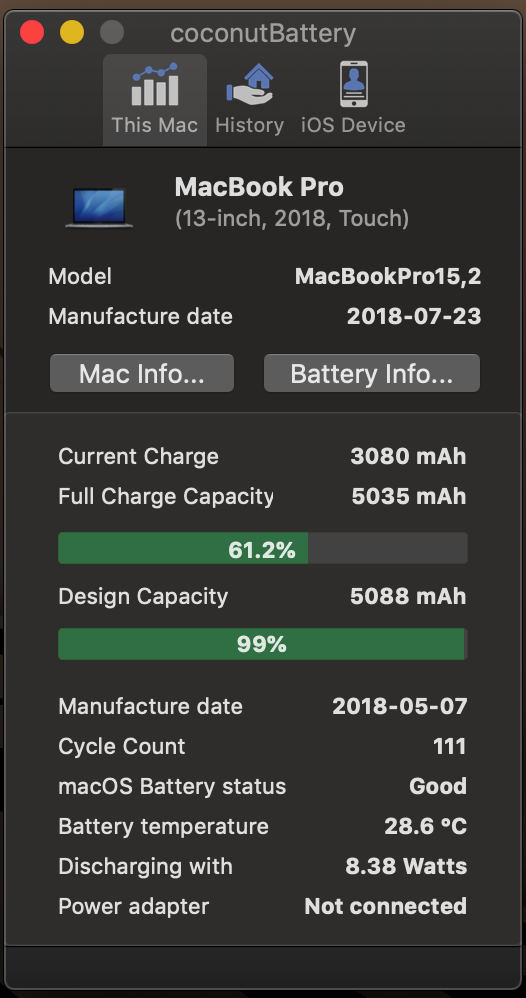

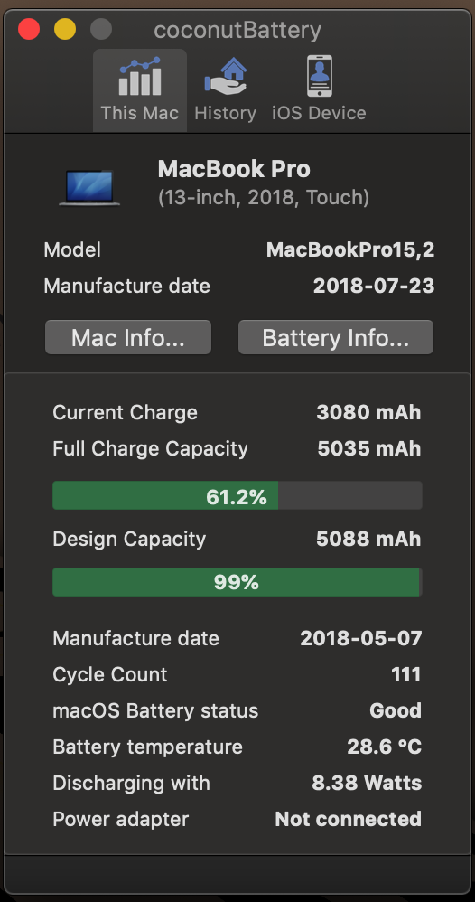

Same local video played for 1 hour in VLC from the percentage listed above (Air 74.6%, Pro 74.9%)
- Air down to 60.1%
- Pro down to 61.2%
Mac OS showed 65% for the Air and 66% for the Pro.

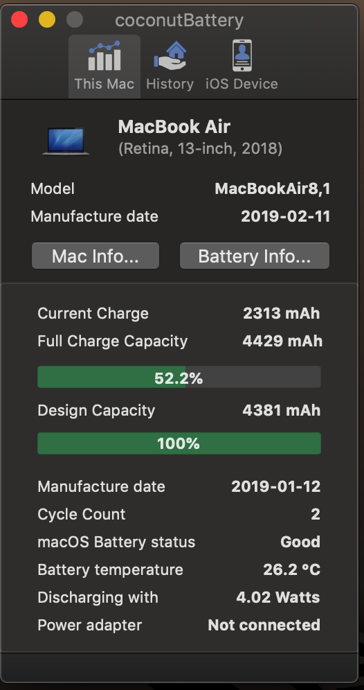

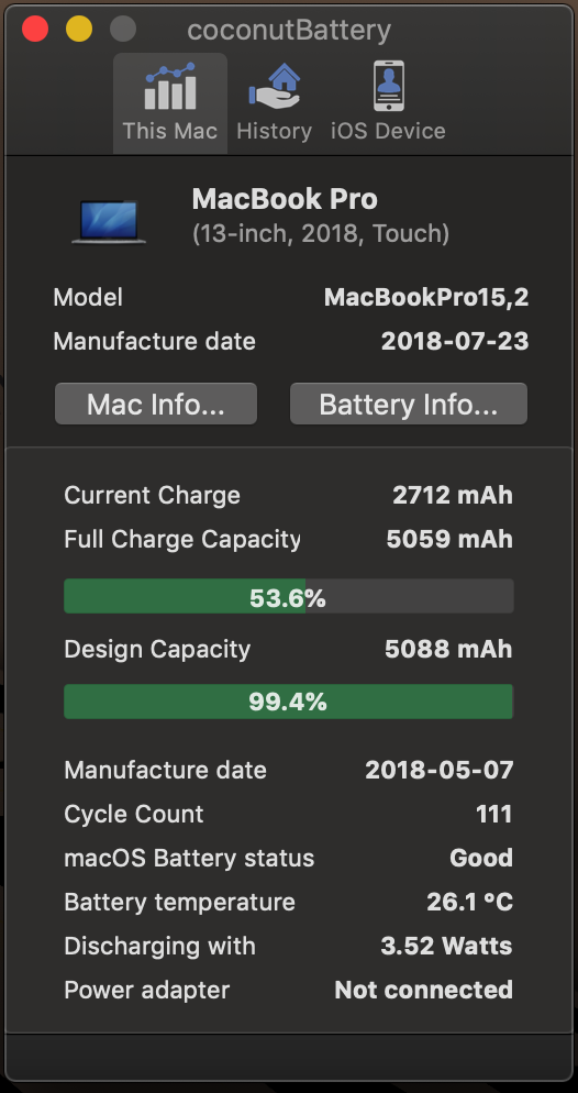

Back to battery life:
After finishing these tests the batteries are as follows.
- Air down to 52.2%
- Pro down to 53.6%
Mac OS showed 55% for the Air and 56% for the Pro.

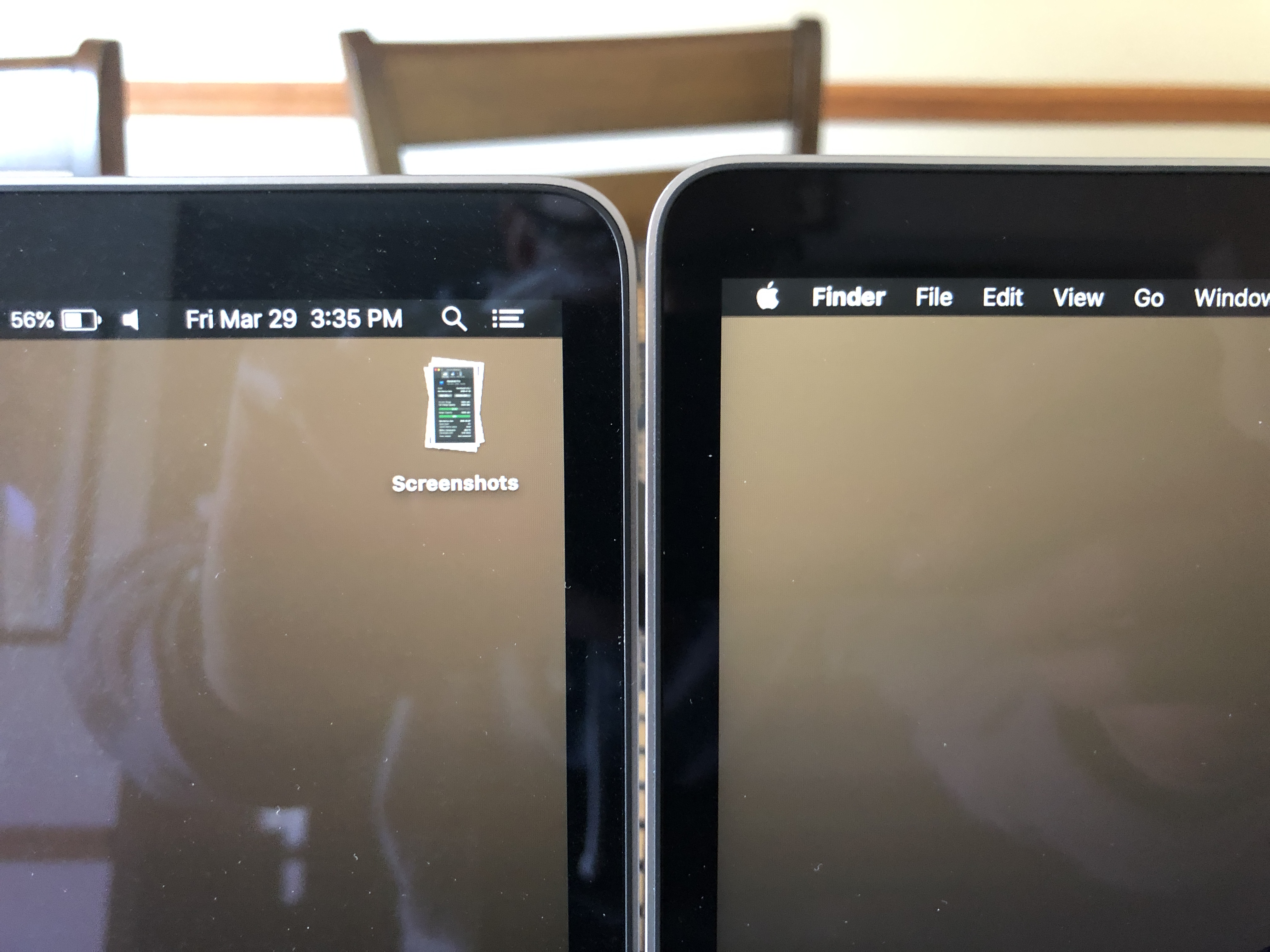

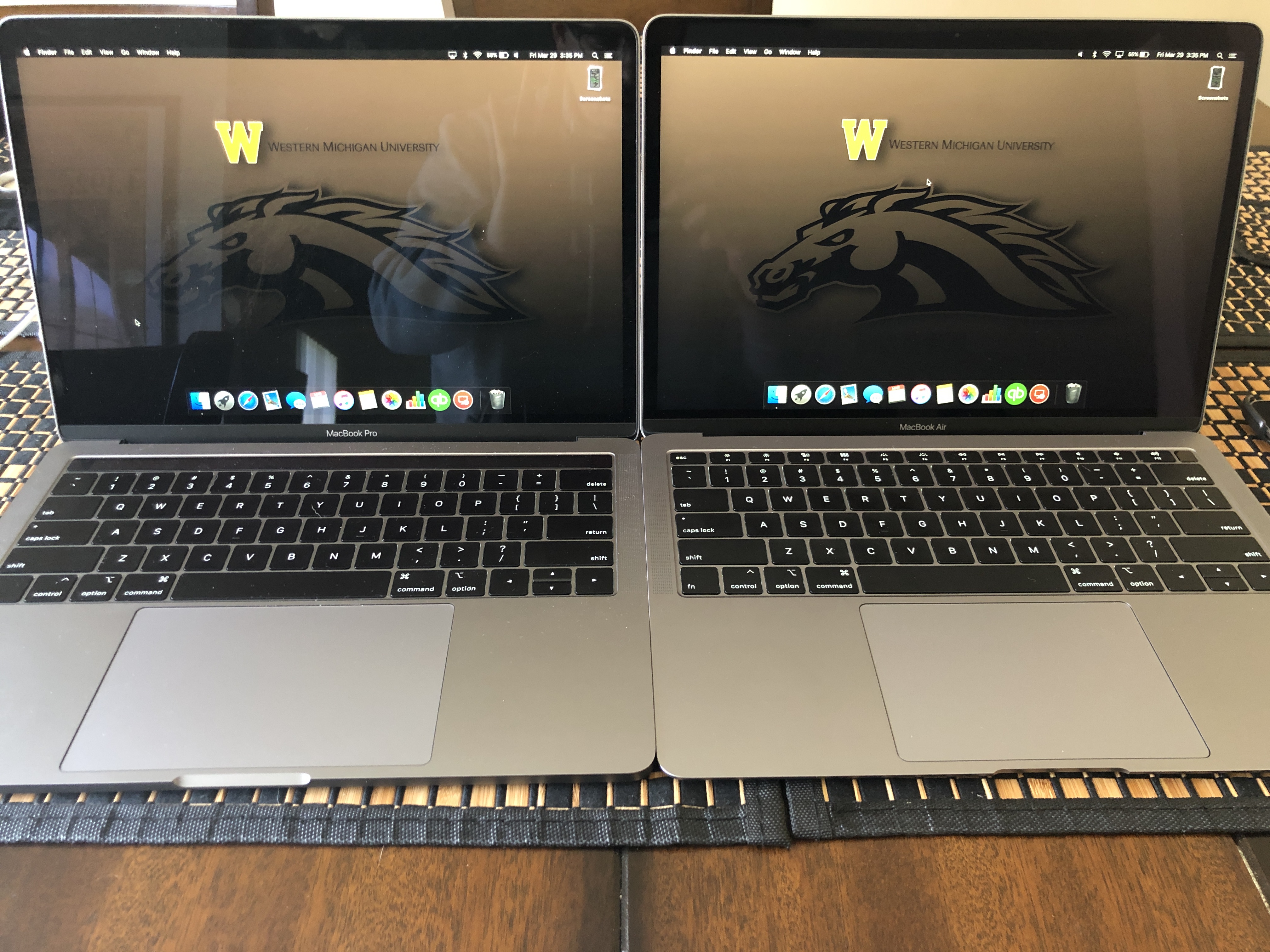

Heat wise, the Pro clearly does better in this regards and I wouldn't expect anything less.
My Opinion:
Where the Air used to shine in battery life, it just isn't the case when the Pro has the bigger battery. The Pro has a better screen in terms of brightness, True Tone and the P3 Wide Color Gamut. If you can afford the cost increase which varies week to week, the Pro is the better buy imo. At this point Im thinking I will return the Air and get another Pro since I need 1 for the office and 1 for the home. I'd much rather have the extra power and better screen.

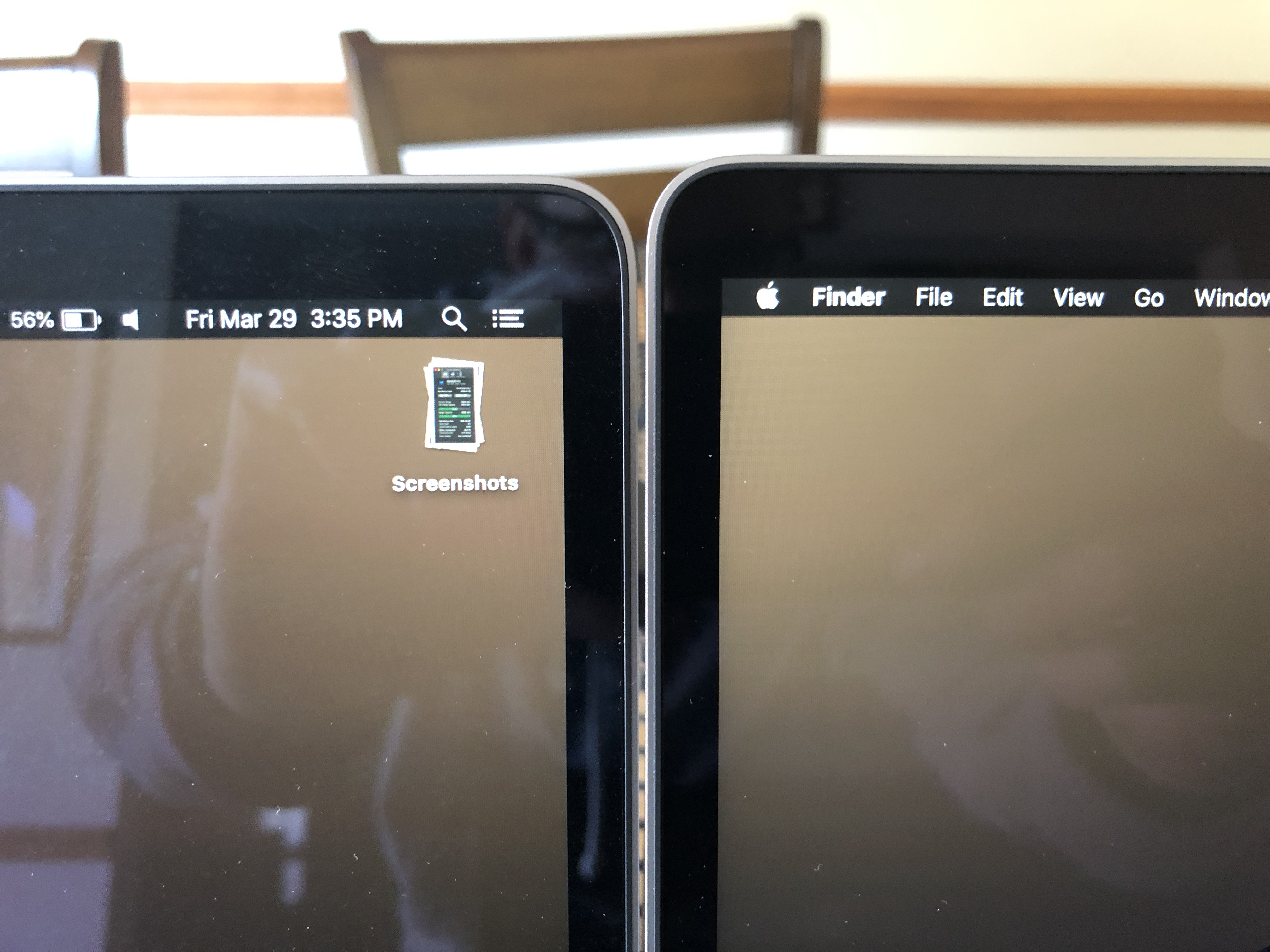

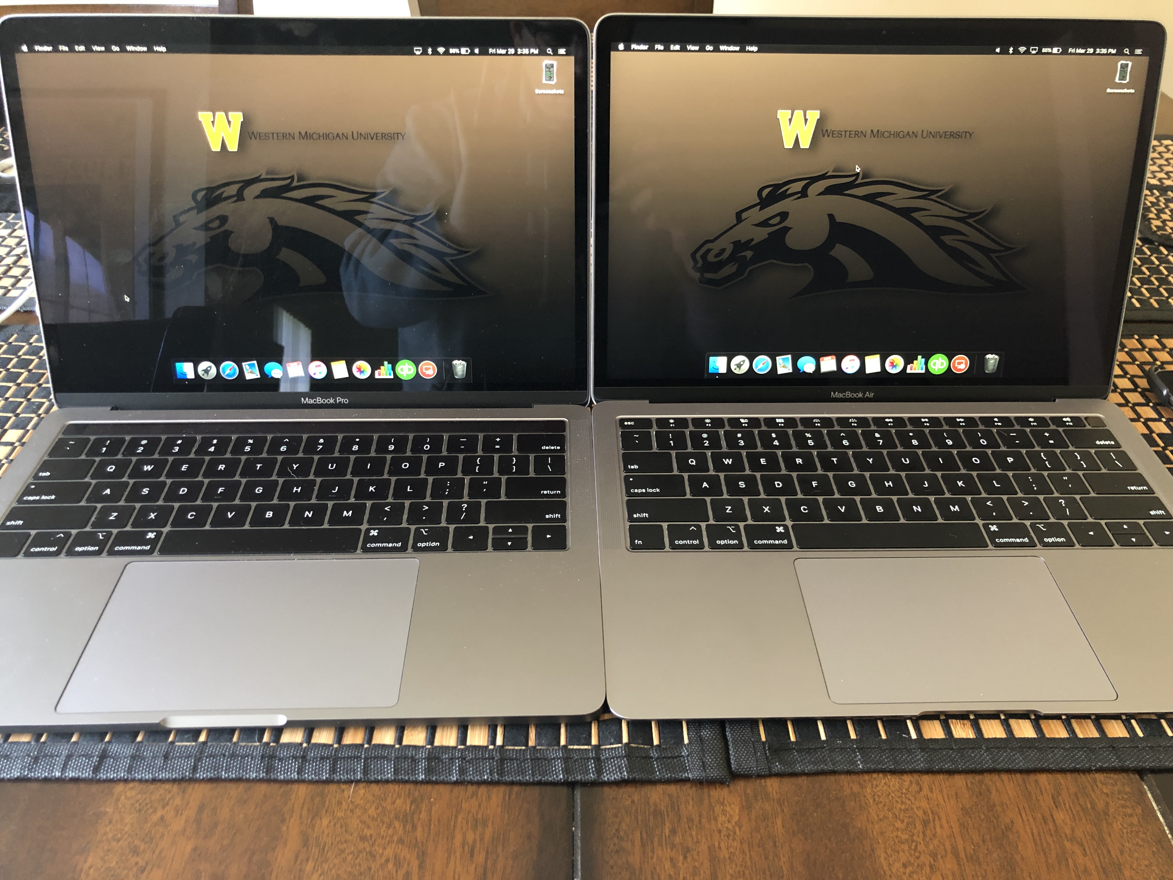

Heres the screenshots and some side by side comparison pics.
Screen Shot 2019-03-29 at 11.30.08 AM.png Screen Shot 2019-03-29 at 11.56.09 AM.png Screen Shot 2019-03-29 at 1.59.40 PM.png Screen Shot 2019-03-29 at 1.59.47 PM.png Screen Shot 2019-03-29 at 3.00.01 PM.png Screen Shot 2019-03-29 at 3.00.15 PM.png Screen Shot 2019-03-29 at 3.37.56 PM.png Screen Shot 2019-03-29 at 3.37.51 PM.png IMG_0144.JPG IMG_0145.JPG

The only advantage i found in mbp is p3 and true tone. Forget the brightness i am indoor with my comp. but after seing p3 truetone, mba screen looks dull and cool.
