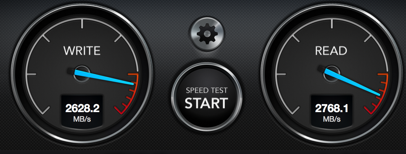

This is from the 1TB.

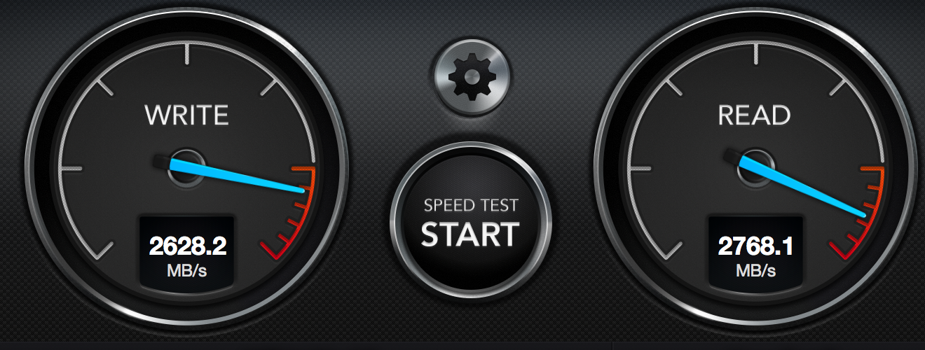

Not sure what you’re looking at.. both screen shots answer exactly what was asked. And they show exactly what one should expect from each drive
Edit: depending on the sample size you choose when doing a speed test, it will change the results. But In the end the larger drives are faster for each size.

on my 2018 Macbook Pro 13" 256GB ssd, I am only getting 1300-1400 on write, 2600 read using Black Magic
Thinking Apple updated the chips maybe on the SSDs since the 2018 perform much faster than this as seen in my post.
I just rebooted and ran it again and mostly got 2000 Write and 2000 Read.
What's the best way to get a clean test without some background process interfering? Is that even possible? I don't think my results are accurate because they vary wildly from one trial to the next.

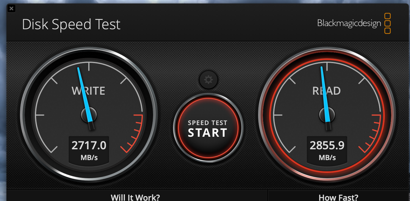

This is from a 2tb just to compare.

Why do you keep ignoring that everything below 2TB performs slower for each size?
and yes apple did upgrade chips. from super neat Samsung chips to coil-whining Toshiba chips.
