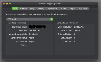

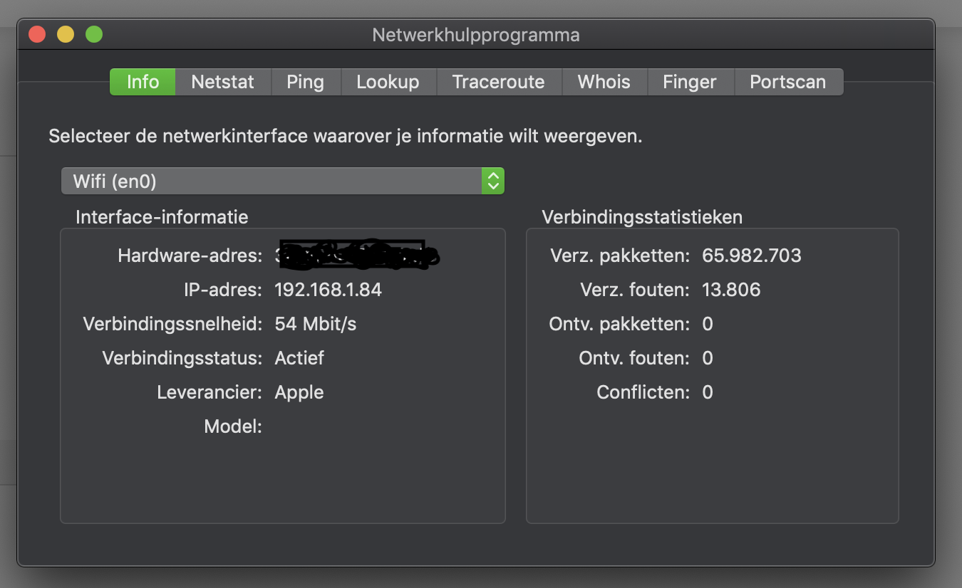

I having this problem too on om my MBP 2018. This is my second new from the box.
I have a ticket open with apple. I also see problem as shown in the screenshot.
  • low speeds 54mb/s (but sometimes as high as 405mb/s although my routers permit 300mb/s)
  • NO model info on the network card (empty)
  • errors on the transmitting packets
  • NO receiving packets are reported !!
And now the MBP2018 starts losing connection with wifi. I got an replacement MBP2018 from apple new from the box... same issues.
I have also a MBP 2017 which has none of these problems on my network what so ever.
