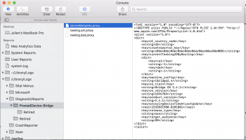

Hoe does the log look like, specifically?
I have 3 files: deviceMetadata.proxy, tasking.ca1.proxy, tasking.da3.proxy
Does that mean I am concerned by these?

These are the logs in the path you mentioned. Not sure if it is related or not to your crashes or if they refer to the 2 crashes I had since I bought my Mac 10 days ago.

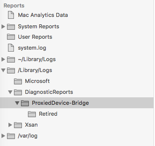

Do you have a "ProxidedDevice-Bridge" folder you're looking in?
I do, I guess. You confirm I am impacted by the same bug as you?
Nope, that's something different. The one we're talking about here will have this line at the top of the window on the far right: {"caused_by":"macos","macos_system_state":"running","bug_type":"210","os_version":"Bridge OS 2.4.1 (15P6703)"
