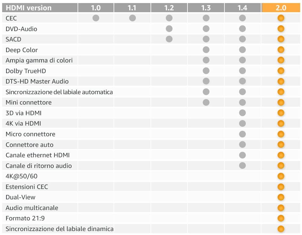

Thank you very much. Thought it was a 60Hz capable one due to the description below (italian version):
  • Compatibile con lo standard HDMI (formato video 4K a 60 Hz, 2160p, 48 bit/px di profondità di colore); supporta una larghezza di banda fino a 18 Gb/s ed è retro-compatibile con le versioni precedenti
And the table provided:
You cannot rely on manufacturers' statements. Make sure it is a certified cable. The first HDMI 2.1 cables certified for 48 Gbps have started appearing. This is overkill for your needs, but they are not that expensive and you know they have passed the most rigid certification tests. The key thing to look for is the "ultra certified cable" logo and hologram on the box. Then scan with the Ultra HDMI certification app which will verify that the cable is certified.

Yes, a non-certified cable is a hit or a miss. Buy at least a Premium High Speed cable:
