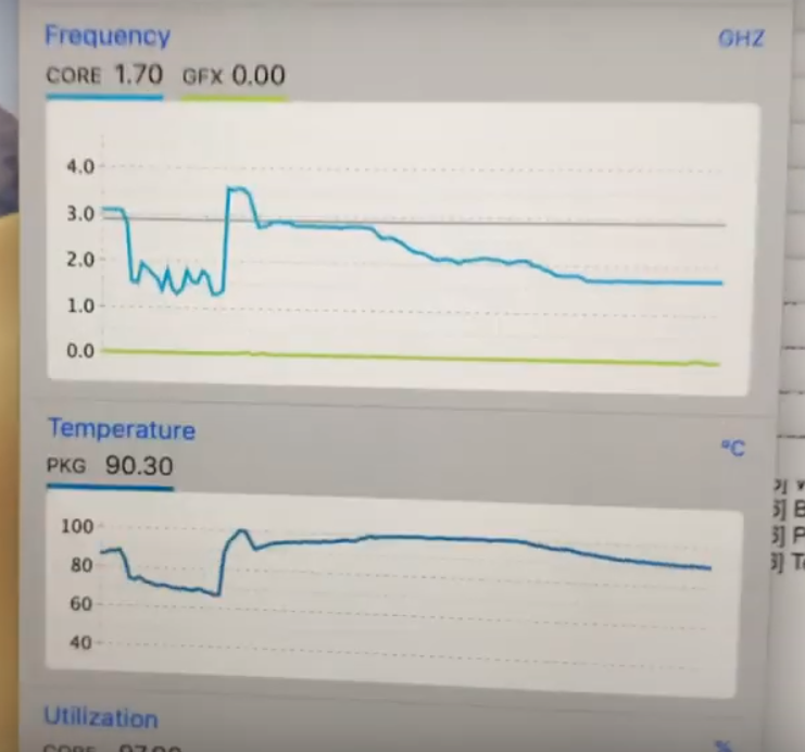

I think this is a good place to discuss these thermal numbers. Running Heaven's benchmark as well as driving the CPU to 100% will stress the cooling to see if it functions as well as test the efficiency of the CPU. I'm seeing more & more posts where people don't think this is important, but it actually is on your pocketbook. Why?
Given the same GPU, the i7 & i9 can either perform the same or different in this scenario. Granted, CPUs do vary, but not by much at all. If we see a significant difference in the downclock, then you'd want to go for the higher clock. My experience says that the i7 should win out in max performance...ususally because less voltage is being pumped in due to lower cache, cores & hyperthreading. This tells you which will perform better under max load. This is also only practical if you don't replace your MacBook every couple years. I manage to stretch my machines about 11 years & they run 100% CPU & 100% GPU by the time I'm hitting year 6.
This is also the first design that I suspect the i9 may have been more efficiently designed to handle the higher frequency. Usually, the ix series denotes the number of cores & the configuration in hyper threading. That is not true in this case. It simply denotes higher frequency & difference is cache. We will find out.
Another thing brought up: both the CPU & GPU will thermal limit. That's actually not the case. Thermal control is something CPU controlled. Out of every test I have done in the past on GPUs, they don't thermal limit & if they hit their limit, they either fry, but more likely just fail until they cool. GPU Overclockers are familiar with this. Plus, we are talking the same GPU model so the difference in performance will lie with the CPU which rests on the same heatsink. You can't do a comparison using the i7 & Vega 16 vs i9 & Vega 20...there's no common variable we can use.
1.8 on the frequency across multiple cores isn't bad. Single core performance will suffer, though...& that shouldn't matter for the most part as we will likely be single tasking high performance, unlike what this test demands.

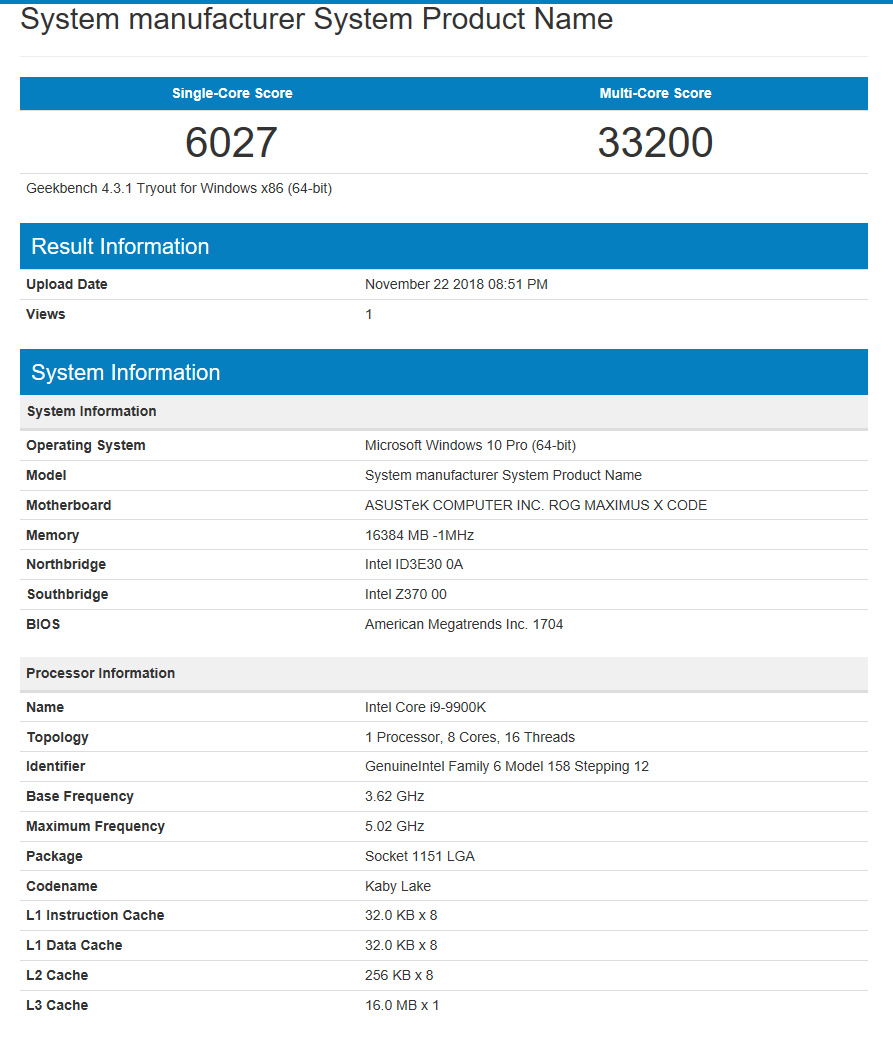

It honestly isn't too bad. I did a geekbench on my built i9-9900k, and its not much more than that.

As I've written in the other thread, this is under a stress test, an unrealistic scenario that is designed to test the limits of the cooling and power system. The MBP is a thin and light laptop and is not designed to be operated under such circumstances. And in fact, this is a good result, since it throttles less than some other laptops in the same category (for example, Dell XPS throttles down to 1.5Ghz, Razer Blade to 1.7Ghz and Asus Zenbook Pro to a whopping 1.3Ghz).
Most importantly, you will probably never experience this kind of throttling in a practical situation, unless you try playing games while transcoding a bunch of 4K videos or do something similarly silly. This is a stress test, designed to push the machine to an unreasonable limit. Its like testing a car by loading it up to the safely limit, chaining it to a tree and then pushing the throttle as hard as you can trying to get it up a gravel road up a hill.
The only purpose of this test is testing the limits, and its doing exactly what its supposed to do — clocking down to prevent damage. If you want a machine that can do better — start looking at large and heavy gaming and workstation laptops.

Because Coffee Lake is clocked so weirdly compared to previous generations and it seems that it lacks a frequency limited for multicore operation, all of these CPUs should reach similar clocks in multi-core sustained operation. This was not the case with previous CPUs simply because Intel has placed a clock limit that stopped the CPU from getting higher. So yes, if what you do for living is encode videos or do raytracing on the CPU, the i9 is not worth it.
Where i9 is better though is burst performance, since its max turbo is higher.
Thermal control on CPU and GPU works very similarly. Macs are a bit special in this regard anyway, since they have dedicated hardware that monitors all this stuff and controls power levels. Its simply that the management system priorities the GPU before the CPU. The assumption is as follows: if you are actively using the GPU, than that is probably the more critical component for the user experience. In most games for example, you won't notice if the CPU frequency goes down a bit, but throttling the GPU will have a clear noticeable effect.
Single core performance won't suffer much, simply because less cores are active. In the above video, the stress test sees CPU maintaining 28 Watts while running on 1.7-1.8Ghz all 6 cores. In another words, the combined sustained TDP for CPU and GPU is around 65 watts, which makes perfect sense for the 85 watt power adapter. These 28 watts though are more then sufficient to keep two CPU cores at above 4Ghz. I can't give you exact figures, since I've sold my i9 and currently waiting for the new model with Vega :)

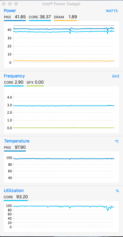

I used handbrake on my new i9 MBP, and was pushing it pretty hard. It was getting around 2.8-2.9.
