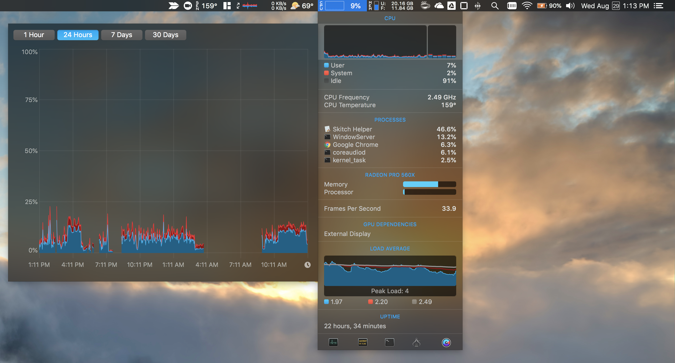

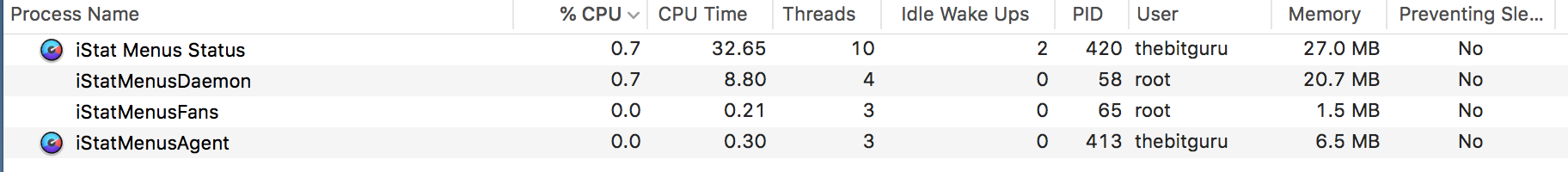

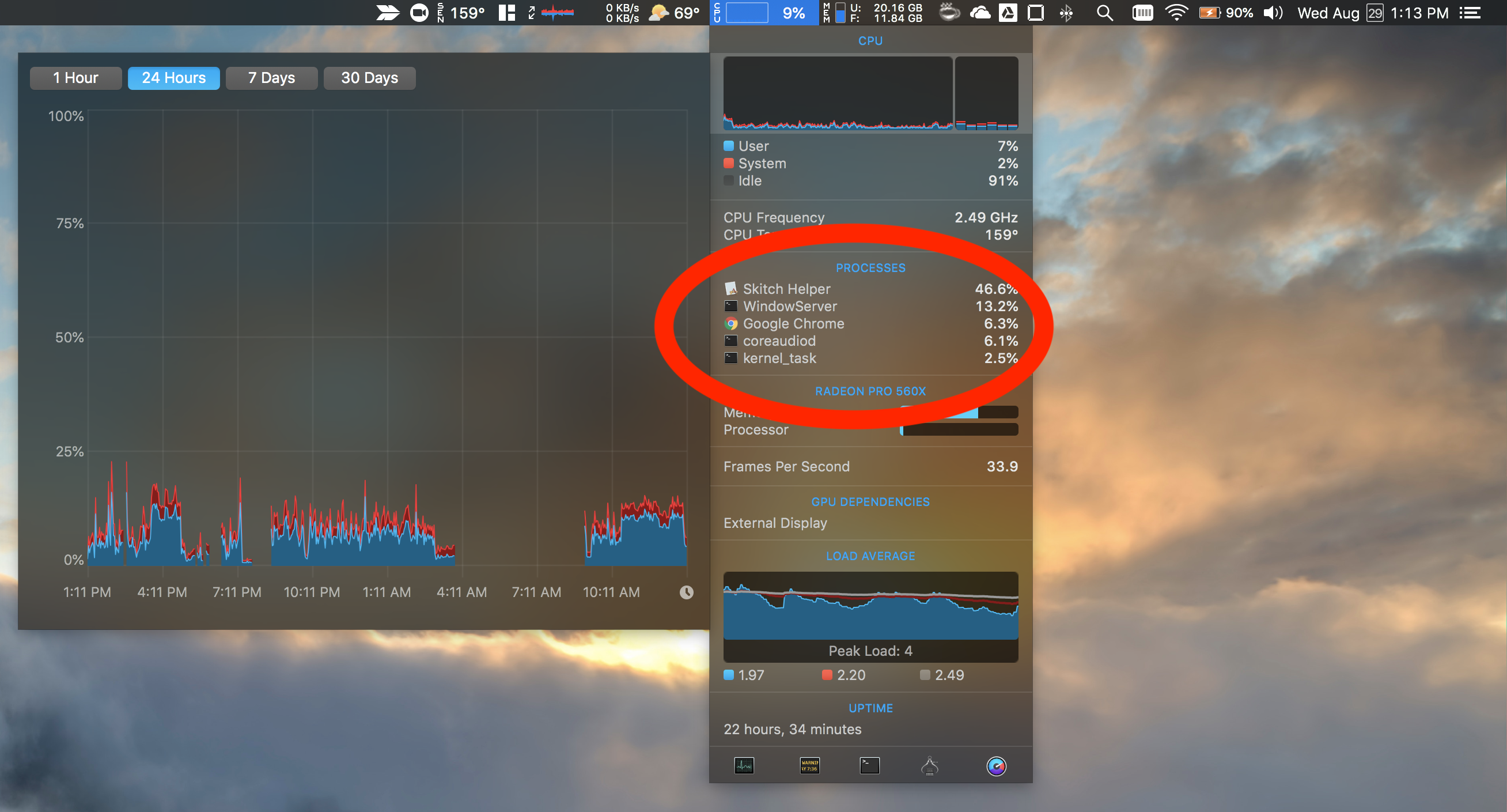

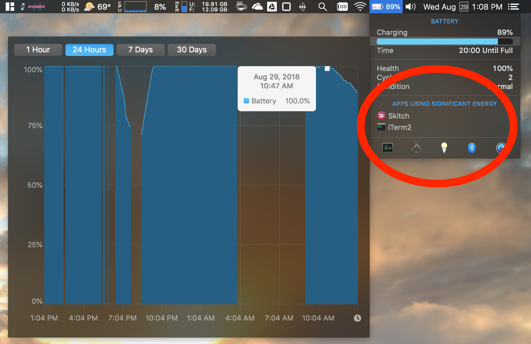

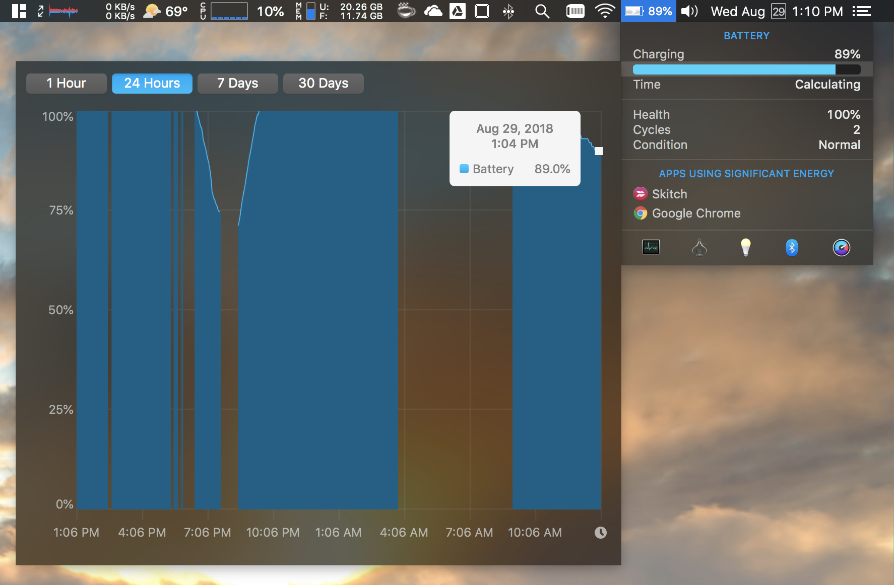

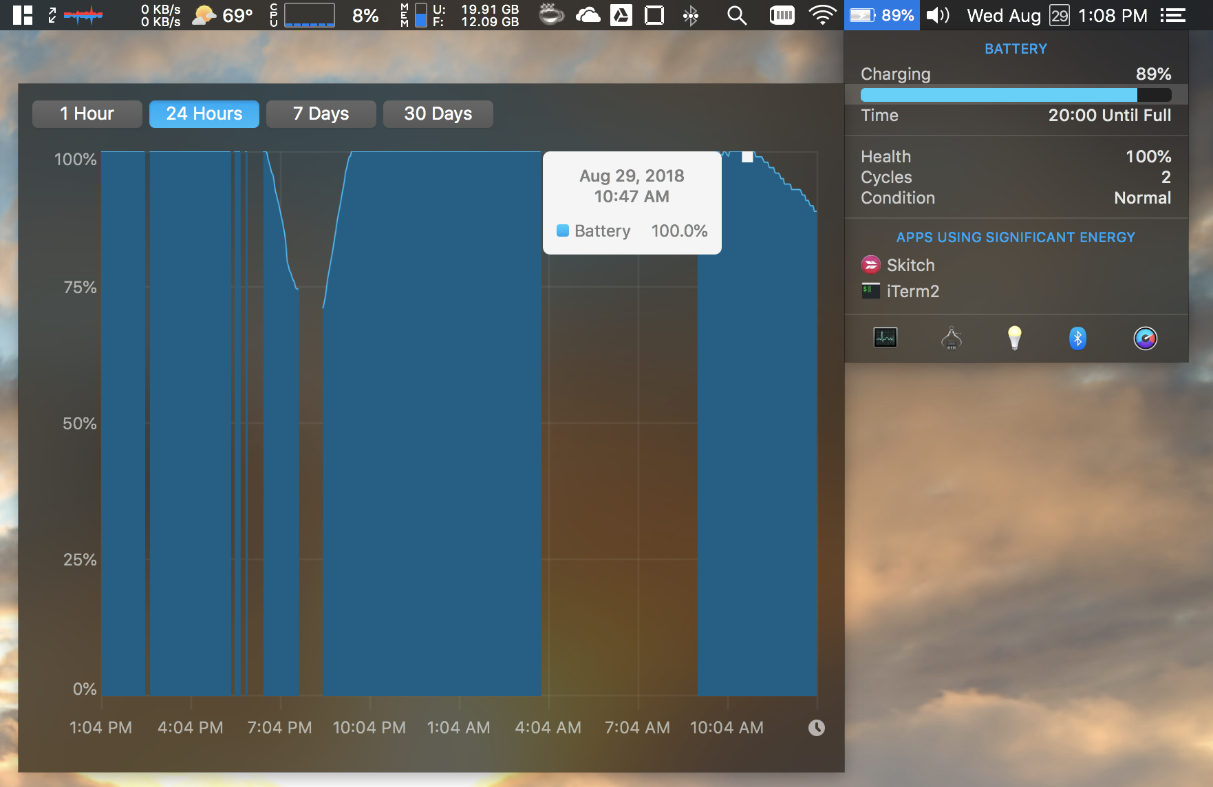

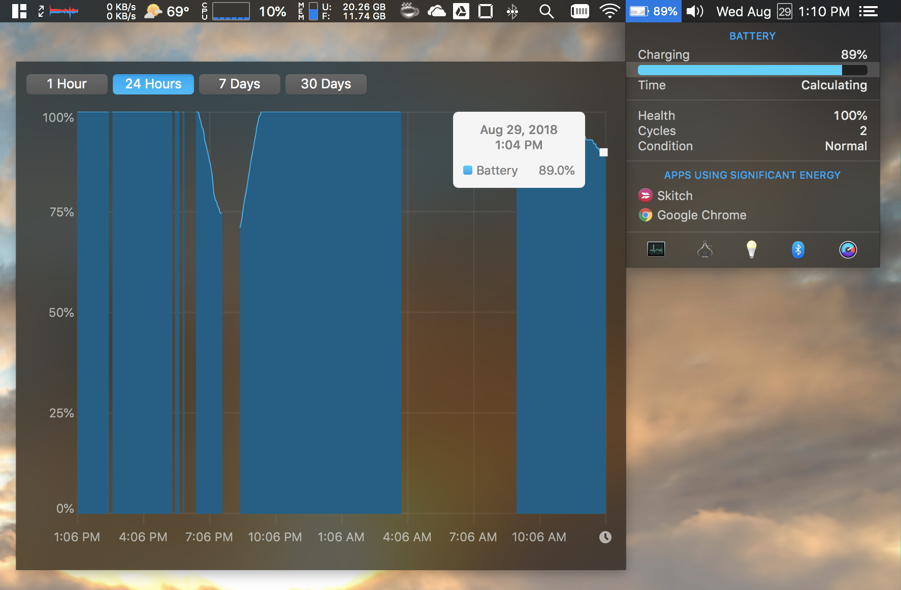

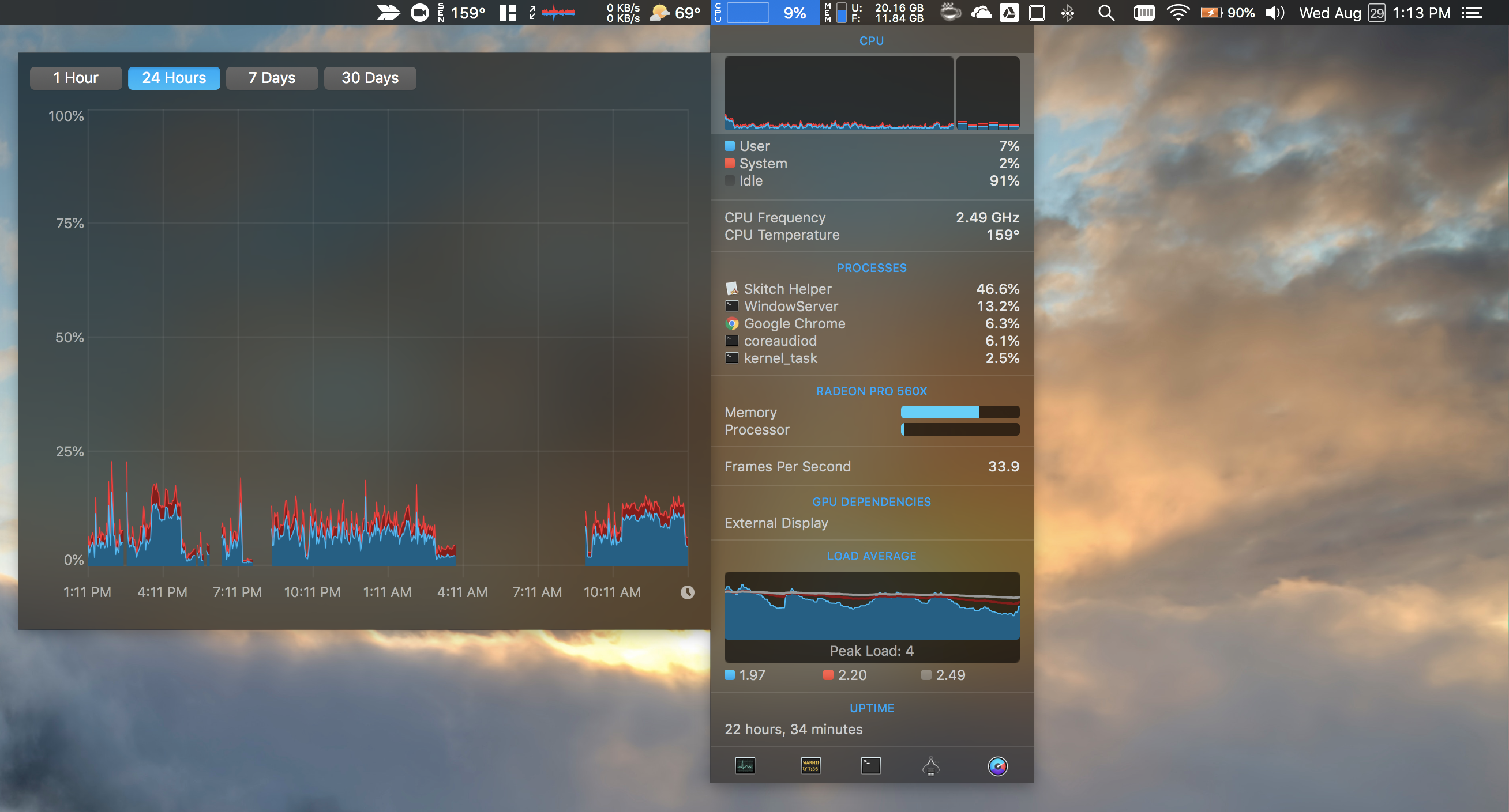

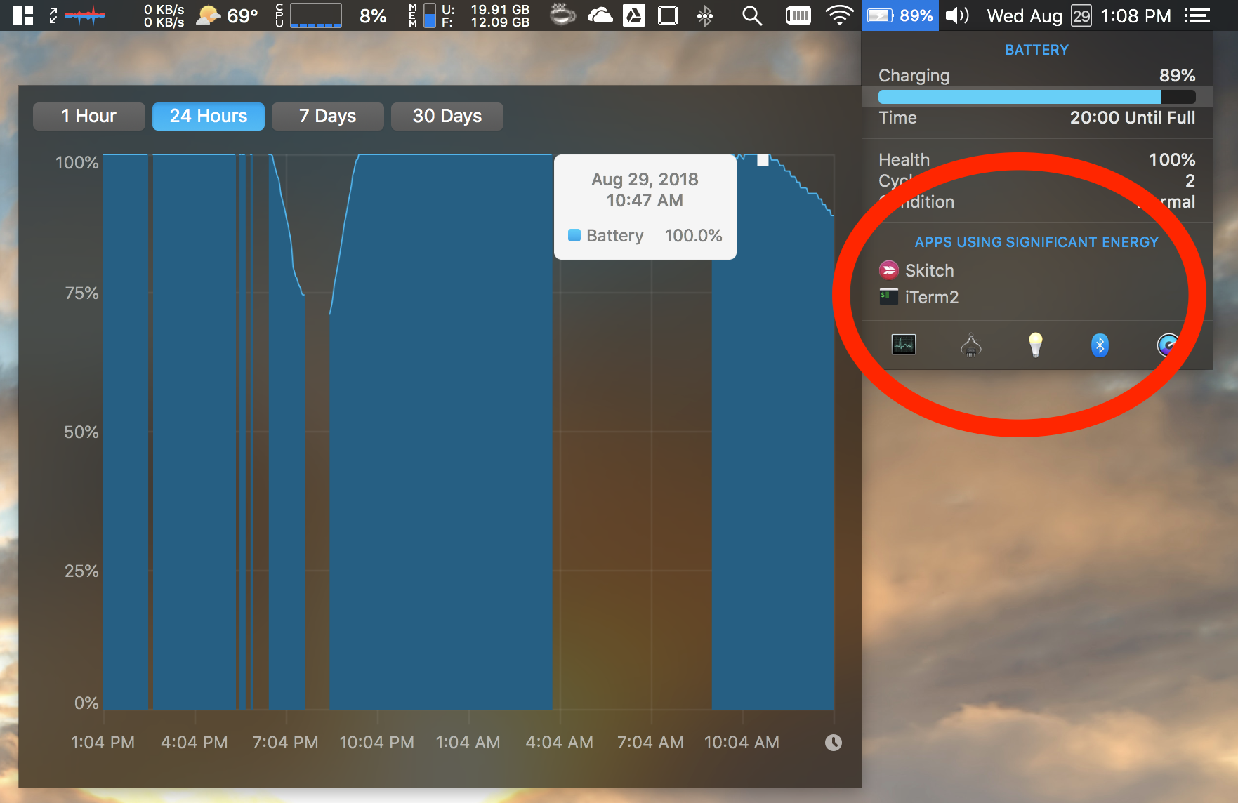

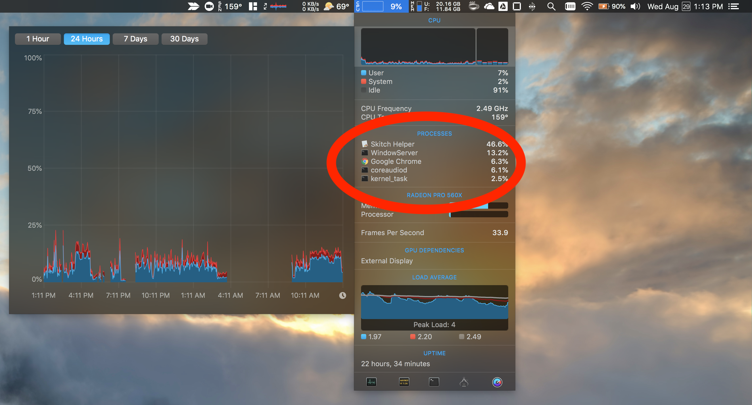

I am on a 2018 MBP with i9/32GB/1TB that I got a few days ago. I was on a video call (camera, screen share, and MBP speakers) for around two hours today. I started with 100% battery and ended up with 89% even though the MBP was plugged in all this time. CPU usage wasn't significant during this time, but even if it was, battery drain still doesn't make sense. I haven't noticed this in the past few days, and I did upgrade to the Supplemental Upgrade 2 that was release yesterday. Below are a few pictures of the iStat Menus graphs for some more data.
I haven't had a chance to try a heavy workload since then so I will try that once I get some time.
Has anyone else experienced this? Any thoughts on what might be going on here? Am I really somehow taxing this thing more than what it was designed for?

I wouldn't worry about it in the least. My recommendation is to get rid of all that menu bar system monitoring stuff and just use the machine. Your job isn't to monitor hardware. In fact, maybe it's all that crap you've got running that taxes the machine! Have you ever seen how much CPU activity monitor uses?
The iStat Menus widgets are quite helpful and they are not that taxing on the CPU/memory.
Also, the sleep problem existed on my 2016 MBP when I wasn't using iStat Menus so I am pretty sure that isn't the cause.
I used Skitch to create and markup the screenshots when posting here. It wasn't running during the battery drain.
One question: even at 100% CPU, memory, GPU, and disk usage, should the battery ever go down when plugged in?
Probably. If the power adapter is built to handle the absolute maximum load, it will be bigger and heavier. Why do that when you have a charge accumulator (i.e., battery) already built into the product. Under load it makes sense to use the battery as a power supplement.

Isn't it an 87W PSU? So yeah, it would certainly drain under max loads. It's 45W at base clock for the CPU alone, but if you're bursting and running accessories too, I imagine it's not difficult to max out that 87W.

I think you're falsely extrapolating data points.
You asked if it would drain under max loads. Yes it will. Just like the 2016.
It shouldn't drain under low loads. I think you're misinterpreting what your system is doing (it's working way harder than you think) or you have some other software that is draining the battery. You also muddied the water by throwing in sleep.
You need to consider whether you have several separate issues.
Draining under heavy load - normal.
Draining while sleeping while not plugged in - normal, to some degree.
Draining while sleeping while plugged in - not normal, perhaps there is a task that is keeping it awake and it's actually not sleeping?

@thebitguru Coffee Lake is extremely power hungry, and can use up to 90W for an i9 or 75W for the i7-8750H. Apple has designed themselves into a corner with their current MBPs and thus, it looks like they can't supply them with enough power under load. Unfortunately this is not good for the longevity of your battery, even if performance isn't affected.
Since it sounds like your machine has some problems anyway, I would return it for a base i7-8750H which will perform nearly the same and use much less power.
FYI, I ended up keeping the i9 model and, fortunately, whatever the problem was I have not hit it again. My guess is that they have improved the throttling to prevent this issue.

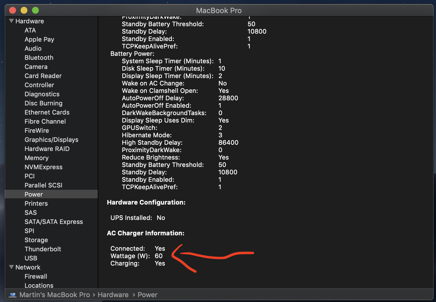

hi, can anyone of you guys confirm the 87watt power supply is correctly registered as such? mine is registered as per 60 wattage (system report --> power), which is odd. i do my 3d renderings on the machine, on the go, and the battery constantly just drains, which is annoying.

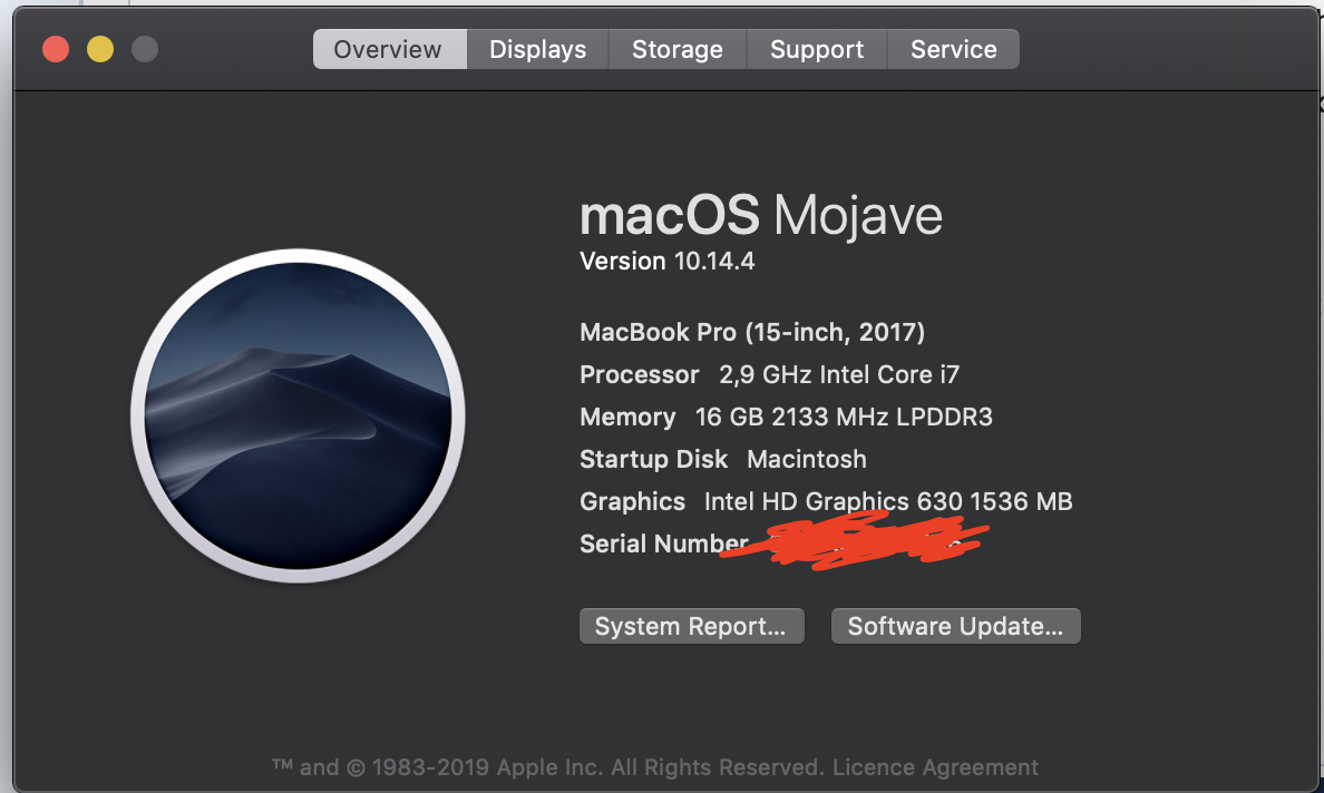

Look at my screenshot. I am using this charger of AliExpress: http://s.click.aliexpress.com/e/cOWr7BLE
My MacBook Pro 2017 higher version is in a screenshot as well.
I thought I'm having this problem as this charger might not supply the full 87W as the original charger. But now I see we are all having the same problem! I'm mad at Apple for this terrible mistake.
ari_ra, which charger are you using? The Apple's original 87W that came with it?
