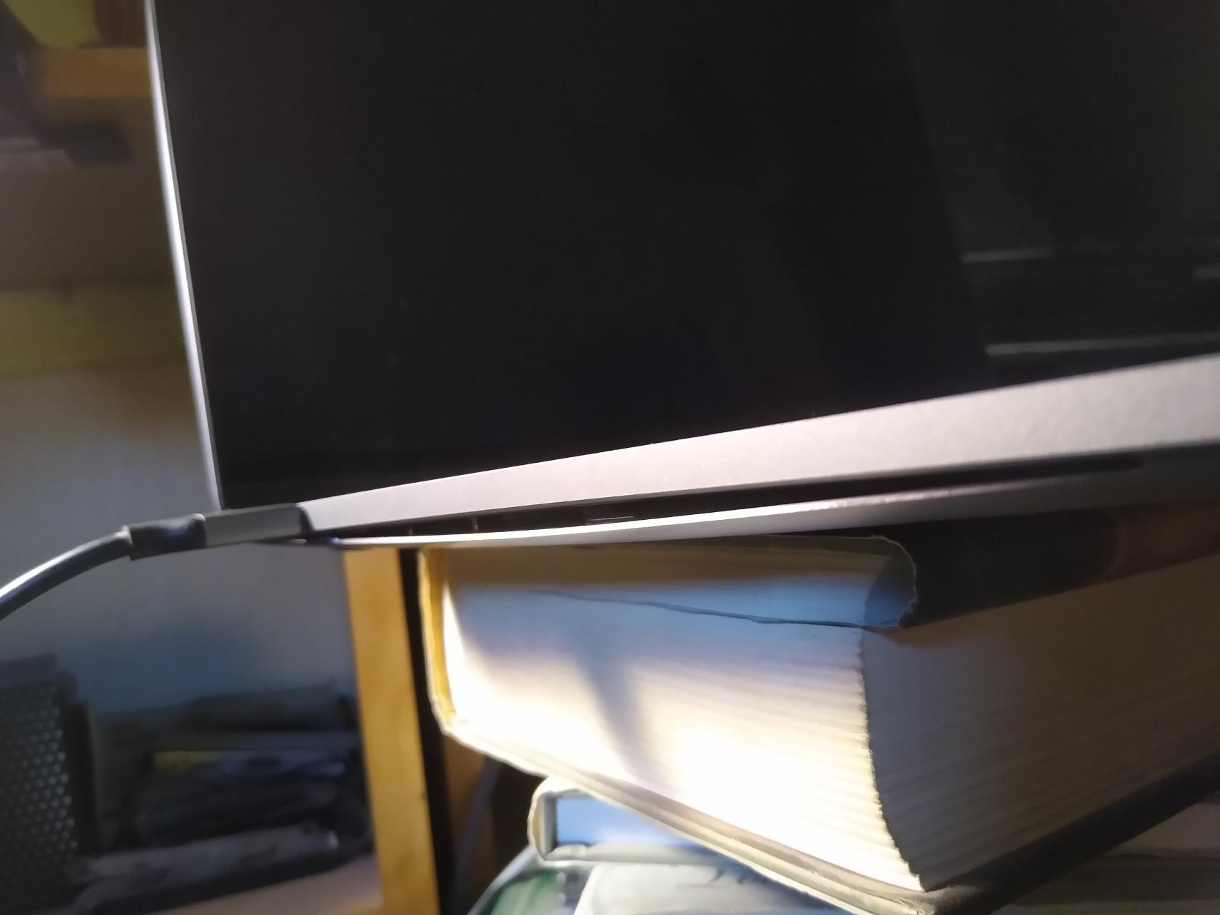

I just noticed that my 15" MBP 2018 has become bloated, and its shell is popping open from the bottom. In addition, it won't close all the way anymore. Photo attached.
I have not dropped it or banged it on anything. It's done nothing but sit on my desk for months.
What should I do? Can the bloating be stopped? Is my laptop in danger? How can I help it, and what might the price look like?

Varies. I haven't had good luck with Apple support, but others on here have had different experiences. If it's out of warranty, depot (flat rate) repair is commonly offered. Last time I used that, it was $350 to fix everything. Your results may vary. Some people have reported not paying for similar things.
Your battery is toast. You do have a danger if the battery is punctured or splits open; lithium ion batteries + air = nifty fires.
The other danger here is the swelling is potentially causing damage to the logic board, the keyboard, etc. You mention the laptop will not close; that is because the keyboard is pressing upwards, preventing the display from closing. You really need to contact Apple or an authorized service provider ASAP. Alternatively, iFixit has a guide up, but they do not list the battery for sale.
  1. Get it serviced / repaired
  2. Yes, the battery needs to be replaced
  3. Yes, a battery in that condition is potentially dangerous. If it shorts/splits/etc. it will potentially catch fire and be difficult to extinguish. You'll have a Samsung Note type situation on your hands, except your MacBook Pro battery is much bigger with more material to burn.

Apple will replace your battery for $199.
As you have some damage to the case, it may cost more --- but, be sure to ask Apple if the swelling battery makes a difference. Sometimes Apple covers replacement, even if you are out of warranty.
Stop using your MBPro until your get your battery replaced. It can be a safety issue, eh?

It depends on what went wrong in the first place. Normally, when you shut off and the battery cools down, swelling should reduce. Please switch it off and keep it in an adequately ventilated area where it is clearly visible as well until you can take it for assistance.
The cable connected to the computer, that is not a standard cable. Is that cable a cable you are using to charge the computer or just for other purposes?

Hard to say, but I would avoid powering it up again if possible. If your data isn't sufficiently backed up, you may want to mention that. I wouldn't personally run a machine with a battery that swollen. I have encountered the same issue, but in my case it just messed with the trackpad. It never got to this point.

The swelling battery is a FIRE HAZARD. It could even explode.
You want to get that changed out as quickly as possible.
If Apple Stores are closed where you are, they'll ship you a box in which to return it (postage free to you).
For a 2018, they may offer to replace it free of charge.
Even if they don't, the replacement fee (parts and labor) is $199 (US).
That's worth the money. You don't want to keep using it like that.
Call Apple support right away, if you haven't already done that.
