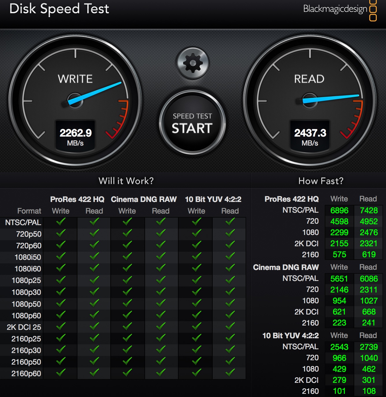

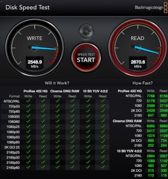

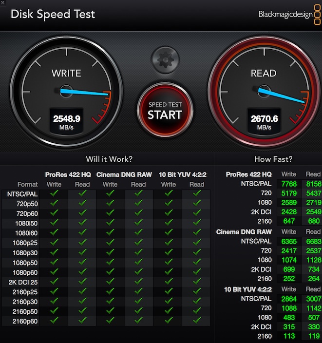

Setting aside all the 'up-to' SSD speeds claimed for the 2018 MBP I was wondering what people are getting on an in-use MBP once part-filled and if the quicker CPUs make a difference. A colleague of mine is getting the same SSD speeds on his 512GB i9 that I am getting on my base 13" i5 with the same size of SSD. We are both running FileVault but with T2 I don't think this should impact benchmarks.
My 13" i5 16GB RAM, 512GB SSD (1846MB/s Write, 2530MB/s Read):
Clearly just a curiosity as the SSDs are quick in any guise.
