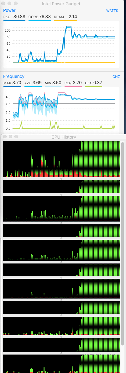

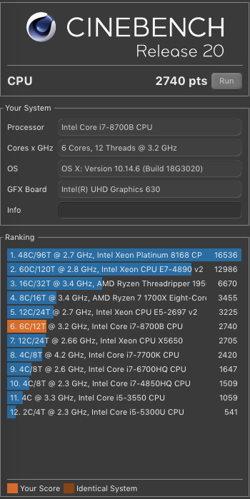

FWIW I downloaded Cinebench R20 and ran the test on my 2018 i7 Mini w/ 32GB of Crucial 32GB DDR4 2666 MHz SODIMM Memory Module Kit (2 x 16GB). It ranked 6th scoring 2740 pts.

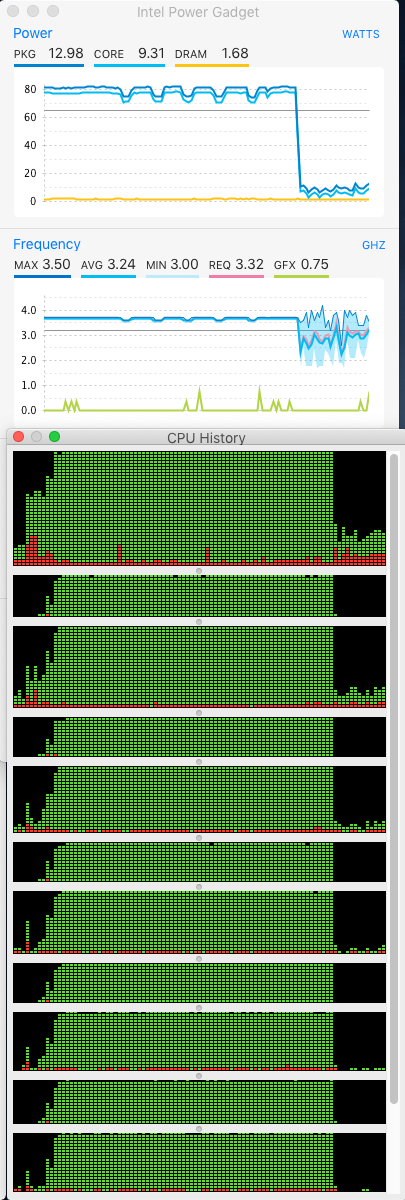

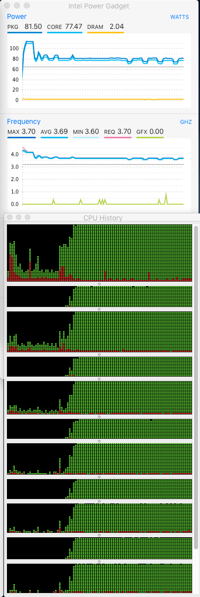

I have included a few screen dumps of Intel Power Gadget and Activity Monitor’s CPU History taken during the Cinebench test. Note: the time scales of the Intel Power Gadget and CPU History graphs are close but not the same.

For reference: Cinebench 2695 and Geekbench 5401 for my '18 32GB with OEM RAM.
If it's significant, that's running while in full production/operational mode, i.e., a WIn10 VM running MS-SQL, VS, IIS, and MacOS running (the VM itself) and Mail, Postman, Sketch, Notes, iTunes, Chrome (20-25 tabs), Messages, several services.
