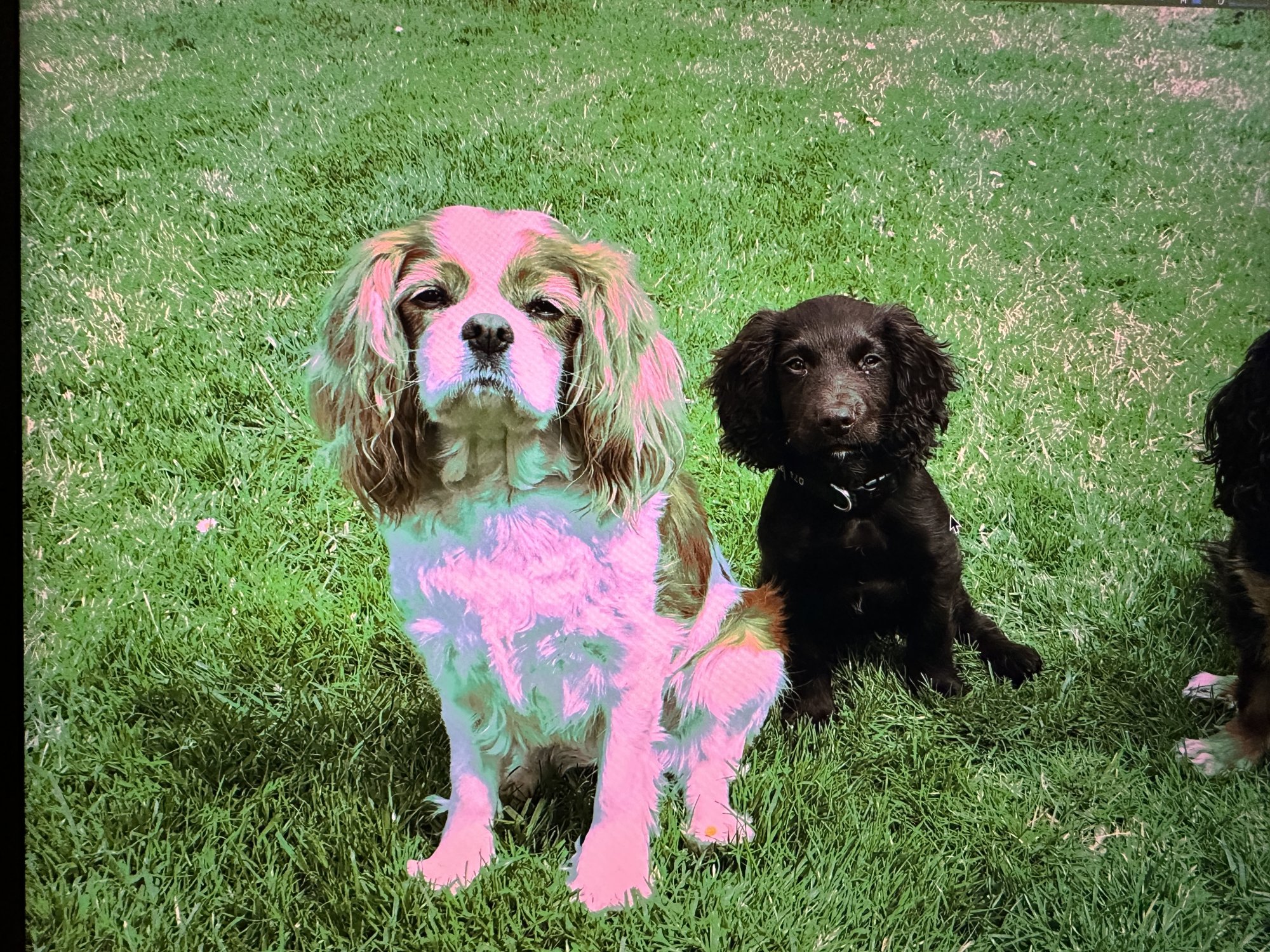

I turned my MacBook on yesterday to find the colours all messed up. I am thinking hardware related,
This is a photo of what it looks like

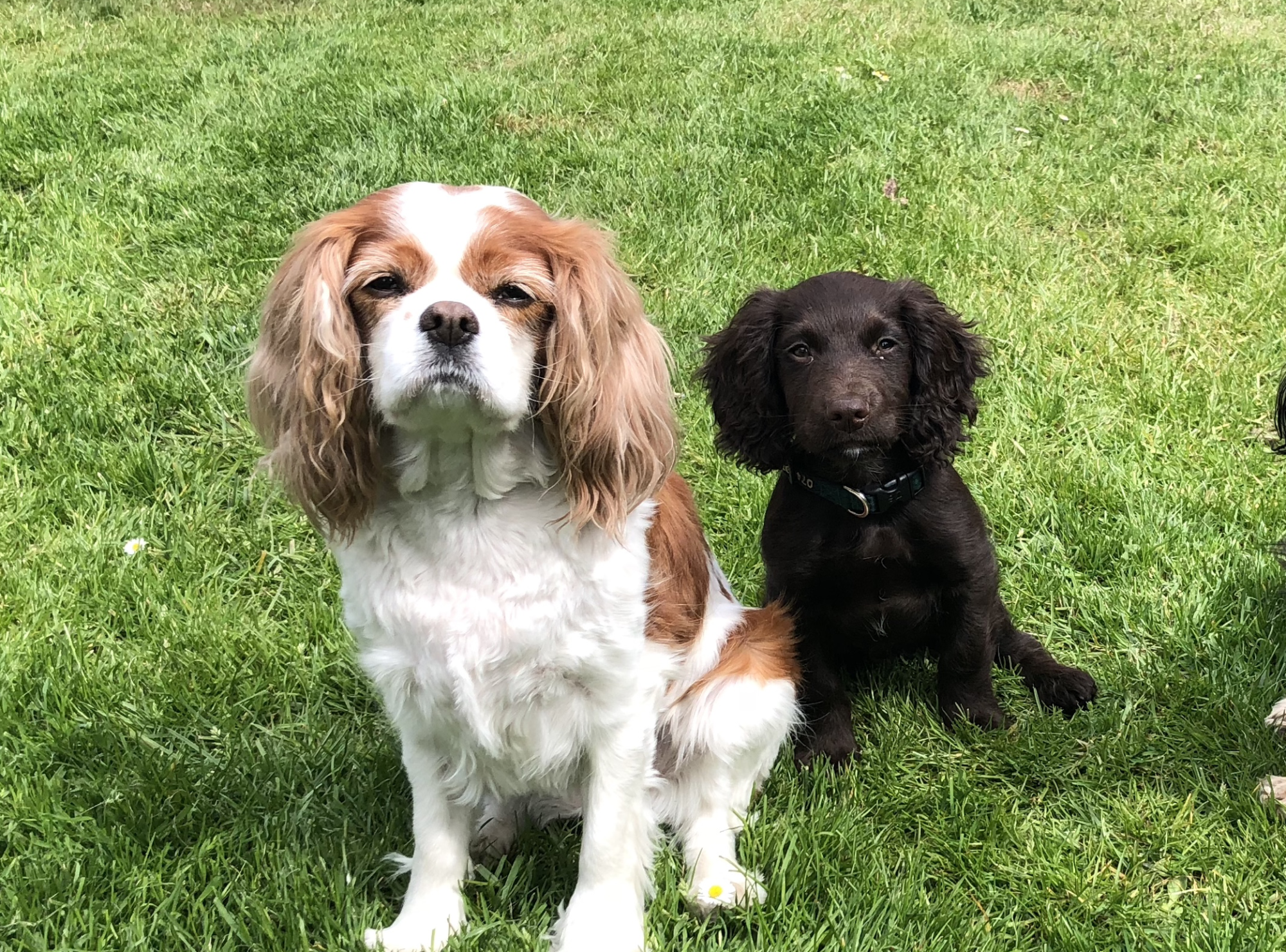

And this is a screen cap of east it’s supposed to look like
Maybe a loose connection? It’s not had any water damage but it’s a 4 year old machine so has had a few bumps.
Has anyone see man this before?
That would be a typical MacBook issue known as „Flexgate“.
yup, i've found loads of info about it. Its definitely that, it's fine when the screen is at 45 degrees, open it more and it go wrong. Luckily I bought it through work and the supplier gave a 4 year warranty which runs out in April. So it's going in for repair.
