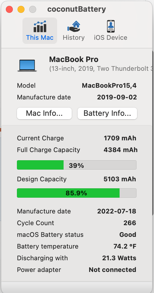

My cycle count was high enough to have the battery replaced in Nov 2022. Cost for replacing had gone up since last time I had to do it, so the $200+ seems to have been a little in vain as the battery life 8 months later is worse than when the original battery was installed. Has anyone else had this issue? Seems I'd get at least the 3 years out of a new battery that I got out of the original. Very disappointed. I'd love to hear there's a recall or other way to remedy this.
What kind of info does Coconut Battery give you?
Post a screenshot of the results.

Few points.
85% is low, but within Apple limits (80+%). They will consider this battery in working order and will not accept this as defective. Batteries usually stabilize at some level and live relatively long life there.
What is baffling is your battery use. You have used this battery for 8 months (~240 days) and have 266 cycles? That is more than one full charge-discharge cycle per day. And as ignatius345 noted, 21W discharge is significant for 13inch MBP. May be your use is loading the battery beyond Apple expectations and that is why batteries do not live under your use long enough.
If you need to use device so heavily on battery, I can recommend replacing this one with Mx MBP (if possible and yes, it is not cheap solution). Battery life of M1/M2 MBPs is much better and it is very likely battery will perform lot longer to your expectations.
Reactions: ignatius345
As a troubleshooting step I'd suggest maybe making a brand new "vanilla" user account and logging into it.
- Go to System Preferences > Users & Groups > create a new user account.
- Restart and log into ONLY that account. Don't bother tying it to an Apple ID, just log in and start playing around in it and see how your battery looks in CoconutBattery (particularly the power draw). If it's normal, you probably have something in your main user account that's loading up and causing problems.
