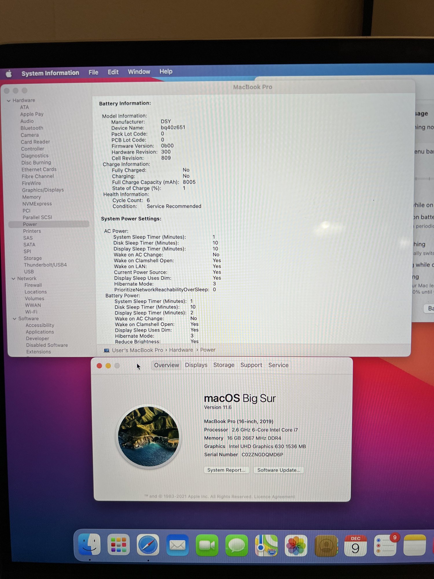

Have a 2019 macbook pro 16" that I bought to sell. Battery was working fine when I tested it before sending it out to an international customer. Customer received the mbp and said that the battery doesn't charge. I've received it back and have tried to replace the flex cable of the battery and that has not fixed the issue. I've done an smc and pram reset etc too. Here's a screenshot of the battery info

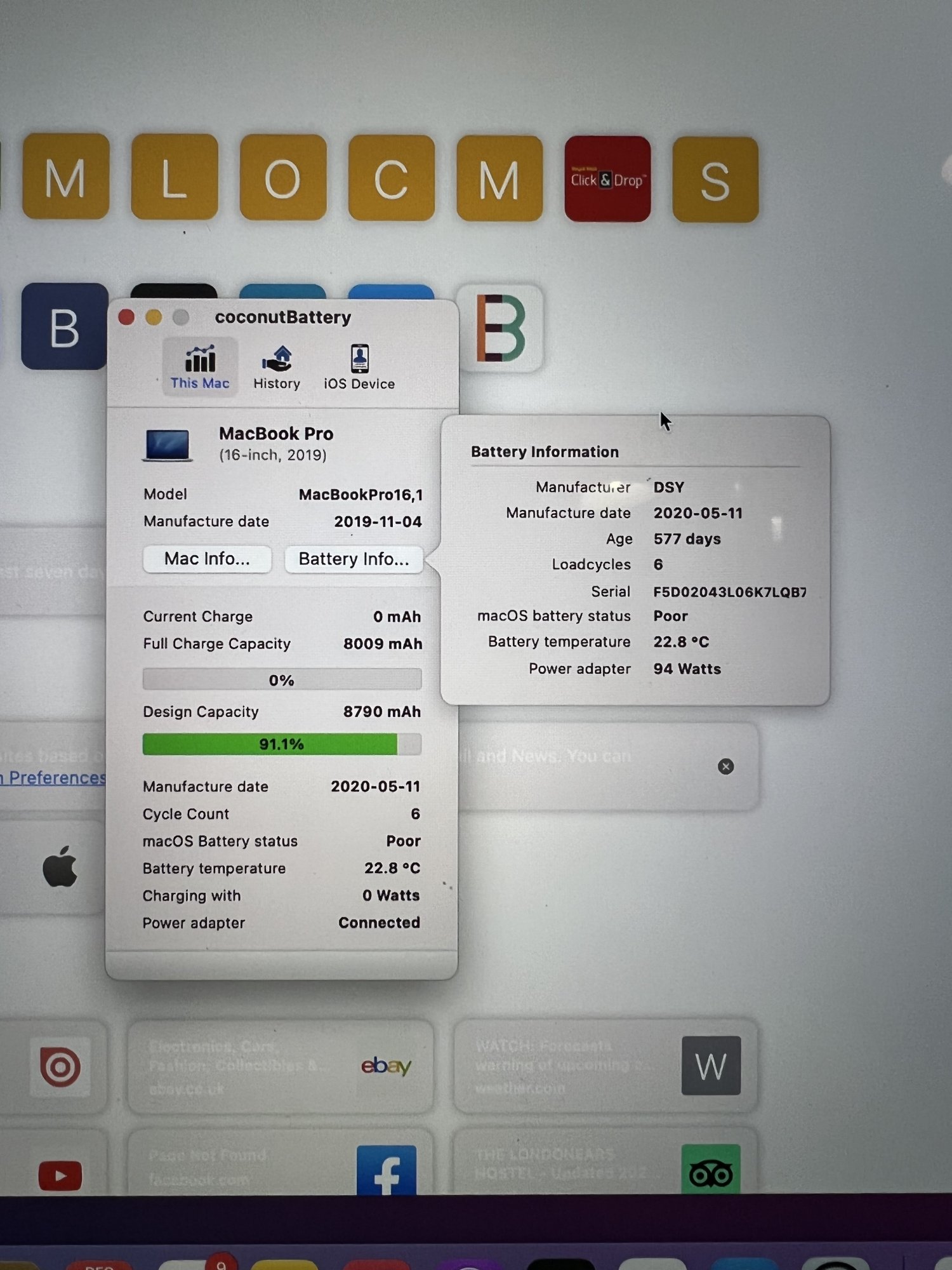

I read the design capacity for that battery was 8790mAh, so this might have been plugged in all the time (I'm supposing you bought it used), in which case the battery cycles wouldn't reflect the condition of the battery. Don't know what might be the problem, though.

I've added a coconut battery image to the OP

OP, 2 things that come to mind potentially:
1) As @Sanpete mentioned, did you have this plugged in for most / all of the time before you sold it? There's quite a lot of anecdotal evidence that 2016 and later MBPs (both 13" and 15/16") when plugged in all the time would frequently experience battery degradation / expansion / health issues, that were very divergent from what we typically though of in terms of cycle counts. So battery health would be much lower than what you'd expect from a low cycle count (given battery not being used much from being plugged in)
2) How did you ship it internationally? I think anything with batteries like laptops / phones, have to be sent via carriers that use pressurized planes. Otherwise, I think there's a risk of explosion and I think also potential for batteries to get damaged (eg. from extreme cold temperatures, etc.) Maybe a combination of (1) and (2) led to premature battery death?
Either way, because MacOS showing poor battery health, you should be able to get the battery replaced for the US$199 cost (which comes with a new topcase / keyboard / trackpad / speakers). If it's still within 1st year since you bought it, (or you have AppleCare+) it would be a free replacement.
