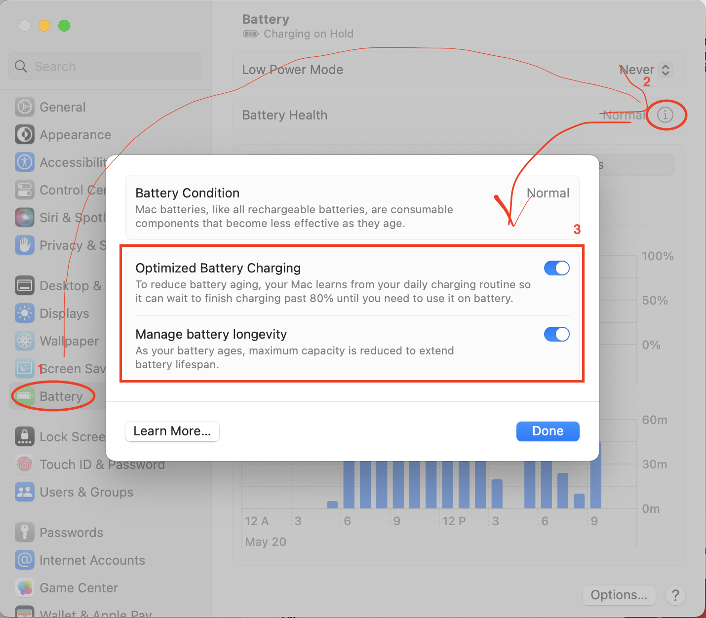

What version of Macos?
Do you have the Battery Health Management features enabled;
- Optimized Battery Charging
- Manage batter longevity
If you are on latest MacOS Ventura (13.3) you can check if the Battery Health Management features are enabled by opening Settings, go to Battery, then click on the (i) in the Battery Health section. See attached screen-shot.
When Battery Health Management features are enabled, charging can stop short (aka. pause) of full charge.
For example mine is currently plugged into the OEM charger, and the battery charge level is paused at 80%.
This is being done on purpose, to reduce the stresses associated with charging to 100% (in favor of extending the battery overall useful life).
When you notice this happening, what is the battery's current change level?
Monterey (12.6.3), I don't recall if the first time it happened I was Big Sur or not, in order to rule out the OS being the issue.
I do have Optimize Battery Charging checked.
I don't have Manage batter longevity checked.
Mac OS Battery Condition: Normal
