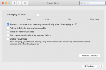

This has happened twice now, after a period of time that my iMac is in sleep mode. i go to wake it up by pressing any key on the keyboard or pressing the magic mouse but nothing happens and i have to physically press the power button once on the imac itself to wake it up from sleep at which point it wakes up right away, why is this happening and how do i fix it? It doesn't happen all the time but it happened twice now during the one week period of me owning this iMac.
The iMac's sleep settings are as seen in the screenshot attached

How is it normal though? Why would i need to PHYSICALLY press the power button of my iMac just to wake it from sleep? is there anything i can do in the Sleep Settings panel in the System Settings menu under energy saving to prevent this from happening?
FWIW on my system I have the top checkbox "Prevent from sleeping automatically....." unchecked, and I have no problems waking with the KB or mouse. Try that.

Ok, I just switched that setting off, What do you have "Turn Display Off after:" set to ? That setting is also responsible for automatically putting the mac to sleep, Correct? So if i have that set to 10 minutes, it means that after 10 minutes of inactivity the screen will turn off and the computer will enter sleep mode?
I have mine at 15 minutes. It turns the display off, but the Mac is on in the background, locks your session.

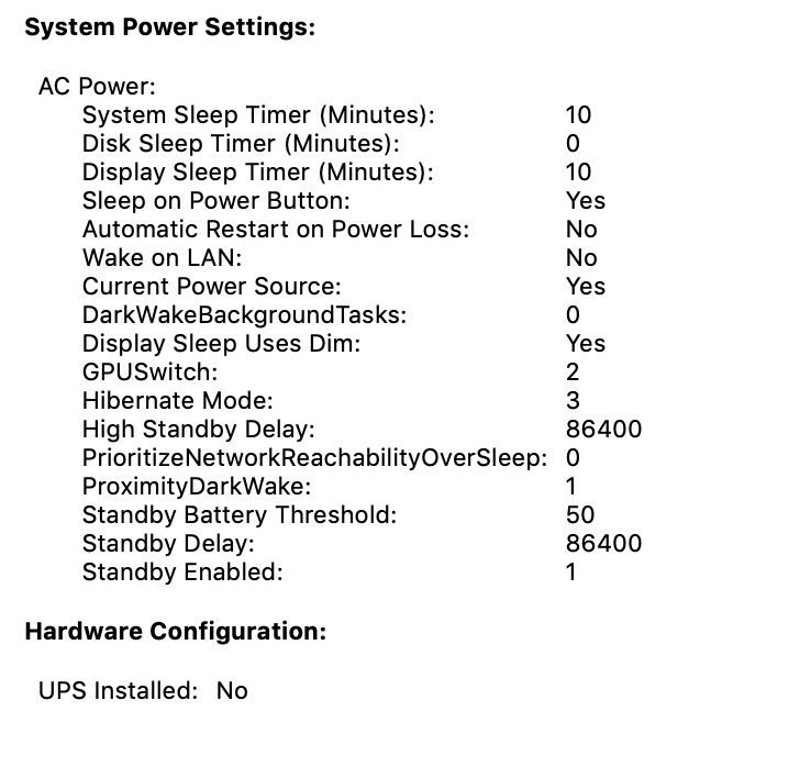

You can see the rest of your sleep and power settings in your System Information app/Power tab.
Note especially the number after "Hibernate mode". Normal should be 0 (and not usually 1,3, or 25)
If your bluetooth devices (or USB input devices) don't wake your new iMac, that's likely you have inadvertantly changed settings that take your system to a deeper hibernation mode. It takes you closer to full power off, but does come back up quite quickly with a short press of the power button. That's beyond normal sleep, to the actual hibernation mode, or (deeper yet) safe sleep mode. You will likely notice a short recovery out of that mode, as it loads your RAM information back into the system. It would show a washed out version of of the desktop, with an odd white recovery bar. A few seconds, and you are back up and running.

I just looked under the Power settings in system informations and it says "Hibernate Mode: 3", I only owned this 2019 iMac for a week. (See screenshot below)

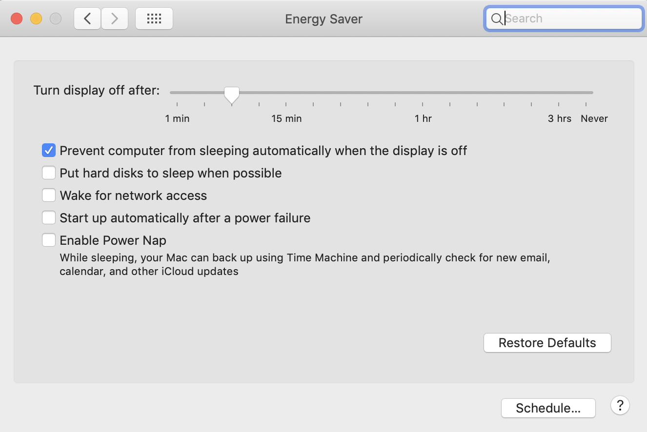

How so? My understanding is that the Display Off After "X" amount of minutes is also the very same setting that tells the iMac to go to sleep after the defined Minute count. How else would you configure your iMac to go to sleep after a certain amount of time?

The article that I posted tells you how to use the "pmset" command to change the hibernation mode. Simply replace the X, with 0, 1, or 25. I recommend 0(zero) for your purposes.
A desktop, such as your iMac, probably should be on zero by default. I have no idea how to tell you what might have changed that, but you can certainly change it back to zero.

Not experiencing this but I have Power Nap Enabled checked.
PowerNap was enabled by default on my 2019 iMac out of the box so perhaps with that setting left untouched (Enabled by Default) the iMac would never exhibit the deep sleep behavior I’m experiencing but then there’s also the fact that the iMac will never truly sleep if Power Nap is enabled as it keeps some processes running in the background I’m assuming as per the definition of PowerNap in the System Settings Menu (It lets the iMac check email etc while in sleep)
