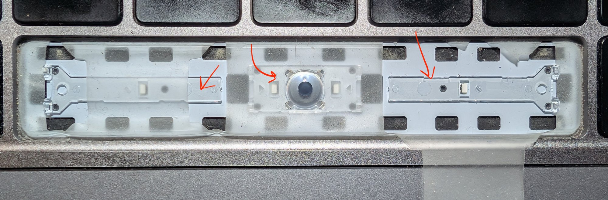

I've got a Macbook Pro from 2019 with the "beloved" butterfly keyboard and tried to remove the space bar key to clean it.
I watched few YT videos and yet failed to remove it as it's somehow blocked/held by some sort of membrane underneath?

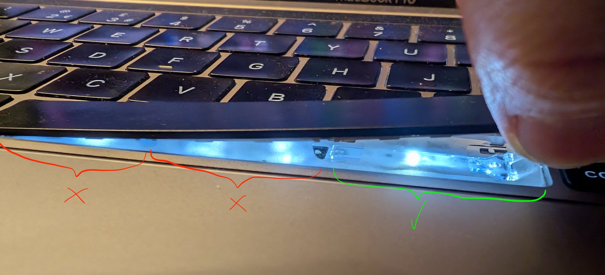

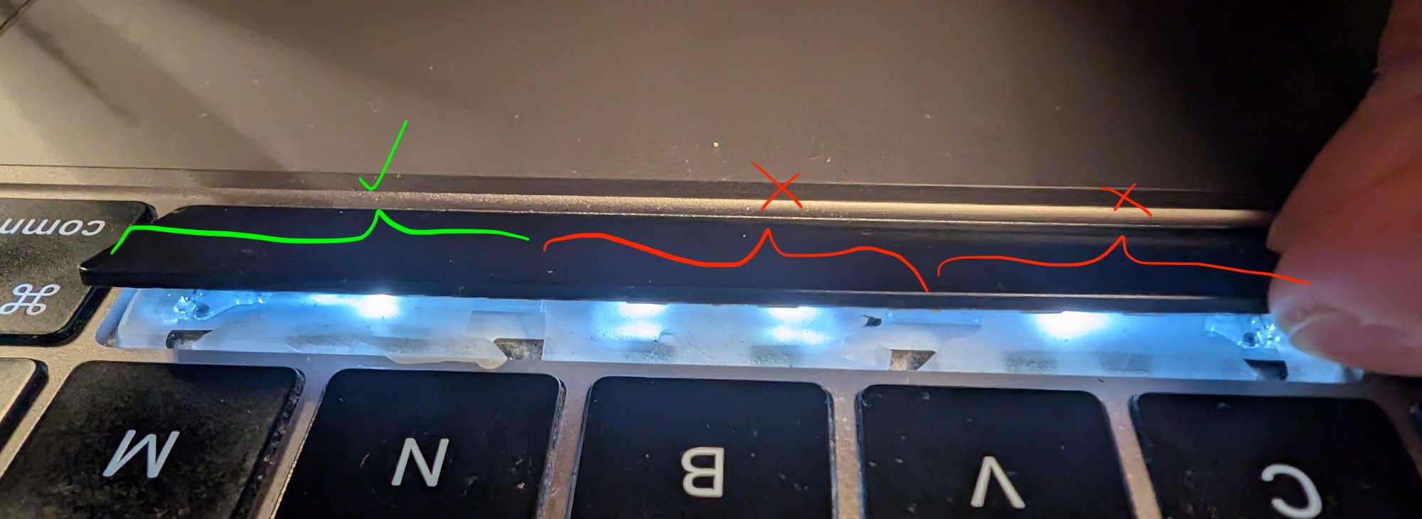

It looks like two sections (marked by red x) got that membrane trapped, they're held by it and not sure how to fix it.
I can't put it back into place either as I think that membrane is obstructing the "clips".
Any ideas how to sort it out? Lifting the key more by force is not doing much - the membrane stretches but I don't want to tear it apart.

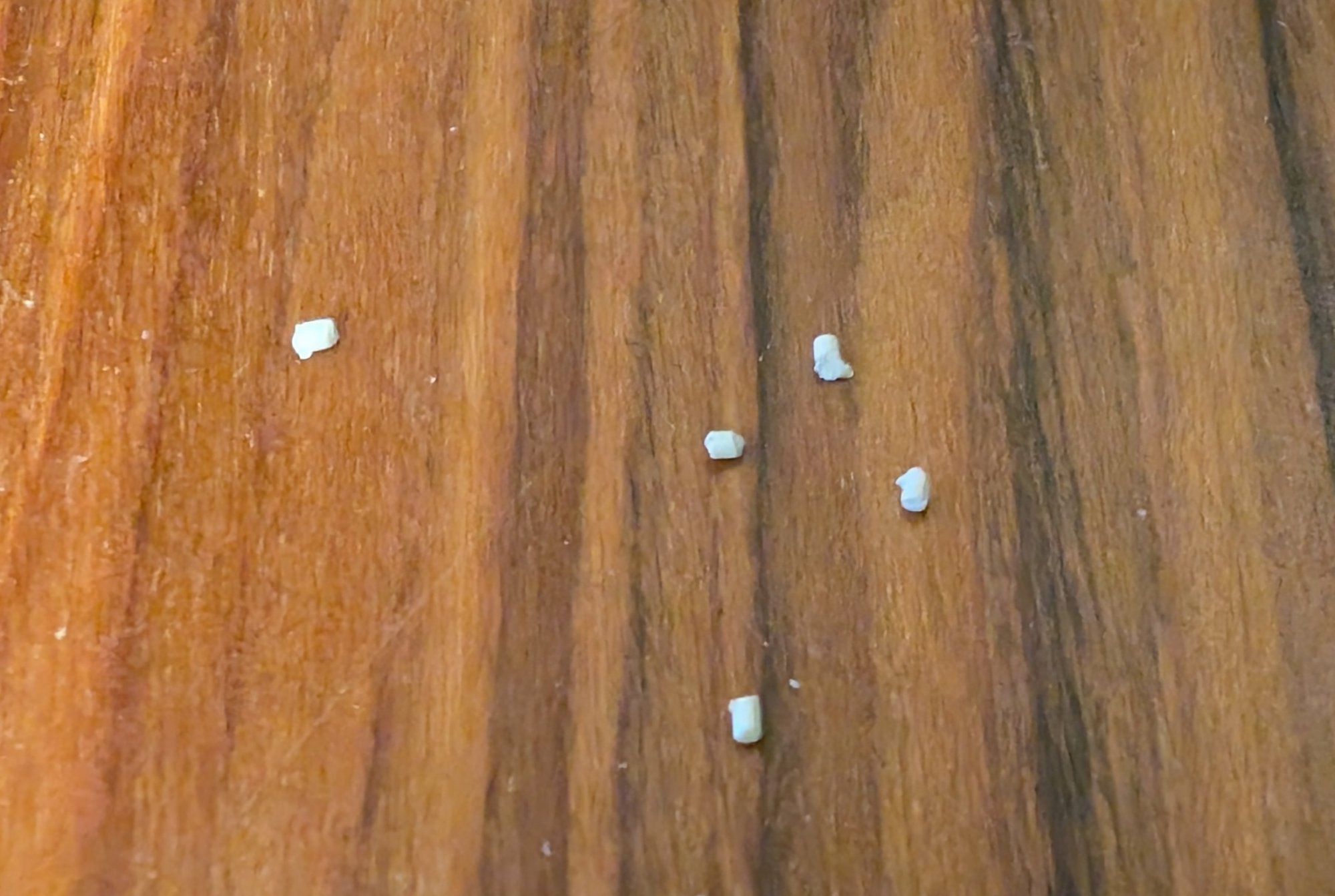

Anyway, I realised the key didn't separate from the main mechanism, hence it was pulling the membrane. So I managed to actually separate the key and found 5 little pieces that were already broken - that's why the key became more and more "sunk" over time. Basically, the main mechanism is no longer kept in place by the 3x white/translucent elements in the middle so the mechanism doesn't work properly at the entire length of the key. Need to replace it.

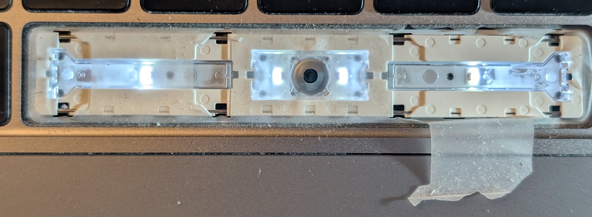

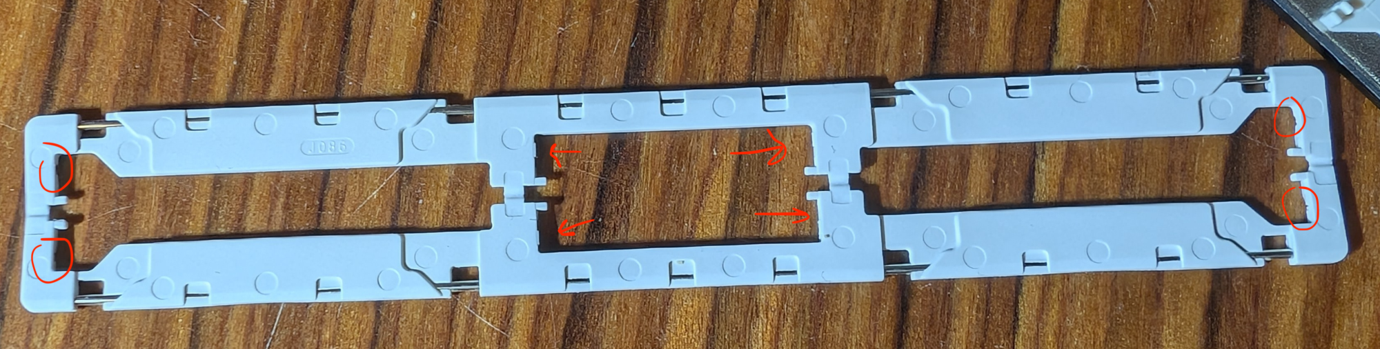

Quick update: seems that these translucent elements which holds the mechanism are also glued onto the main metal element, not only tight-fit with the pins. Anyone knows if I will be able to fit them back without using any adhesive?
All mounting "legs" are broken off so defo needs a replacement.

I own a 2016 13" MacBook Pro that uses a design that looks to me identical with yours...100% the same.
I replaced my spacebar assembly with one on Ebay that came directly from China ( took a few weeks to make it to the USA ).
I certainly did not need to buy a new top case...not at all!
I suggest you take a look at my Post, here, from 30 December 2024, and read how I managed this repair. Once I had the new parts in front of me and gave some thought on how to install them, it was actually pretty easy. I did use "double sided adhesive tape", and it seems a really critical element in the process. It's been a while since I bought my supply, but I think it's a very common item, and should be available in a good, office-supply store.
The 'trick' here is that you ( seem to me! ) to need to take everything out and start with a clean, empty surface. You need to think like Apple did, and make assembly as easy as possible...their design makes plenty of sense, if you start from a bare surface and work up.
Be VERY careful when you snap the actual bar into place: at least on mine, there IS a top & bottom, and I'm thinking that if you try to push it in upside down, you may need to start over, with a new kit!
Once again: I bought my kit on Ebay from China ( I recall the same thing's available from a USA Distributor at extra cost ), and I received just what I needed...EXCEPT, the double-sided tape!
Good Luck...if my experience is not unusual, this is actually an easy repair...once you 'Think like Apple!'

Nice one, thanks a lot! I've ordered a new spacebar kit from ebay (£15) and should be with me on Tuesday. I have already disassembled the key itself few times and you're totally right - I seem to got a much better idea how it's designed and being engineer myself, I understand their "bill of process". It's relatively simple as long as you put the pieces in the right order and orientation.
I think I'm going to go with a self adhesive tape for these translucent bars that hold the mechanism as a non destructive adhesive. If that will not pass the test of time I'll fix it with some glue for plastics.

When I did mine ( which may be a bit different than yours...) I just took everything apart, so that I was looking at bare metal...no plastic parts left! I then just spent a few minutes and understood how the assembly went together, and it became VERY clear that the pieces simply dropped together, and that the assembly was then affixed to the metal base, then the actual bar snapped into it.
You may see some videos where someone's suggesting that little pieces of plastic need to be pushed and worked into place, and that's just not a good thing to try...they will almost certainly either break or be damaged.
I'm guessing that you know what I'm saying, or will once you simply start with a bare metal base, and see how Apple did things.
Just make sure that you see how the bar, itself, snaps into place...mine DOES have a 'top' and 'bottom', and about the only aspect of Apple's design that DOES seem weird to me, is why they did not make it so that it would go in, either way...there's very little difference between top & bottom. As I recall, I felt the need to go back to some videos, and find one that showed the assembly as it was being taken apart, so that I could see where the bar was, originally.
