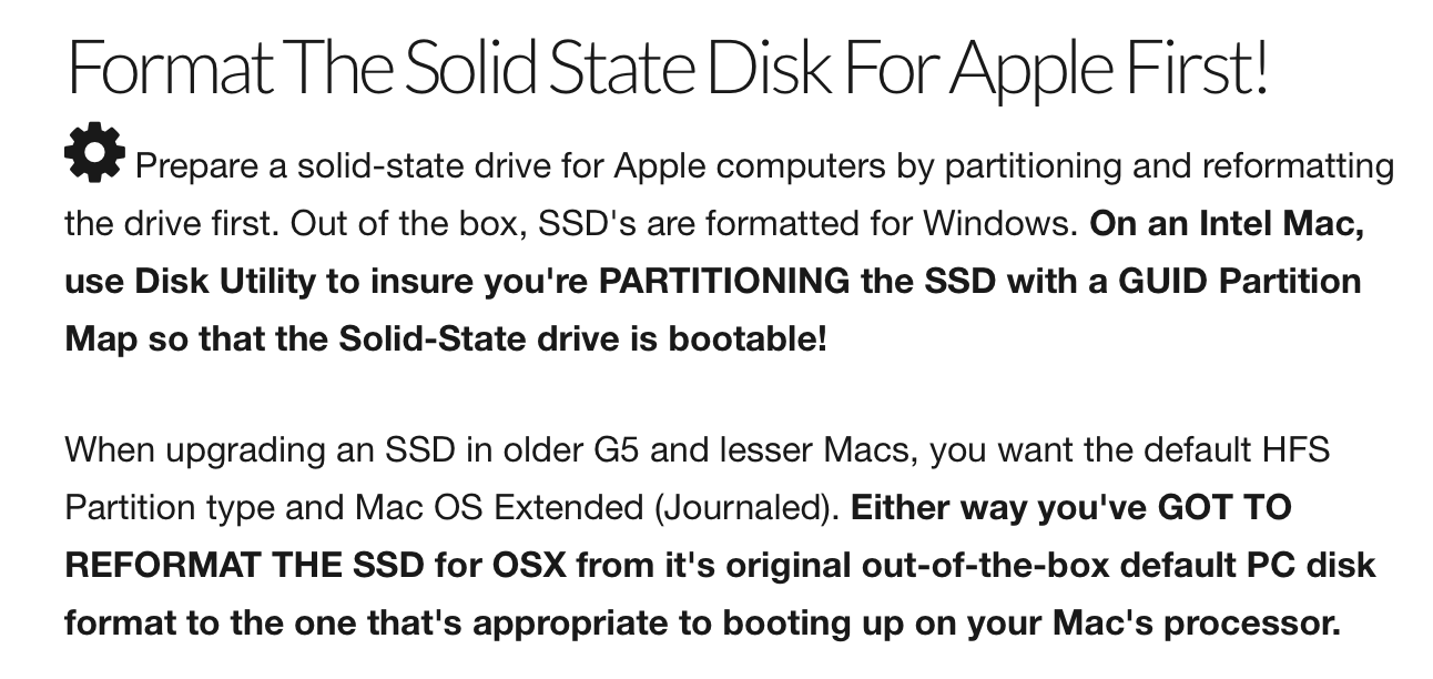

I guess the first step is to make a clone of OS 10.15.5 Catalina onto a drive: I'm going to use Disk Utility to clone onto Samsung 860 Evo that I'm going to upgrade the 2TB Fusion Drive. I am going to do what this guy have done
; the dude is a bit irritating but the instruction seems sound... Right?

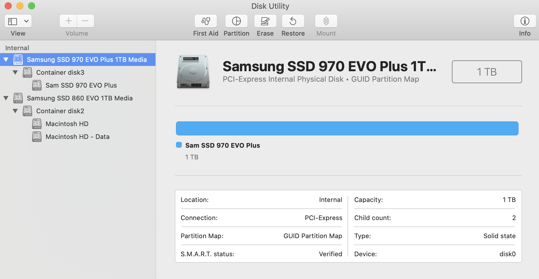

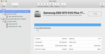

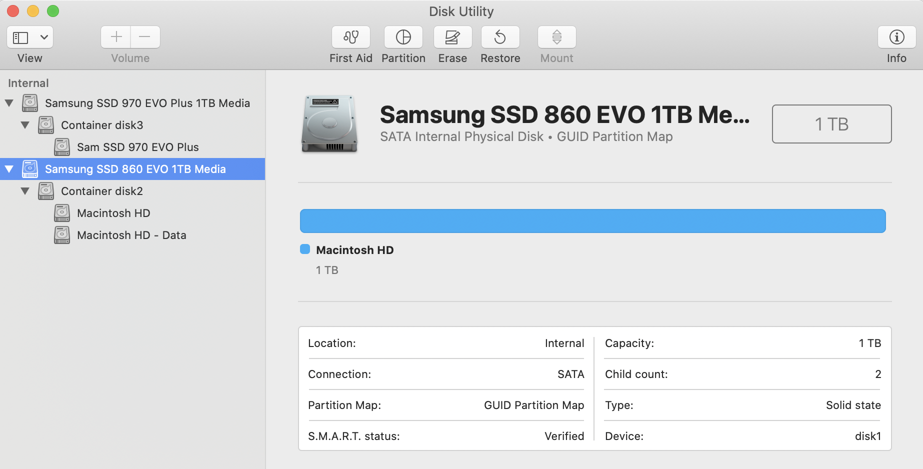

Welp, all in all it went well; now I have Samsung 970 EVO PLUS 1TB in the NVMe slot and Samsung 860 EVO 1TB SATA in place of Fusion drive.
When I initially lifted the screen, I was so happy to have separated all the tapes, I lifted it up too high and the both display plugs came off their sockets resulting in breaking off a tab on the side of one of the sockets; it still kinda snaps in though but not very securely. If I have to change the socket... IDK what it might involve; suggestion: don't go there. Lift just enough to unplug in well lighted place so you can see what you are doing. Besides the fear of cracking the glass, the next hardest thing, for me, was disconnecting/connecting all the plugs into the sockets; they are so tiny and delicate.
The first time I closed the screen and turned it on, nothing happened. I had a hunch that it was the socket w broken tab but nevertheless bummed w dark clouds rolling in... Sure enough it came off the socket! I replugged it, used electrical tapes to secure the screen, then turn it on and voila! it came on and working beautifully.
I suggest, to anyone who wants to try this, a caution on lifting the screen up for the first time: Carefully lift up just enough for you to see the plugs/socket. Be super careful w the plugs & sockets. Besides that the only mishap was stripping a TORX screw but it's holding and hopefully I won't have to unscrew it again. Other than that everything went swimmingly.
Now I'll have to order new adhesive strips to re-attach the screen ie making sure the display connector stays plugged in; perhaps I'll put a tape over it.
Thanks guys!
