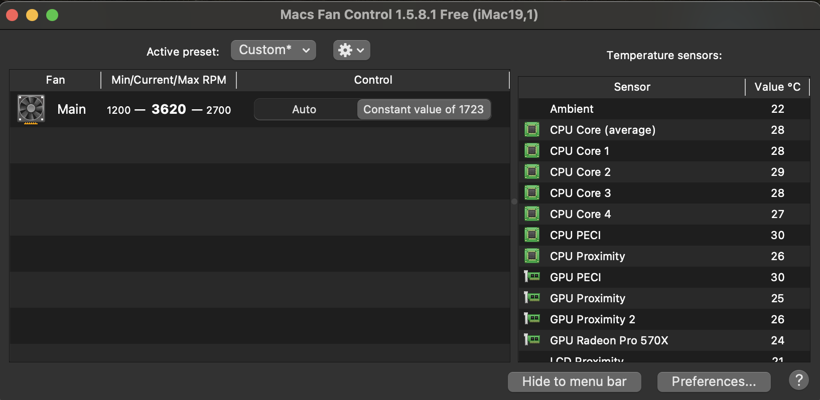

So I have tried using the Mac Fan Control app, but either I am not using it correctly or it isn't working. As you can see in the screenshot, I have tried to set the fan to a constant rate but it is still just going maximum. Not sure what else to do here... Any help is greatly appreciated!
The fan is running at a higher speed (3620 rpm) than the maximum limit (2700 rpm), which tells me the computer has no control on the fan speed. ~3600 rpm is probably the maximum speed the fan can physically run at, but it should be electronically limited to 2700 rpm. This is analagous to a car that can physically go at 150 mph, but is electronically limited to 120 mph (as most cars nowadays have an electronic limit.)
Seems like a hardware control issue.
That is a good analogy. Thank you. When your say hardware control, do you mean the actual fan? Or do you mean something on MB that controls the fan? As I said, I did run diagnostics on it and returned an error of PPF003, which Apple said meant “low speed fan issue”. Is this something that just replacing the fan might solve?
I don't know; my point is that it seems like an hardware issue, not software. It could perhaps be as simple as the fan connector.
