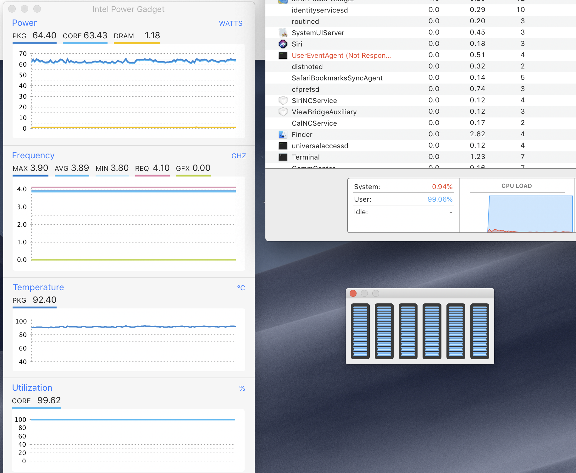

We just took delivery of the base 2019 iMac. Specs are 3.0 Ghz, with single core turbo to 4.1 (6-core turbo of 3.9 Ghz).
There are lots of reports about how the i9 version can't manage all-core turbo due to design limitations of the case and/or power supply. So I though it interesting to see how the i5 base model compares:
Running a "yes > /dev/null &" test, which pegs all 6 cores at 100%, leads to a stable 3.9 Ghz, 92C, with the fans not audible.
This is well above the base speed, and exactly in line with the expected max turbo for 6 cores. I think that is mighty impressive.

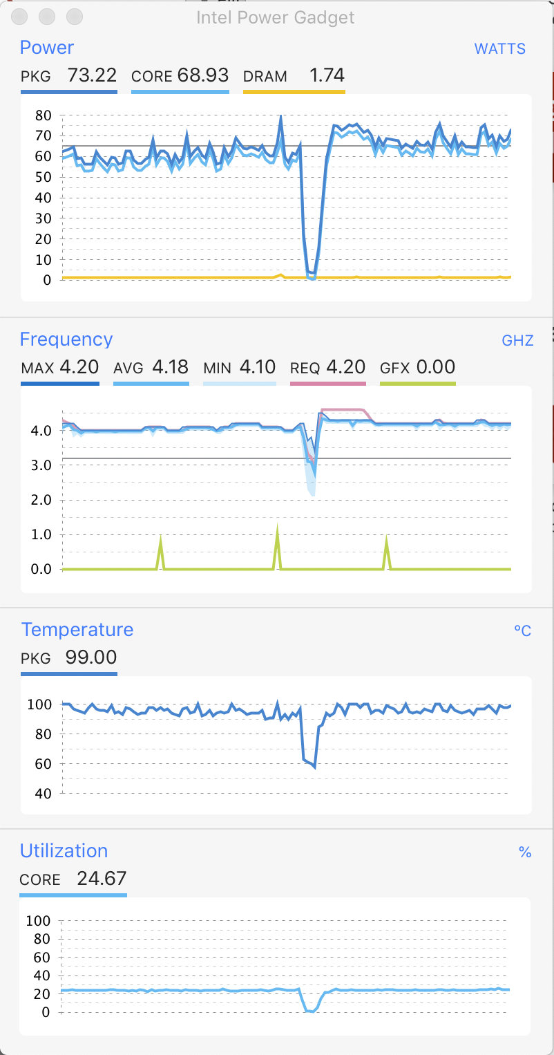

What if you launch 6 instances? The CPU is the same as my Mac mini, so I'm interested to see what is the stable CPU speed of the iMac under 6 core full load Compared to the i7 Mac mini. 👍
With 5 cores loaded, the best the i7 mac mini can maintain is ~4.2 Gh.
Therefore clearly thermally constrained (-5%) relative to the 21 inch iMac.
