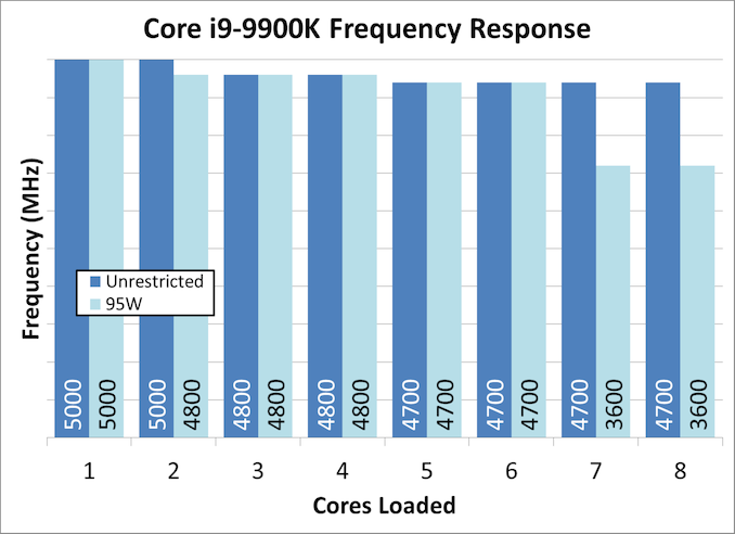

Cause that 5 GHz turbo speed is when only 1-2 cores are loaded and there is thermal headroom for it. As more cores are loaded, the lower the clock speed. That’s been the whole premise of Intel’s turbo feature when it came out. When the full CPU’s capacity wasn’t needed and if it could thermally, the remaining cores could go at a higher frequency.
This is what Anandtech found when they restricted it to its 95W rating. Yes one allowed to go above it can sustain a faster clockspeed given it can be cooled. But it’s reasonable to believe Apple restricted its power consumption thus when loading all 7-8 cores, does it drop close to its base clock.

Also, apple does not advertise 8 cores at 4.8K They advertise OC at 5K, which even limited at 95W you get for 1 Core, and you still get 4700 for up to 6 cores at 95W limit.
The 8 cores at 4.7K are the spec for the unrestricted 9900K which you won't get on an AIO. As it has been mentioned, for full-fat processor performance, PC with water cooling. Want an AIO, be prepared to sacrifice something. I also want a 1080Ti on my AIO, but it is not happening, so I have to live trying to decide whether is worth paying £400 for a vega 48, which is far from its real cost as you can get a 2070 for that price.

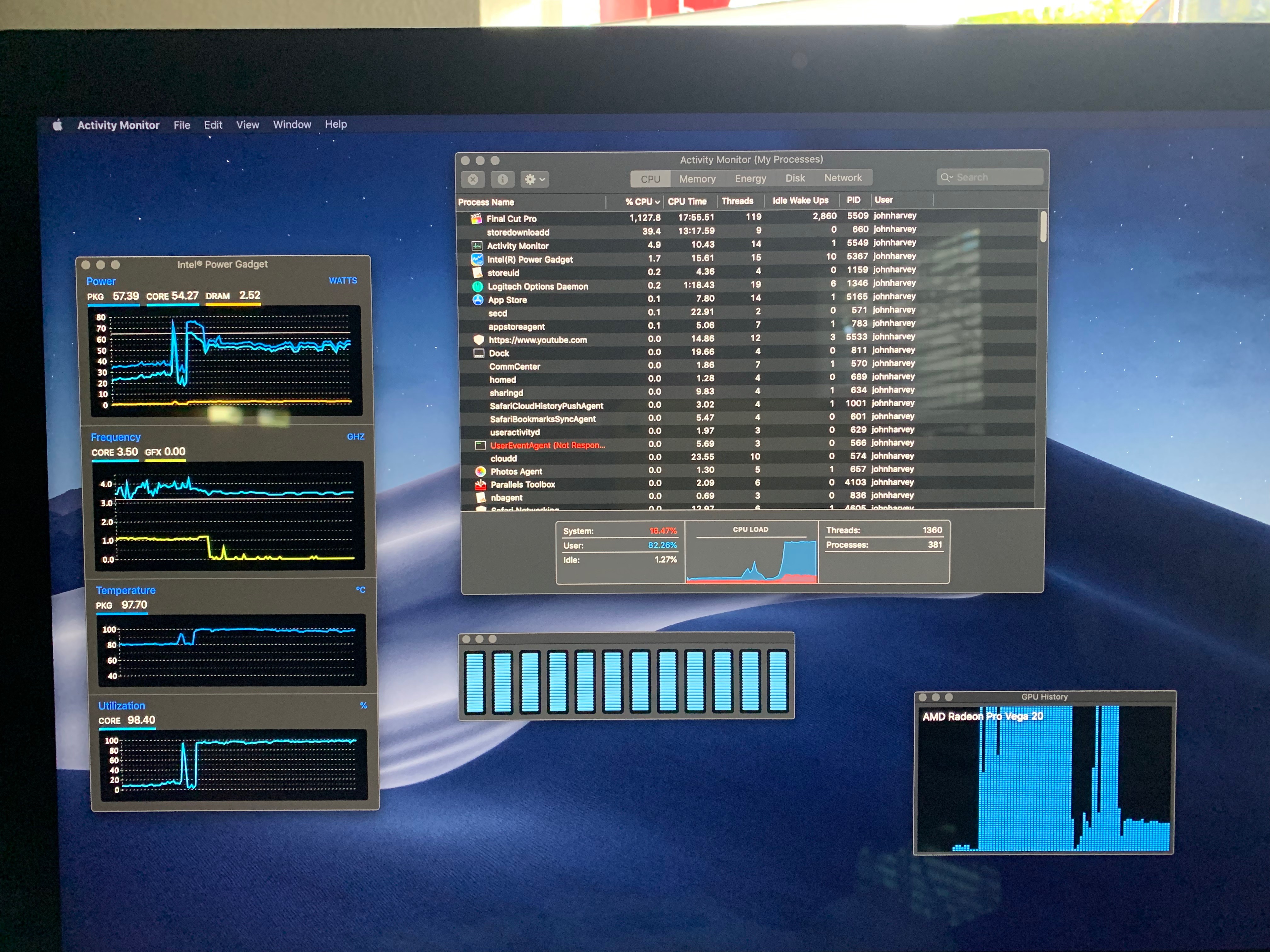

The thing is, running at those 94ish degrees is not too bad is it?
I’m not comfortable at it running at those temps. It’s below the 105 C limit before Intel’s protections will force shut it down, but who knows how much the surrounding components can take the heat especially if you still have a spinner. Heat loves to kill normal HDD’s.
I will likely manually turn up the fan to cool it off as I have with my current iMac. Rather have fan noise and have it run cooler than quiet and have cooking silicon inside.

Yes an unrestricted 9900K with proper cooling can sustain all core of 4.7 GHz. When Anandtech limited it to 95W, all core would only sustain 3.6 GHz. If one was expecting an unrestricted 9900K in the iMac’s enclosure, think those expectations were set wrong.
I agree with your point about people having wrong expectations. Nowhere does Apple state the i7-9900k in the 2019 iMac will run all cores at 5Ghz or 4.7Ghz. Apple's product page clearly says 3.6Ghz, turbo boost to 5Ghz. Like any other PC manufacturer, that is referring to Intel's turbo boost behavior for a single core in the default 95W TDP mode, not the thermally unrestricted mode.
