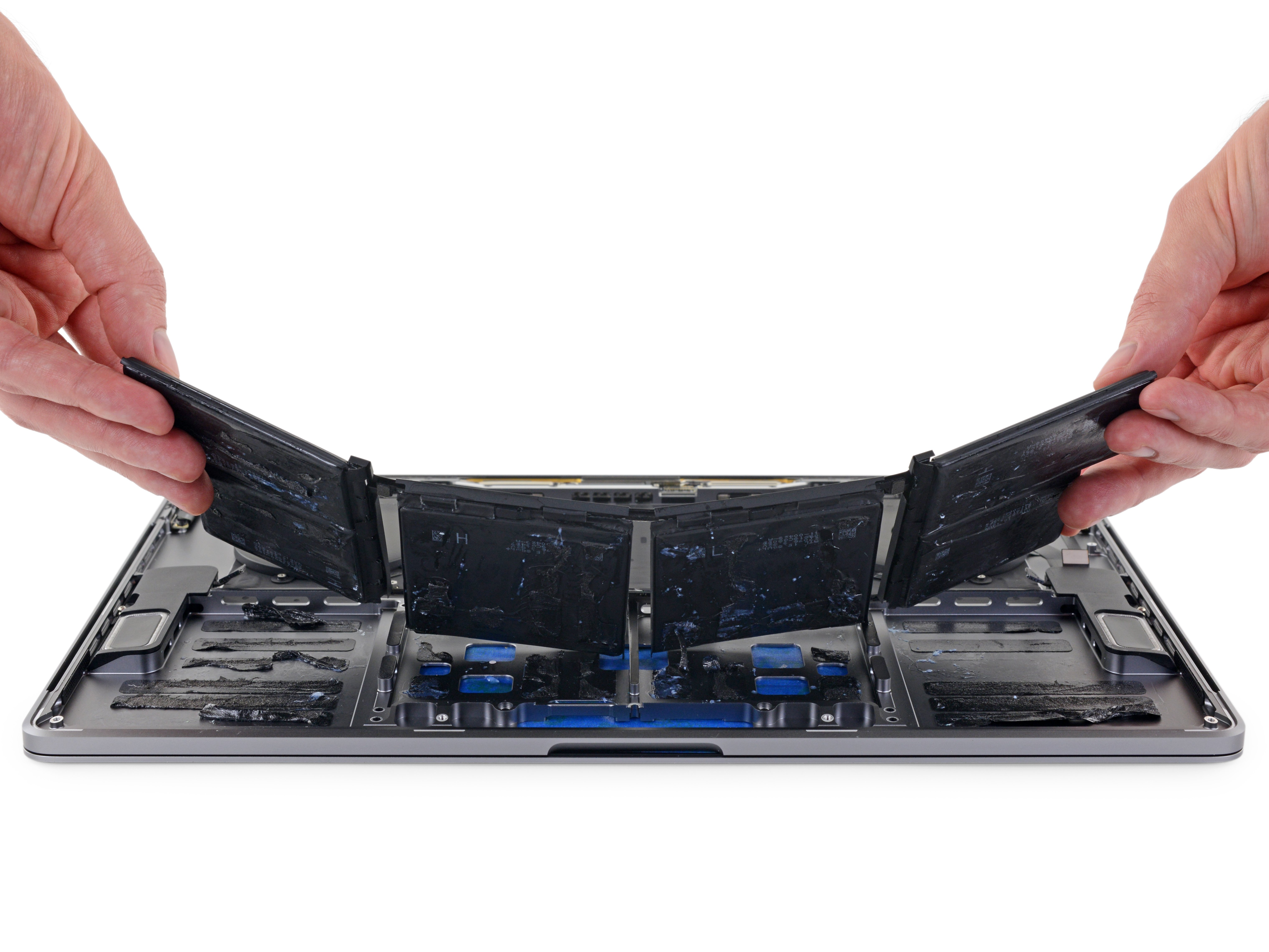

If not, possibly a dead battery. I believe the laptop won't boot w/out a functioning battery. You can replace DIY...

Mine had this problem. I took it to the apple store, they removed the bottom and unplugged it from the mother board. This reset something and it's been working fine. Best of all, they didn't charge me.
