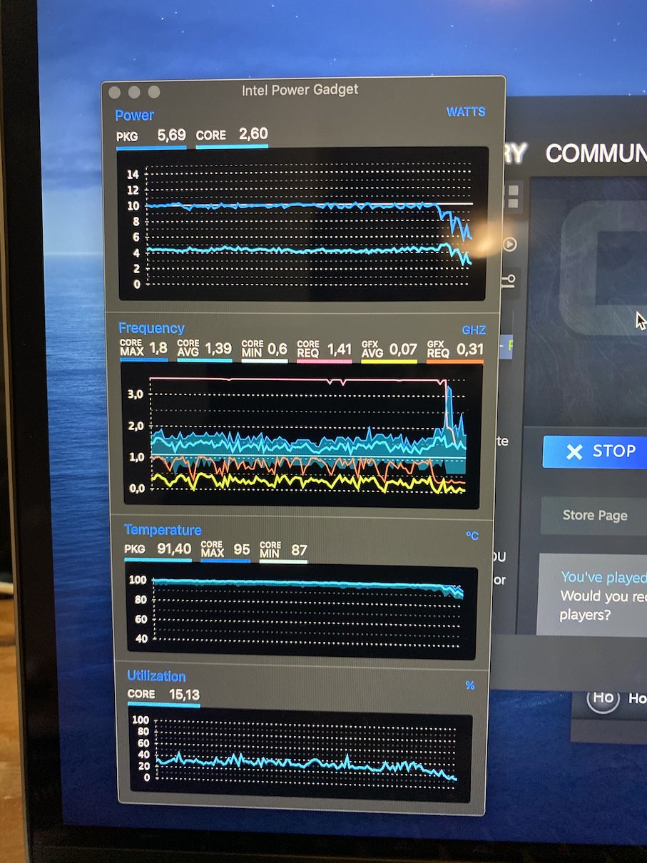

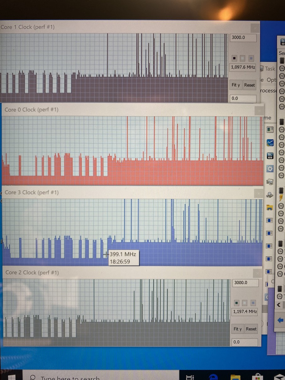

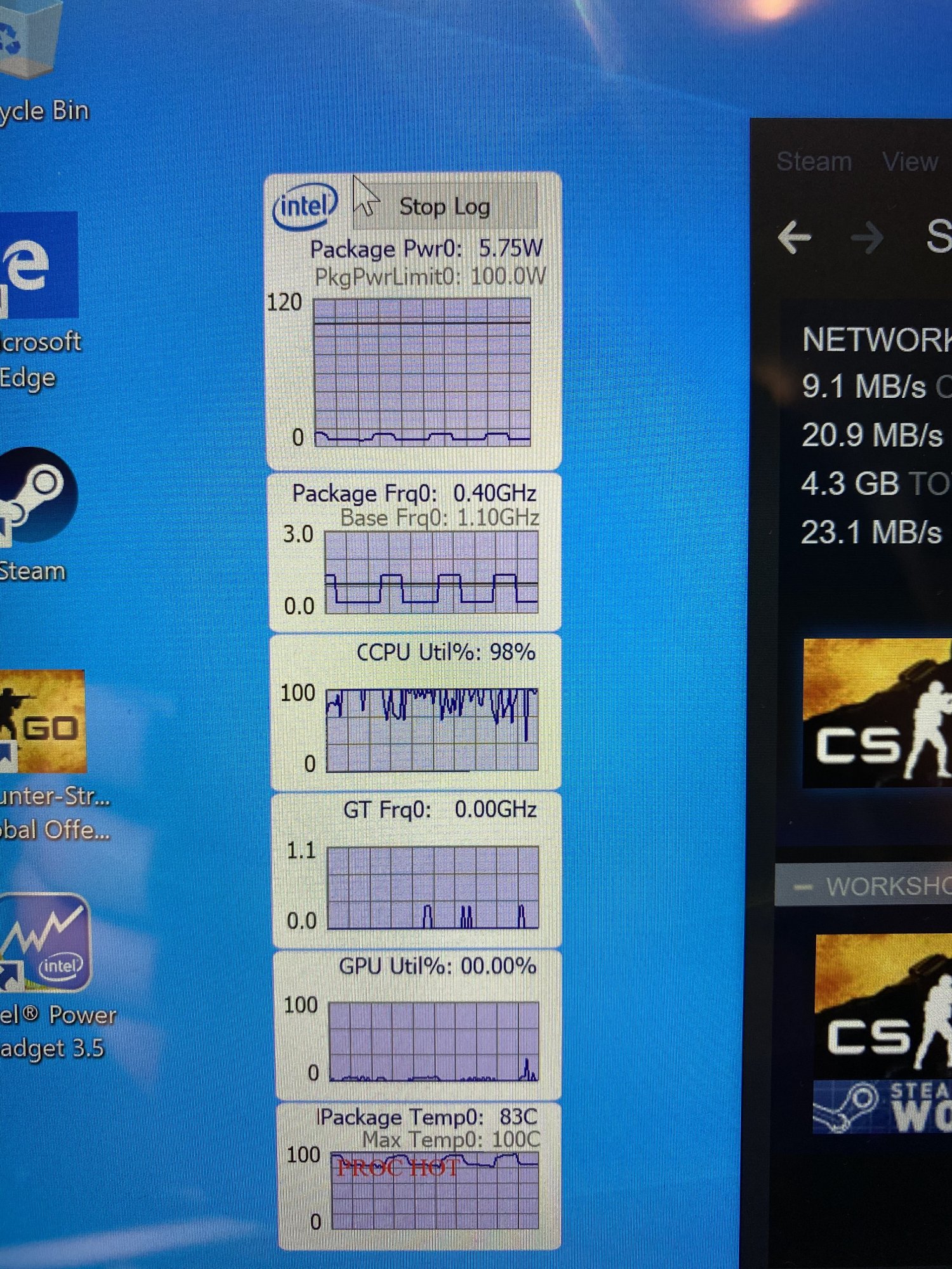

First I set up bootcamp to be able to try out CS:GO in better circumstances. Again, this is something that my old 2015 Macbook Pro was able to handle (and it wasn't much more expensive back then than this Air now!) so I don't think I ask too much.
Note how the CPU drops below the base frequency. And not even on a constant level, but it does it like that. In-game this meant that I had 10-15 fps and 70-80 for a few seconds.
Here's what the result looks like with a better benchmark program:
Yup, 400 mhz. "But this surely must be some other error, not thermal throttling!"
Well, this is what the sensors said about it:

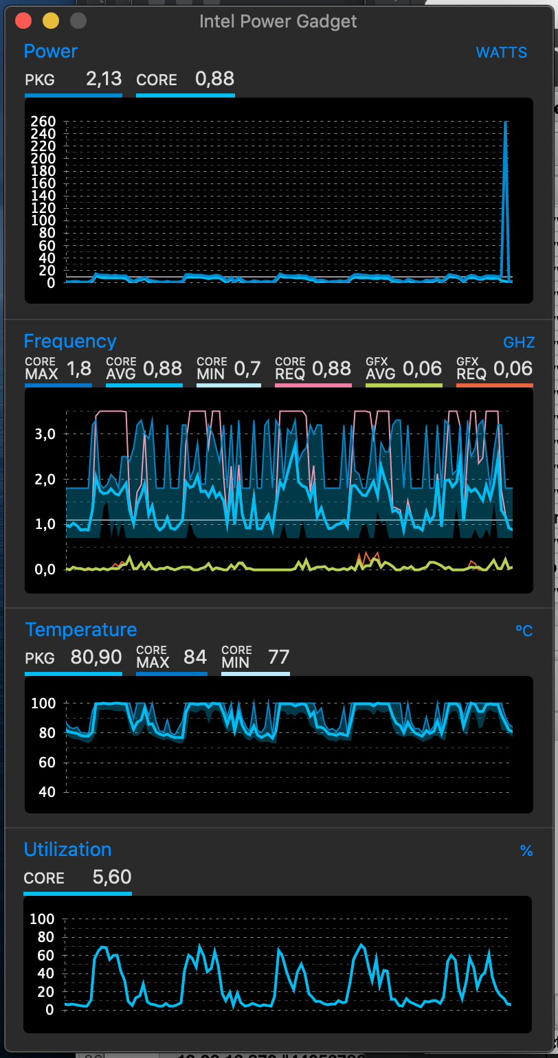

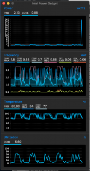

But I gave it a shot under MacOS as well:
No thermal throttling indeed. But do I want a CPU that "boosts" to 1.2 ghz from 1.1?

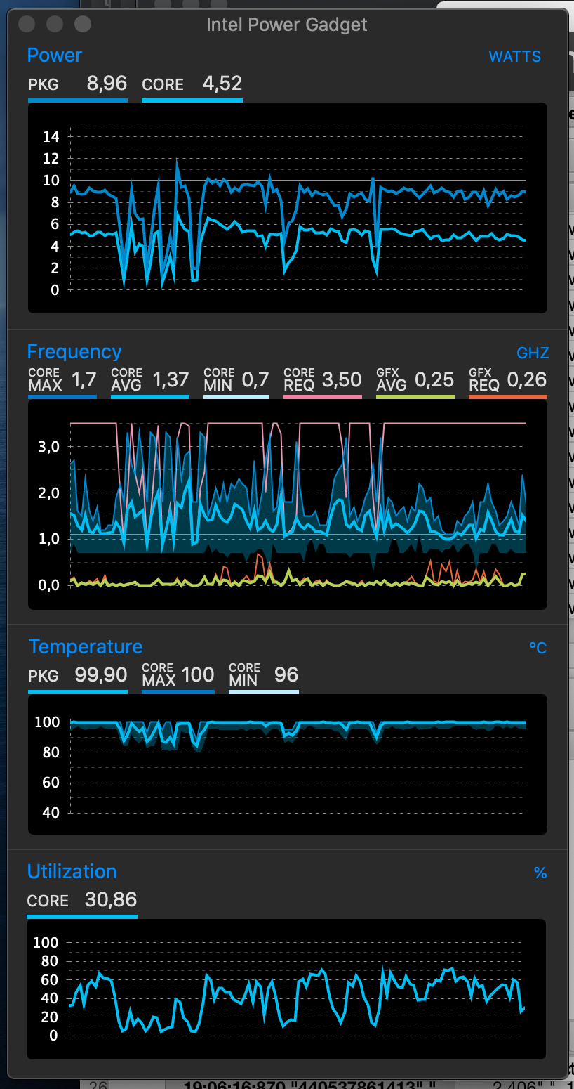

But I thought that this must be just a CS:GO bug or something similar, so I did another test. Here's the performance under my regular workload, under MacOS:
Yep, it drops under the base frequency until the CPU cools down a bit. So it IS thermal throttling.

You certainly have strange results. While the other reviewers have pointed out that the computer cannot sustain turbo boost clocks for pegged cpu loads under synthetic benchmark conditions such as Cinebench, none, to my knowledge, have indicated that the machine thermal throttles (i.e to below base clock) under sustained load. Has bootcamp been updated with drivers for the 2020 Air yet? Something seems very wrong here.
P.S. Also in your first screenshot the PkgPwrLimit0 is reading 100W and only running at 5.75w. The MBA cpu is not rated or capable of 100W power draw limit.
I can't wrap my head around these results either. I think this should deserve more attention, so other people might try it too and see if they can get the same results, because at this moment just like you said, not one reviewer admitted that the machine actually thermal throttles below the base clock.
Drivers: I tried running the tests right after bootcamp finished installing (drivers included), tried reinstalling the drivers, running Windows Update, and even tried updating the most important drivers manually, one by one in device manager. I'm not sure what else is there to try...
Draw limit: yeah I noticed that too, but that might be just the Intel Gadget's weird behaviour, that's why I tried HWINFO as a fallback.
