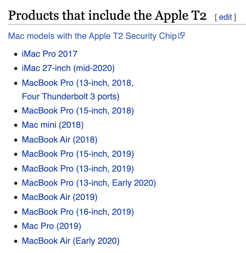

If the T2 is to blame it would explain why my last imac was so stable, and this one isn't.
2020 refresh is the first imac to have T2 (not including Pro).

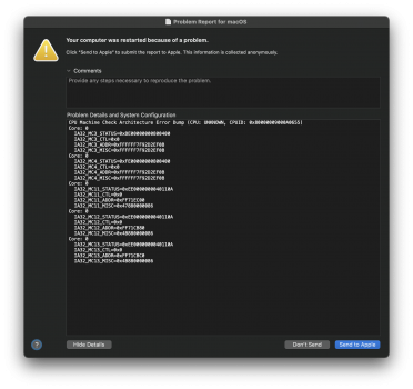

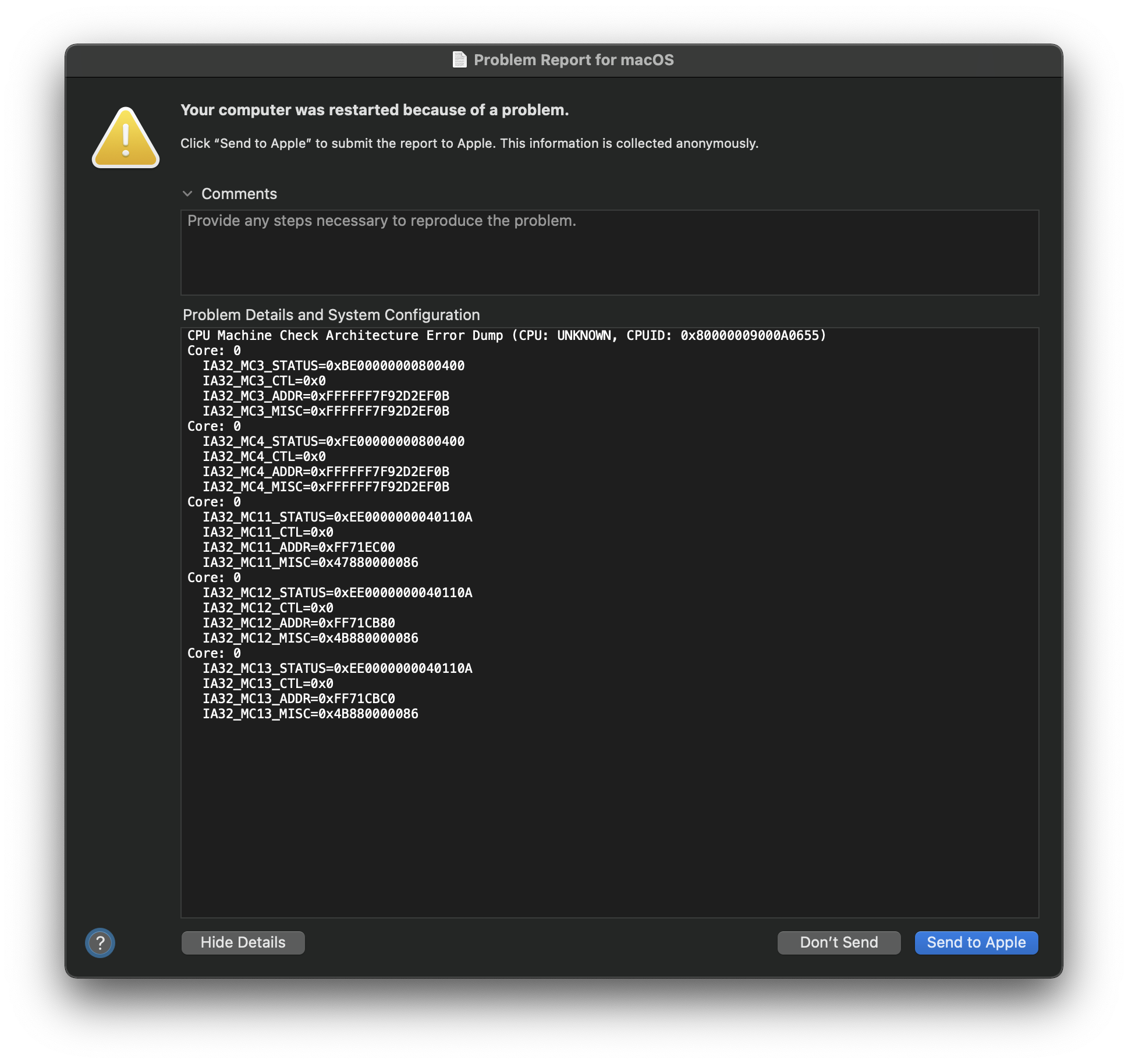

a screen shot of one of today's panic reports is here –
