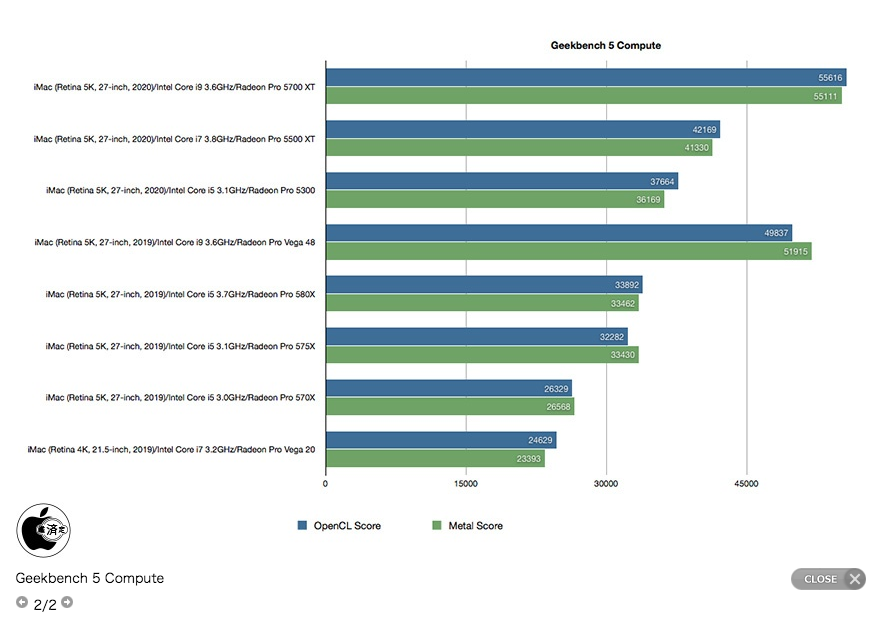

I came across this benchmark, comparing a 5700 XT to the 5500 XT, but the configurations also are between the i9 and i7 – making it kind of an irrelevant comparisons between GPUS. Ideally, both would be the same processor, with different GPUs.
I am struggling to find a good comparison just between the 5700 and 5700 XT to see if that's money well spent. I personally do not know what 8GB compared to 16GB of memory actually translates to in real world applications, and how much of that will mean Adobe applications work faster and better.

I get that it's only a $200 difference between the 5700 and 5700 XT, but the same logic can be applied between the 5500 XT and 5700. I'm interested in knowing if there is a significant boost in performance and productivity between the 5700 and the 5700 XT, or if the difference is relatively marginal.
It's becoming a bit frustrating to find a comparison between the 5700 and the 5700XT or 5500XT, which is something I'd really like to see.
