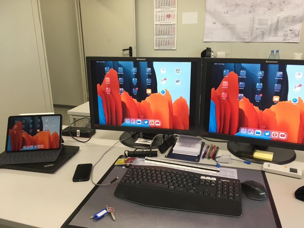

Well, wouldn’t you believe but picked up this dock for work the other day.
Tried it with the iPad for you..works a charm!
Reactions: Allan in T.Dot
There is a black USB-C cable sticking out from the right side of the tablet and running to the dock. About 2cm to the right of the tablet you'll see a white sticker with a bar code - that is attached to the cable and will make it easier to identify.
How have you created this with nothing connected to your iPad Pro?
Reactions: Hallstar
Yip, its indeed connected via USB-C. No problem, also tested inserting a USB drive and headphones; also works without issues. Can confirm it charges the ipad too. It's a great dock actually. My displays are ancient 24" and connected using the the two Display ports.
Reactions: Hallstar

As expected, can confirm that the dock needs power for it to work. The power supply is the usual Lenovo rectangular connectors so someone in the office/work will have one! 🙂
