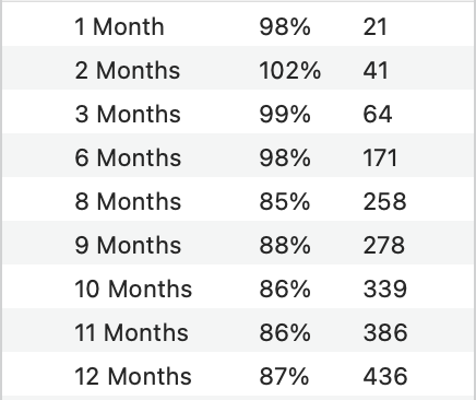

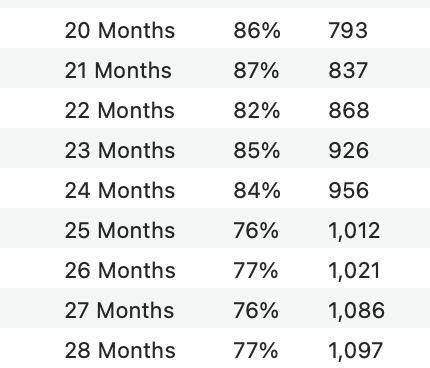

Attached is my history for the 1st 12 months with a 2019 MBA. Used almost 100% on battery, almost never plugged in when in use. I'm at 2+ years now and it's showing 77%.
Check it a few times. The number tends to bounce around quite a bit. I think what you have is normal.
77 or 87?
