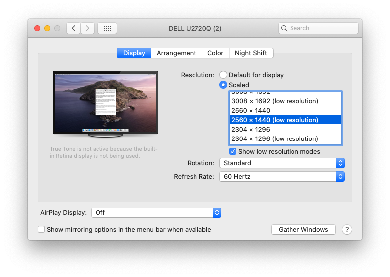

Yes...the instructions describe a process to enable additional resolutions with a "Low Resolution" feature which seems to disable HiDPI (Apple's retina/pixel doubling feature). I tried it and it is very blurry :(

Blurry on the external monitors; that's why it is called "Low Resolution".
I need two external screens and am running the MBP in clamshell mode.

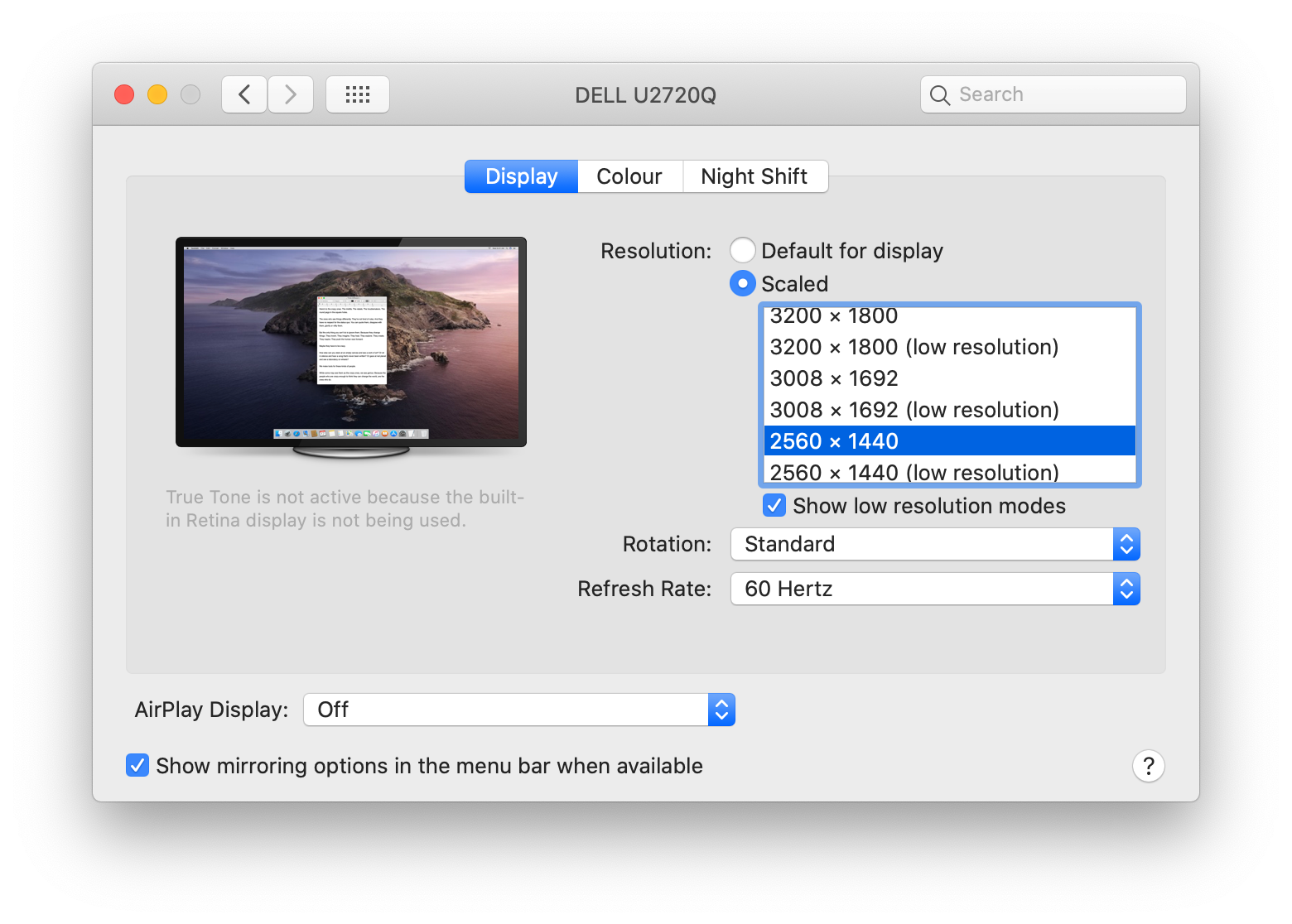

Well thankfully they arrived a day early! I set up the displays and they are absolutely stunning. I am running them at a Scaled resolution with a "looks like 2560 x 1440".

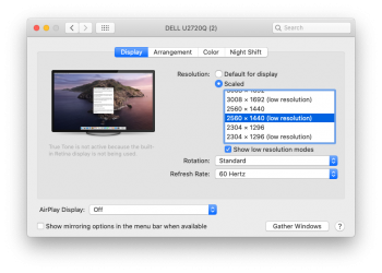

Have you turned on High Data Prioritization in the Dell monitor OSD? I get 4K@60hz with USB 3 all over USB-C on a 10th gen and 8th gen/2019 MBP 13. There's a weird bug where it selects 30hz instead of 60hz. Just hit Ctrl when selecting Scaled and tick the box to enable low resolutions. Don't pick a low resolution, just change your refresh rate here.
