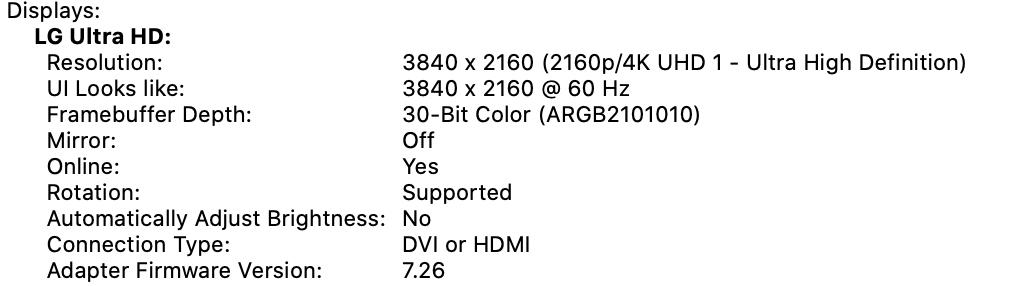

I've got the 24" version of that LG monitor that I normally use on a Windows machine (24UD58-B) but I currently can't hook it up to my 2020 MBA to try as I don't have a USB-C adapter. I did try the monitor with a mDP->HDMI and was able to get 4k@60 once I found the setting above. Mac OS does report it as a 27" monitor, though.

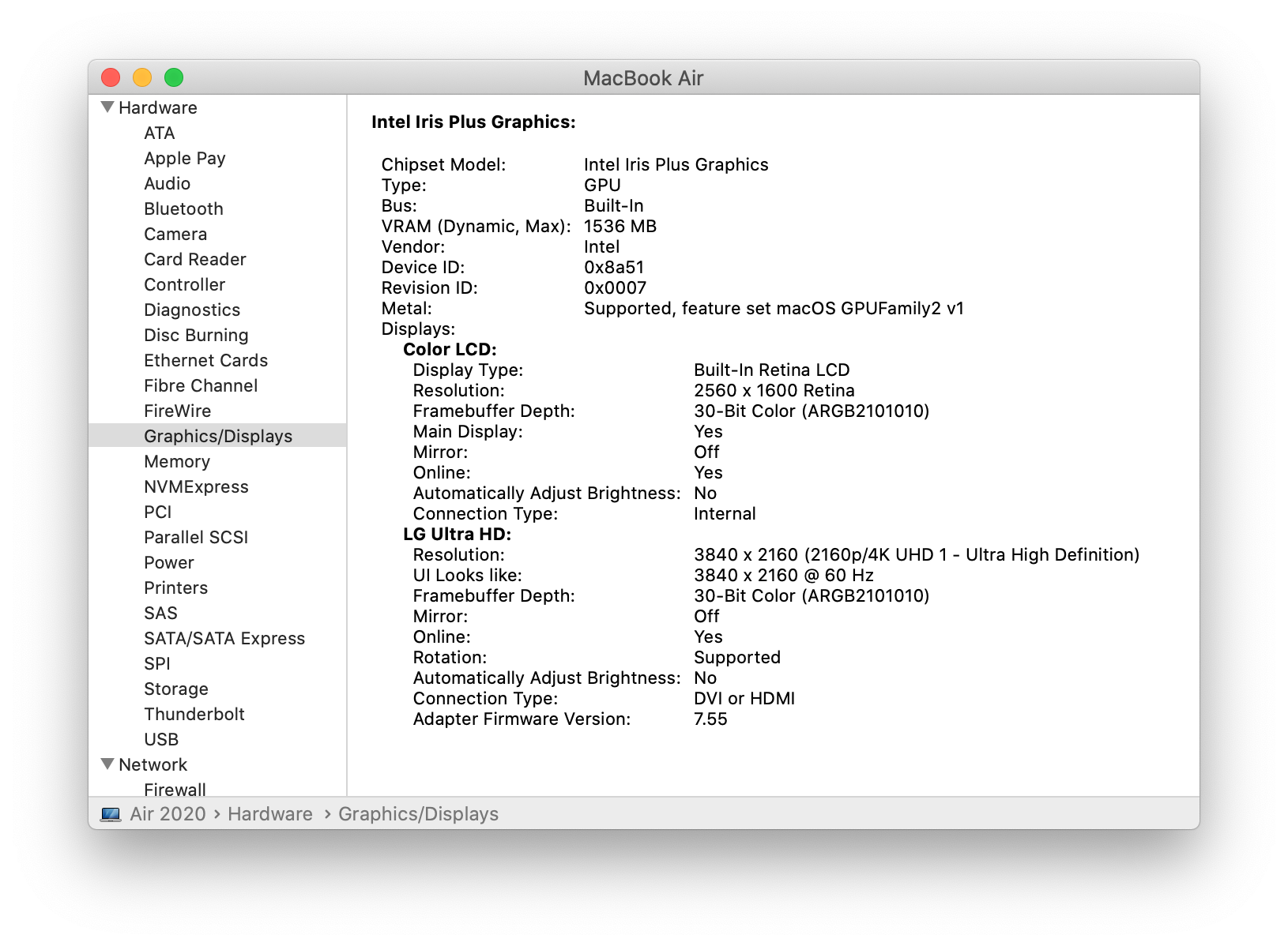

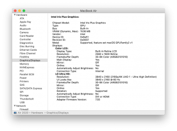

Just to have adapters I got this Uni USB C to HDMI Adapter from Amazon today. Shows 60Hz after enabling deep color. It is disabled by default per port on my monitors. Maybe different firmware in the monitors themselves.
