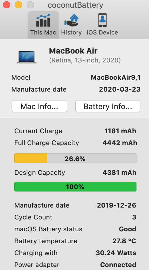

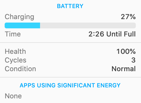

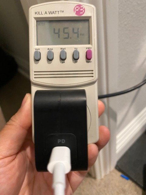

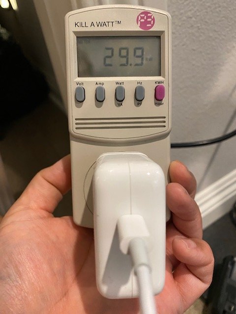

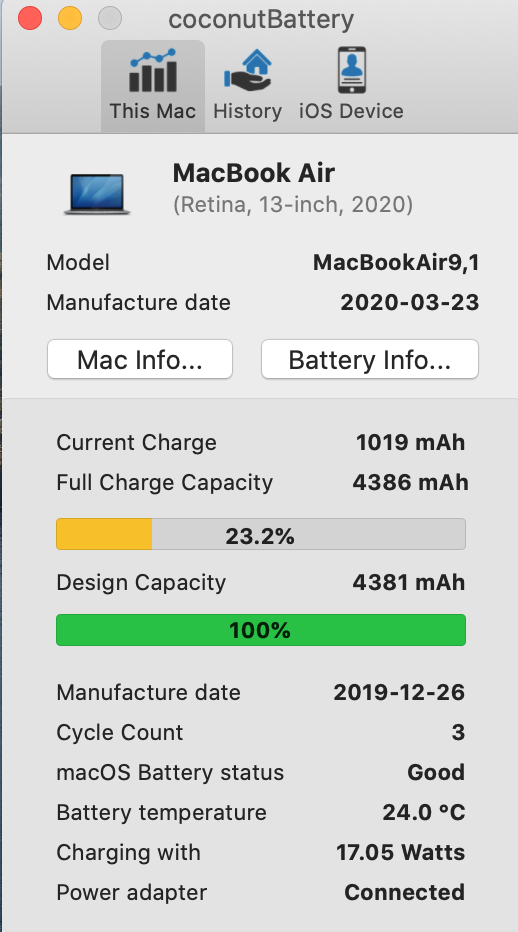

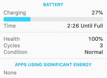

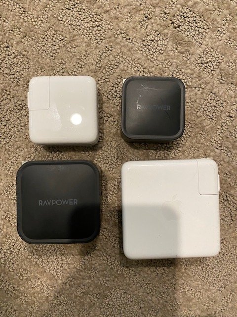

Tried different power supplies today with my MBA
The top power drain is 45 watt, but Apple doesn't make a 45 watt power adapter...
Pro: Faster charging, will charge even when pulling full draw such as gaming.
1. 30 watt stock adapter
2. RavPower 61 watt GAN slightly smaller than stock adapter $22 today on Amazon...
3. Ravpower 90 watt GaN charger in between 96 watt MacBook Pro 16 charger and stock charger in size
4. 96 watt MacBook Pro 16 charger

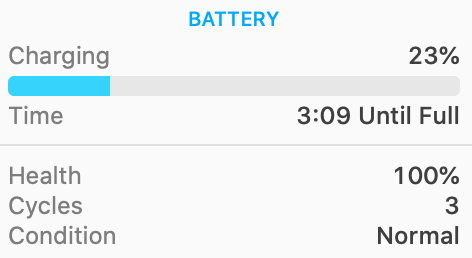

1. Stock charger

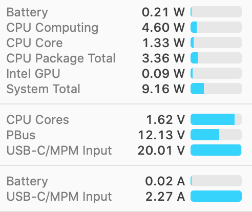

2. Ravpower 61 watt GAN
3 & 4 were the same as the 61 watt power supply so no advantage to higher power supplies.

Yeah I noticed when mine came in that the bottom case shows support for 20.3v 3a (up to 60w) charging. Like you, I can really only get up to 45w when the battery is mostly depleted but I’ll take it. I’m using an Anker 60w PD charger and anker 60w PD cables.
Good write up and interesting to know about the 45w capability of the MBA.
