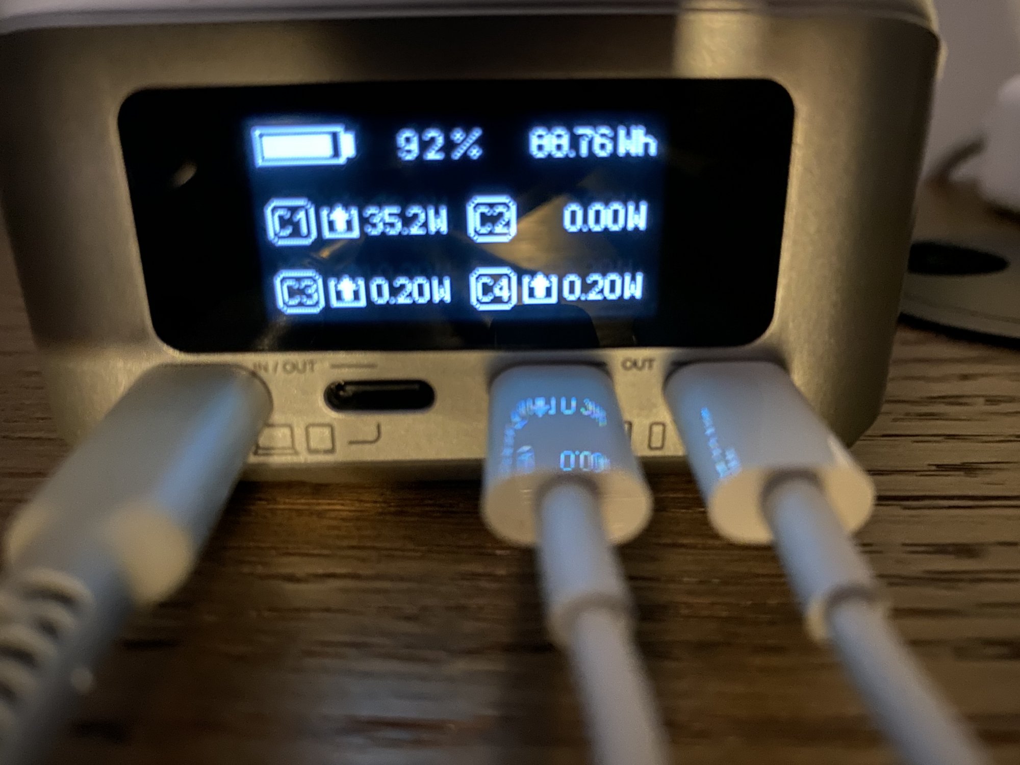

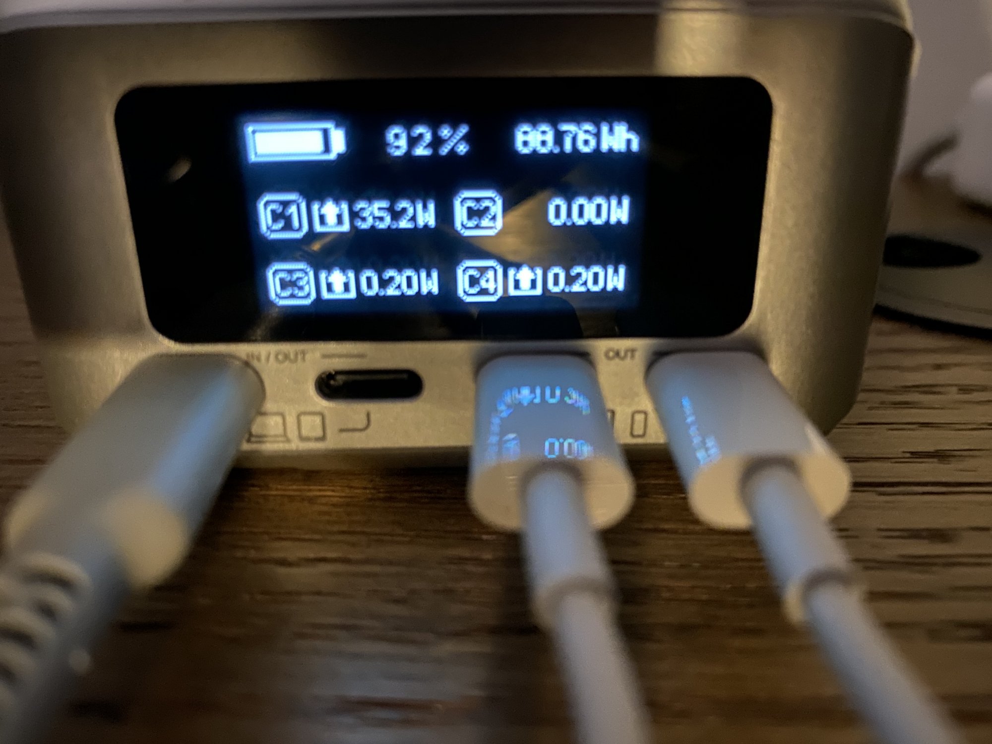

I have a battery bank able to deliver >90W. Just plugged in my 12.9” M1 iPP and it was pulling 36W when it’s battery was at 66%.
I‘m not sure if that’s the max or if it could pull more from a lower state of charge.

It’s a Zendure Supertank Pro. It can actually supply 100W on a single channel or 138W across channels.
I’ve tested max power draw from a lower SOC (15%) on the M1 12.9“ iPP and it is 36W.
Reactions: A.R.E.A.M.
Thank you so much for this test. It’s the only max wattage test I’ve seen for the 12.9” 2021 iPad Pro. If you get a moment, would you mind testing how much (maximum) power the iPad draws when it’s asleep vs. when it’s on, doing some sort of task, and the screen is at full brightness? I’d be interested to know if Apple lets it draw slightly more power when awake so that it can still charge at maximum speed while also powering the device. I’m using a 65-watt charger so it doesn’t really matter but this is just the type of nerdy thing I wonder about.

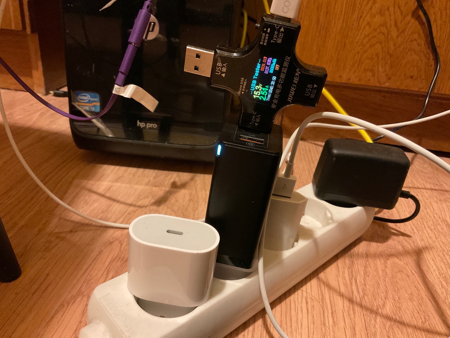

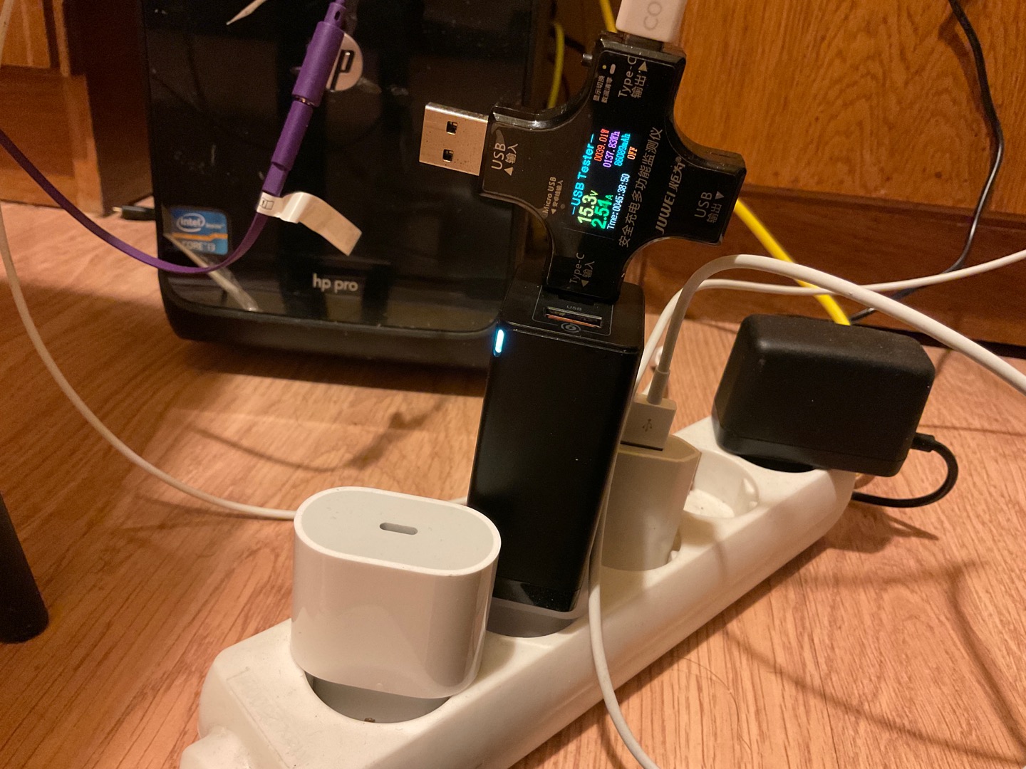

my iPad Pro 12.9 M1 draws 39w power from a GaN adapter of 65w

i use a hub that consumes 15watts so i use this charger. included cable is emarker certified. ive only seen 36 watts form this pro but i did not flatten the battery to less than 10. ill see if i can do that and measure the current to see if i can pull 39 like the above user did.
