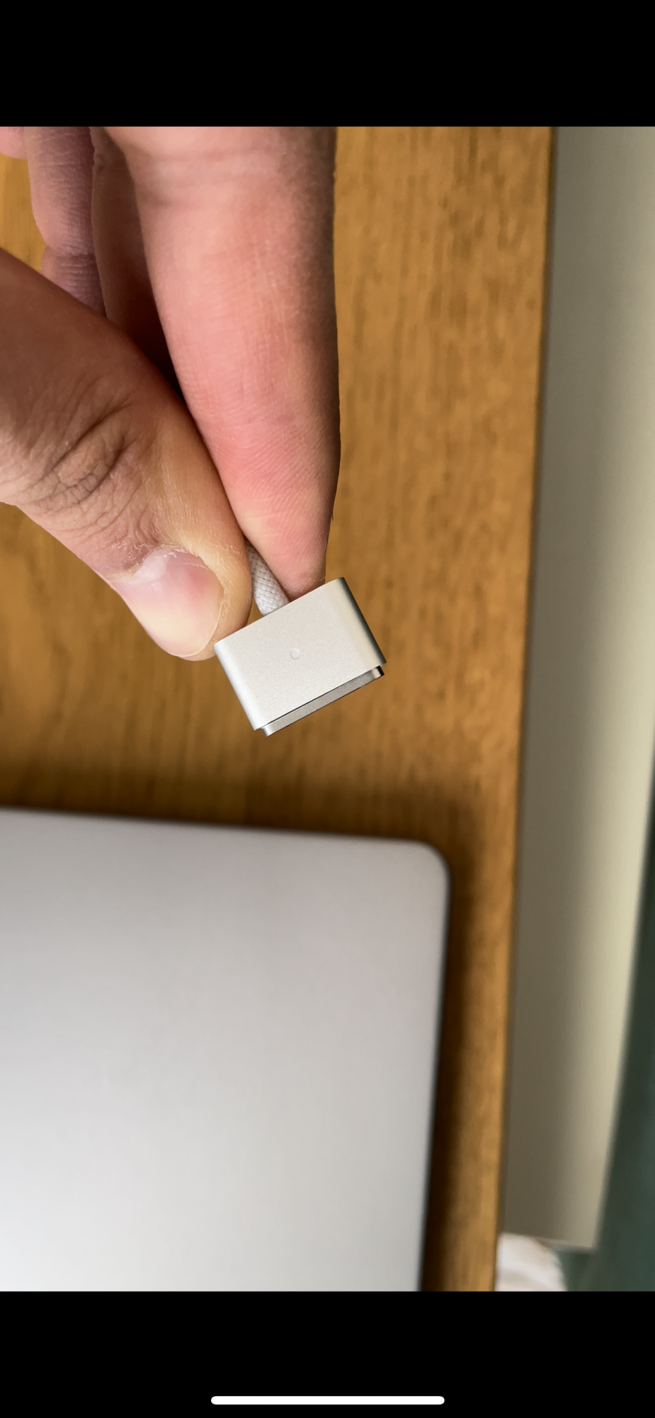

My Magsafe charger is kind of distorted, see the photo I made. Is this the case for you guys as well?
I had also contact with the Apple Support today. I will receive new charging equipment. I will also report after the test with the new charger and cable.
I don‘t think my MagSafe charger is distorted.
Yours seems to be fine. Let‘s hope that the replacment solves the issue.
My MagSafe cable is not distorted.
