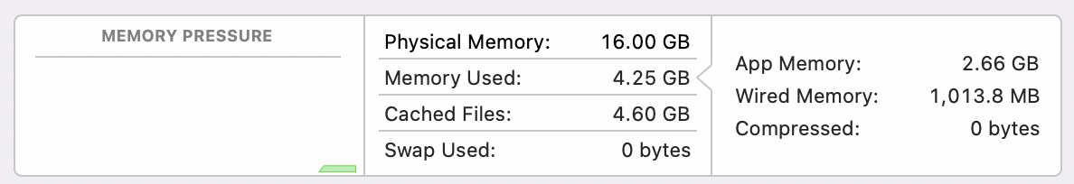

Mine barely ever uses any swap, so no....

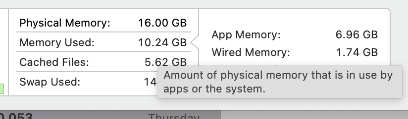

I, too, have a 2021 MacBook Pro 14" (base model).
I decided to take action to prevent excessive disk use on the internal SSD.
Please see these posts I put up in the Apple Silicon forum:
and
and

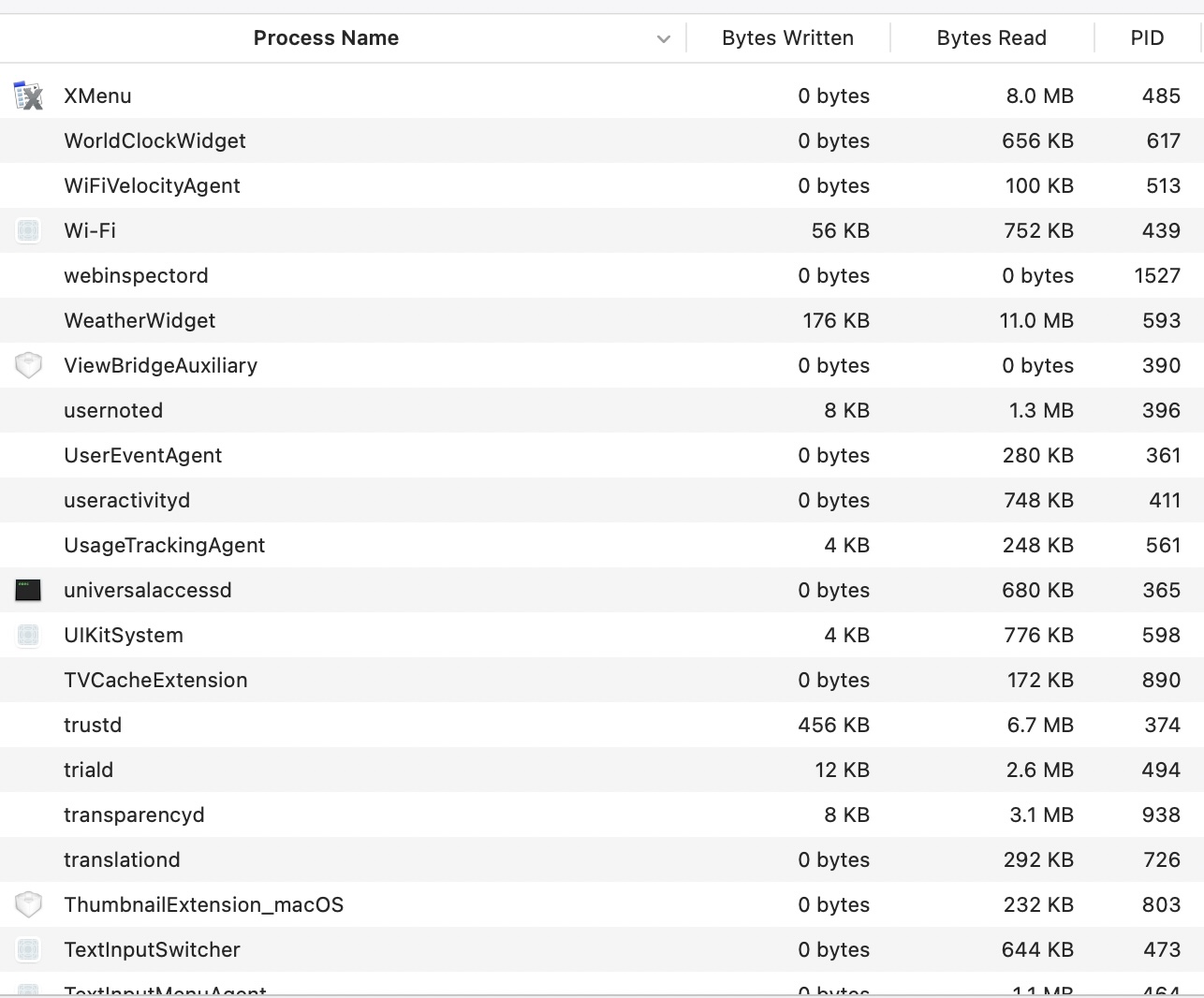

For most users, yes. But, the system can read and write to swap so fast that if the system is thrashing indefinitely, the SSD can wear out quickly enough to have an unexpectedly short lifetime. I've had multiple non-Apple SSDs and SSHDs (hybrid drives) die on me in previous Macs I installed 'em into.
I've learned to keep an eye on mine and take action when it is thrashing, even though the system still performs OK, in order to maintain longevity. The wear level is given by the “Percentage Used” field. That 16% below would probably be 50 or 75% if I hadn't. While it's thrashing, which it can do indefinitely when I have left too much running (normal use for me - bad habits), it's reading and writing over 500MB a second, sustained, thus the nearly one PETAbyte transferred so far. I meant to sign up for AppleCare right after purchase but missed the deadline cuz I was sick. So far it's doing OK, and this is confirmed by SMART info showing no uncorrectable errors:
