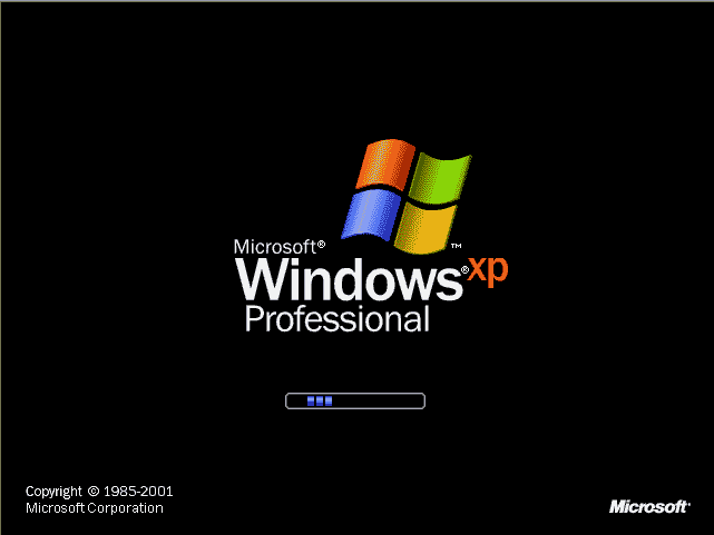

Old Smuggler said:
as long as its not saying "Do-you-want-to-play-a-game?" 😉
Or even worse:
