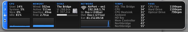

I have a 24" iMac which is just over 12 months old. I noticed recently that occasionally the iMac emits a short burst of grey noise, a sort of hissing which distorts whatever sound is being emitted at the time, (music or whatever). This happens at no particular time and when running no particular program. I have tested it with external speakers and also headphones to confirm that it is not the built in speakers that are causing the problem. The sound burst usually lasts just a couple of seconds. It is not particularly loud and is something I can live with. Anyone had this problem?
Also recently the same machine has suffered from occasional kernel panics. Usually after being on for some time. Again at no particular time or process. If I restart the computer it often panics again. If I leave it off for a while it seems ok, I am wondering if this is some sort of heat issue.
Here is an iStat picture I took after about 20 mins running. The temp I was wondering about was the bottom one in the list.
Northbridge - 55c
Edit: That has now risen to 60c
Forgive my ignorance what are the 2 Northbridges? Are they the ram slots?

Not quite.
And those temperatures are normal for the Northbridge.

There are about 20 panics listed over the last 4 months or so. A reference to "thetube" has come up in several of them. It is software on my system which controls a USB TV receiver. The software has a helper in the start-up items. Could this be the culprit? The panics have occurred when the USB receiver is not connected, but the software is always on obviously.

yes it could, do you get them when the tv dongle is not connected?
Yeah, it has had a panic when USB dingle un plugged. Could the software itself be the problem though?
