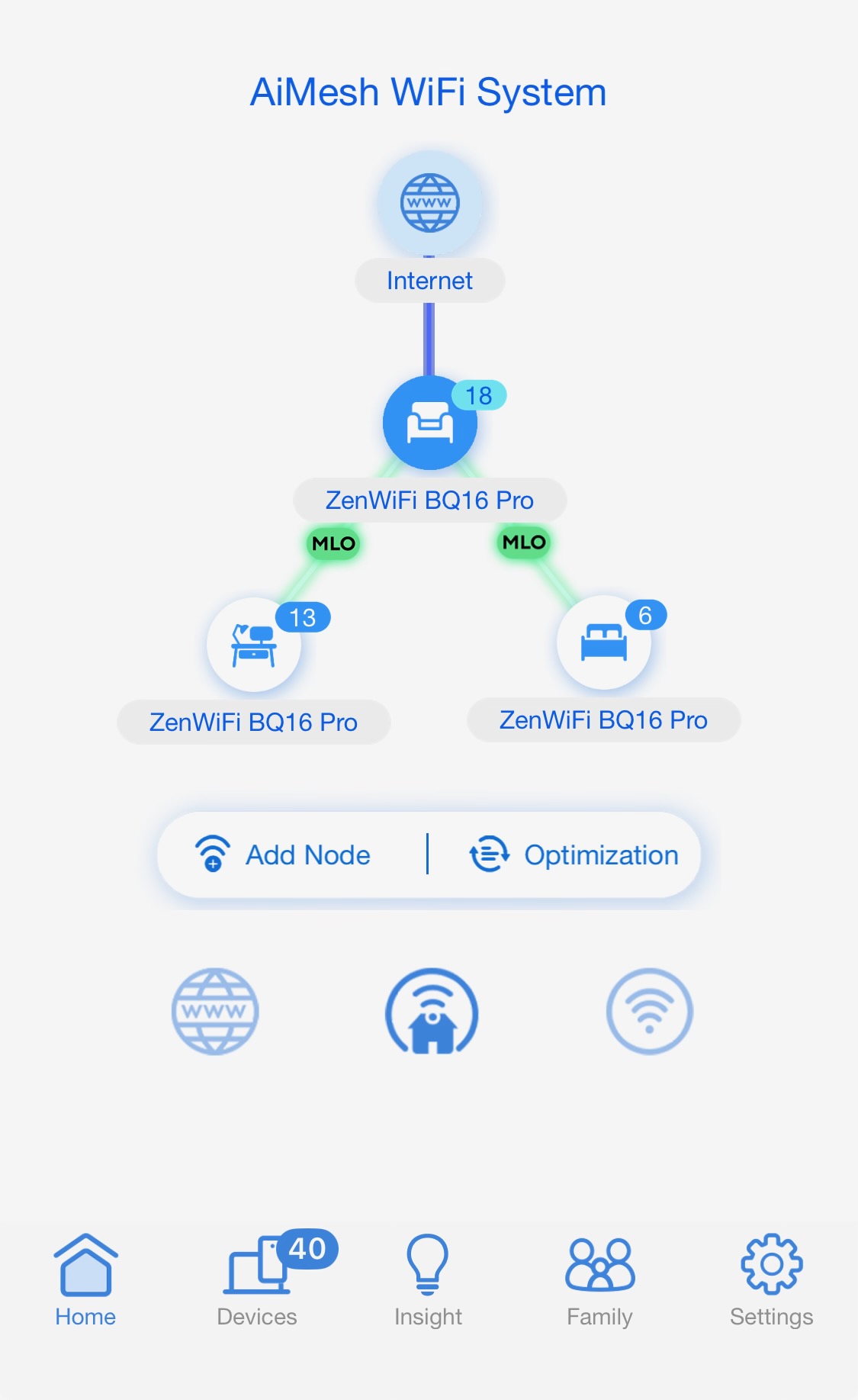

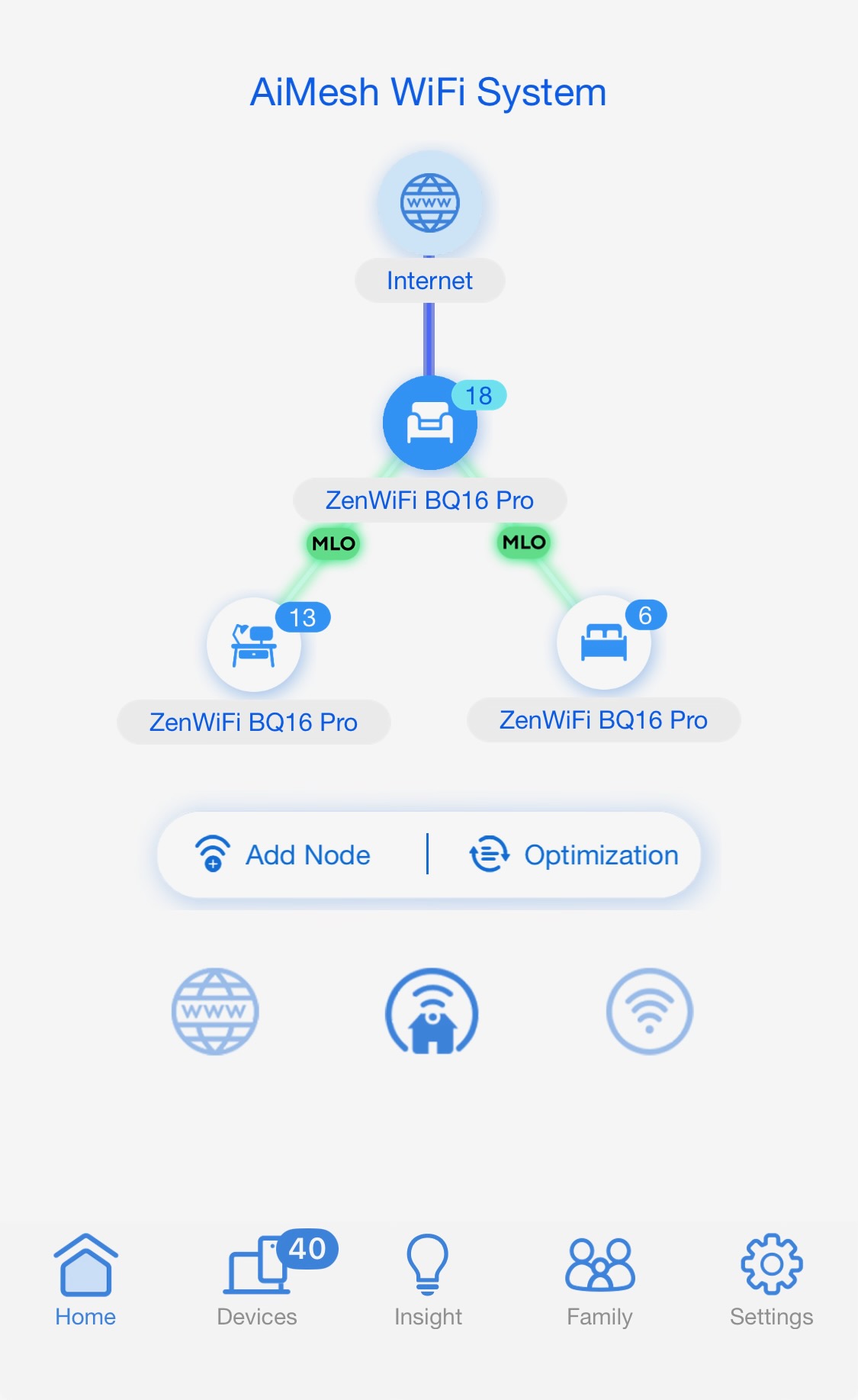

I've been running an Asus ZenWifi BQ16 Pro mesh system for much of the year. It's been stable and functions well, that is, until I added my new iPhone 17 Pro Max to the mix. This is the current configuration:
The 2.4Ghz band is its own dedicated IOT network. The high bands are for WiFi 7. The iPhone 17 Pro Max is the only WiFi 7 device in this system.
Sometimes, I have to use analysis equipment that attaches to the iPhone through the device's private network. Whenever I switch networks on the iPhone, the main router reboots. Every single time!!
