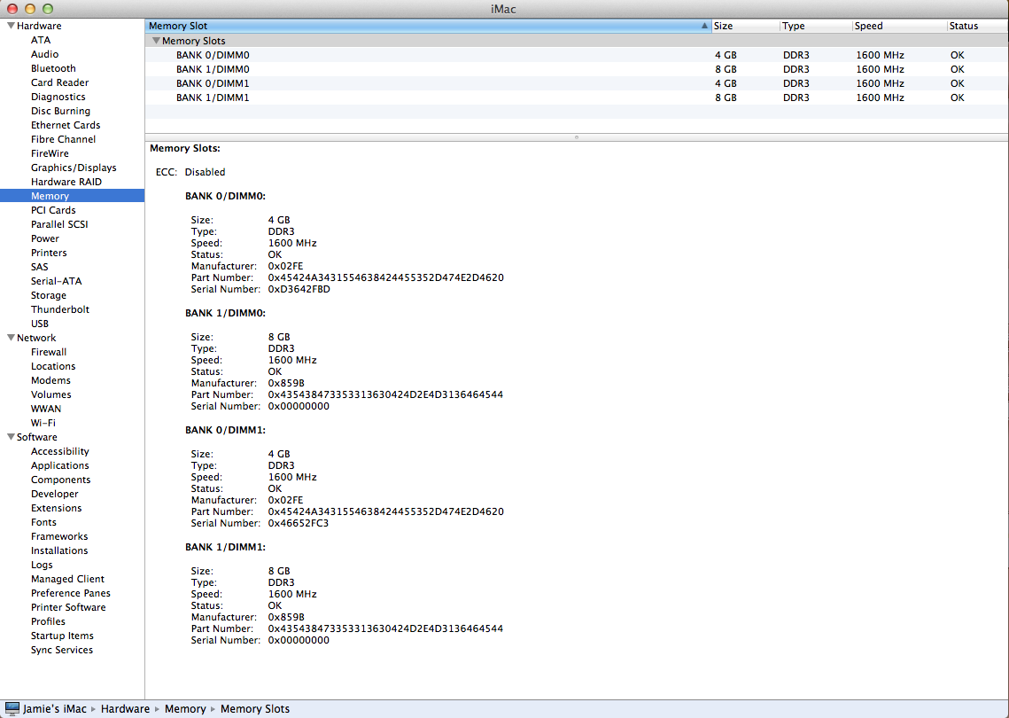

PS how are you guys monitoring the ram speed to see what you are getting?
This is what I did, cant go wrong unless crucials website is wrong..
Apple logo in top left > About this Mac > More Info > System Report > Memory
This will show you the slots used, size of the memory and speed
Great thanks
Yep, mine stating a glorious 24gb at 1600MHz
Out of curiosity, is there any difference with the way i have my slots i.e.
Bank 0 8gb
Bank 1 8gb
Bank 0 4gb
Bank 1 4gb
I'll look when I get home tonight to see how mine are laid out.
Bank 0 8gb
Bank 1 8gb
Bank 0 4gb
Bank 1 4gb
I moved 1 of the 4GB sticks into the other bank before installing mine ... so i have the banks matched .... doesn't make massive difference though
