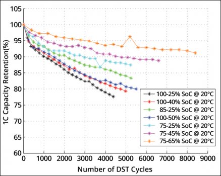

Don't worry about charge cycle. Instead, focus on battery stress, where the stress is high when charge level is > 75% or < 45%. When the battery is stress, it very prone to heat (impacting to battery health). So, plugging all the time is not recommended. Also, use the battery up to close to 0-10% every time is not recommended. The battery should be operated in non-stress condition: maintain operating between 45%-75% and keep in room temperature.

The 75-45 is based on this (taken from BatteryUniversity.com). We can adjust to less ideal obviously, balance with your needs.
