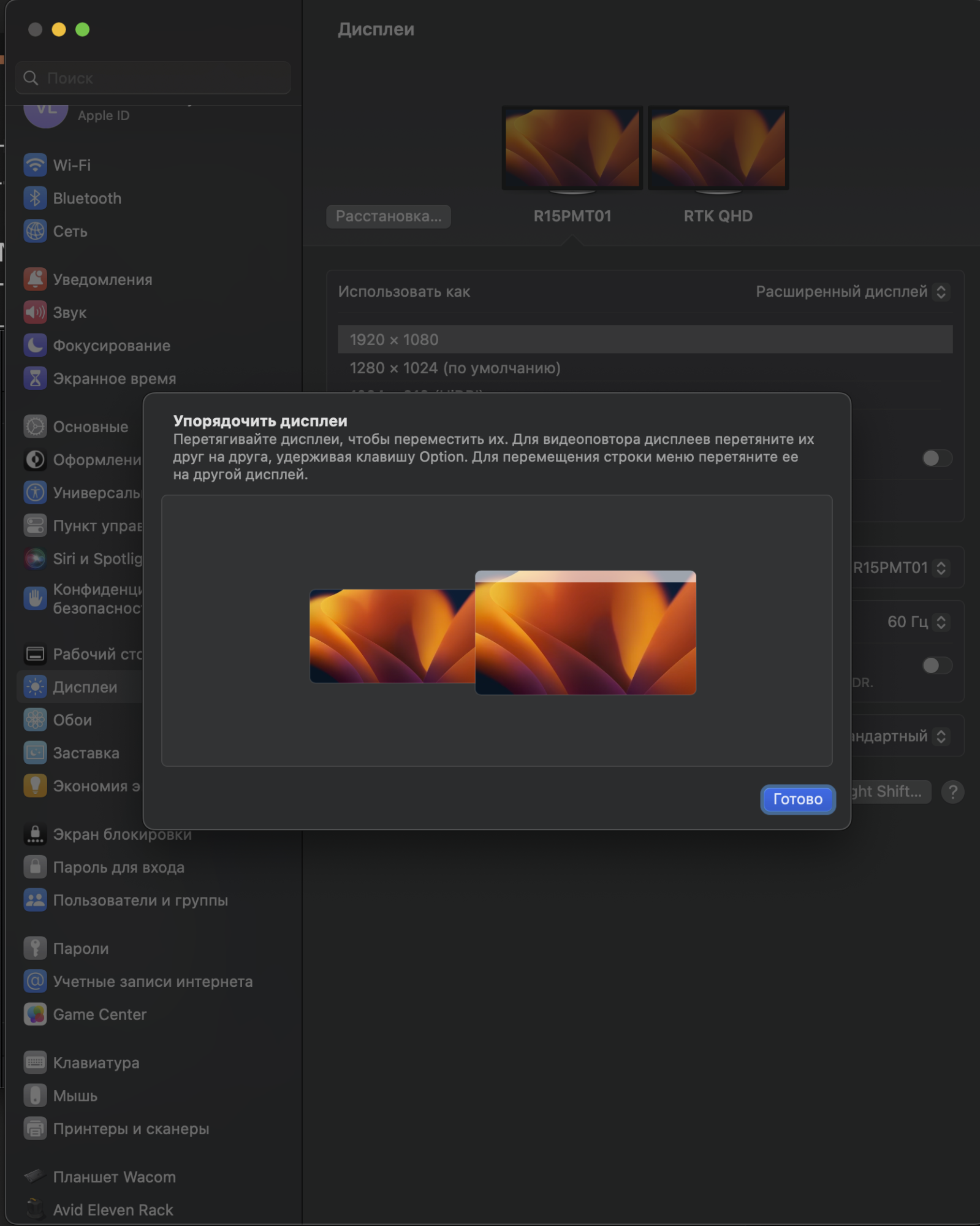

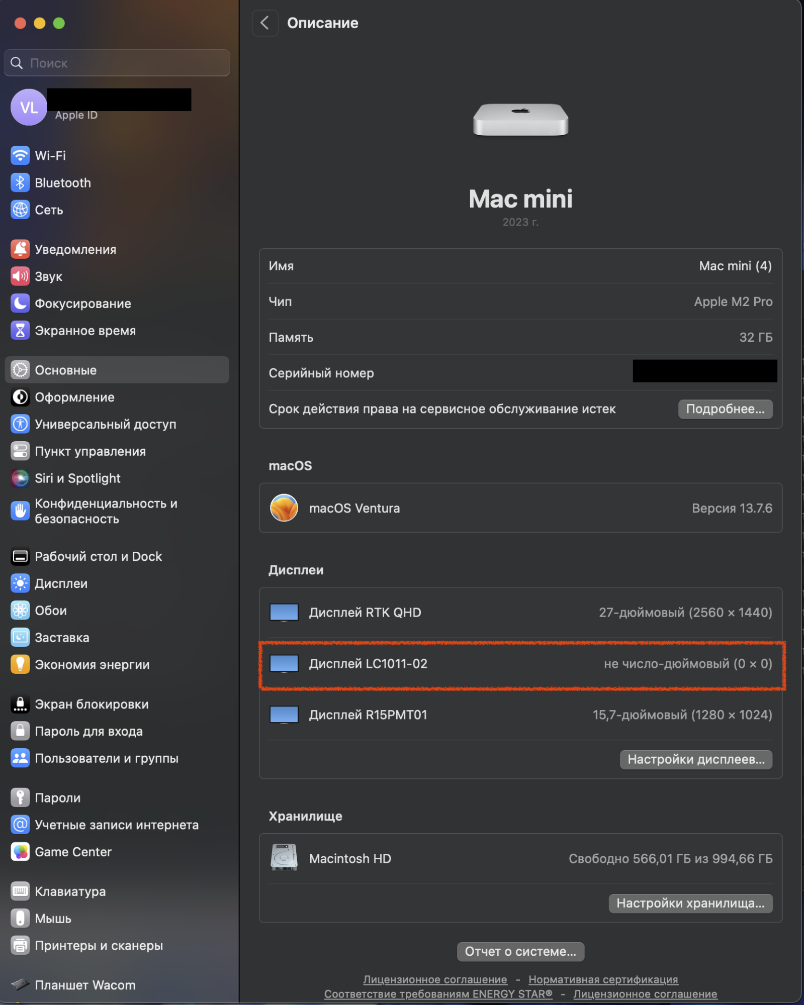

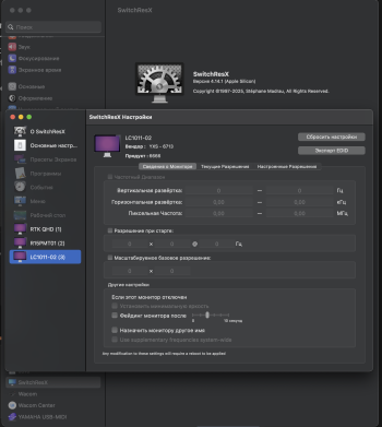

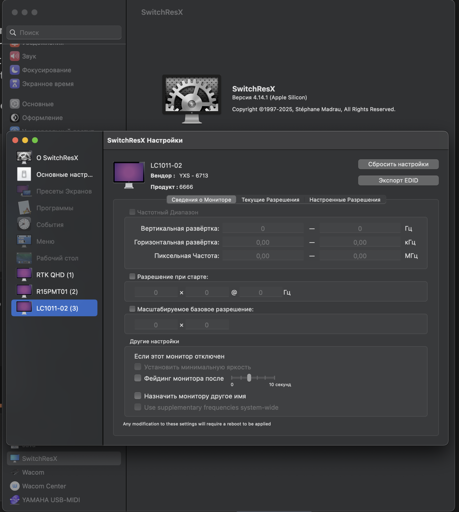

I'm trying to make an additional display for mac mini M2 be recognized (look at the screenshot - display LC-1011-2 11" 1920*440 HDMI-connected. It works fine, but is not displayed in the display settings window. I additionally installed SwitchResX (but maybe in vain, since I only managed to make it display in MAC settings once, by setting non-standard monitor settings... but now I have completely lost these tricks).
Can anyone help? Or suggest a source of knowledge in these manipulations with an additional non-standard screen?

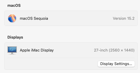

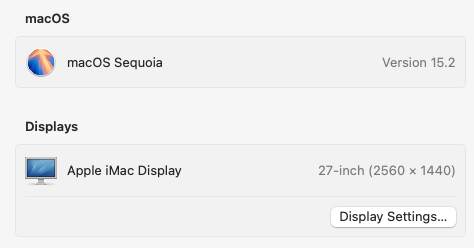

I got back to that iMac 2010 and put a fresh install of Sonoma 14.6.1 on it. TDP no longer works. It appears to flash once but unable to switch to the video source. I did not have to fiddle when it was on Monterey. Cmd F2 worked every time. Would be interesting to know if TDP works in Ventura, now that Monterey is sliding out of the end-of-life window.
I managed to get Target Display Mode (TDM) working on Ventura 14.7.8 (23H730), but it takes 5–30 attempts to successfully switch to the video source.

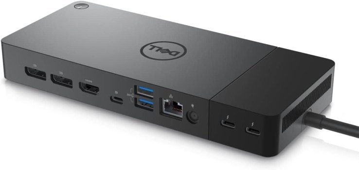

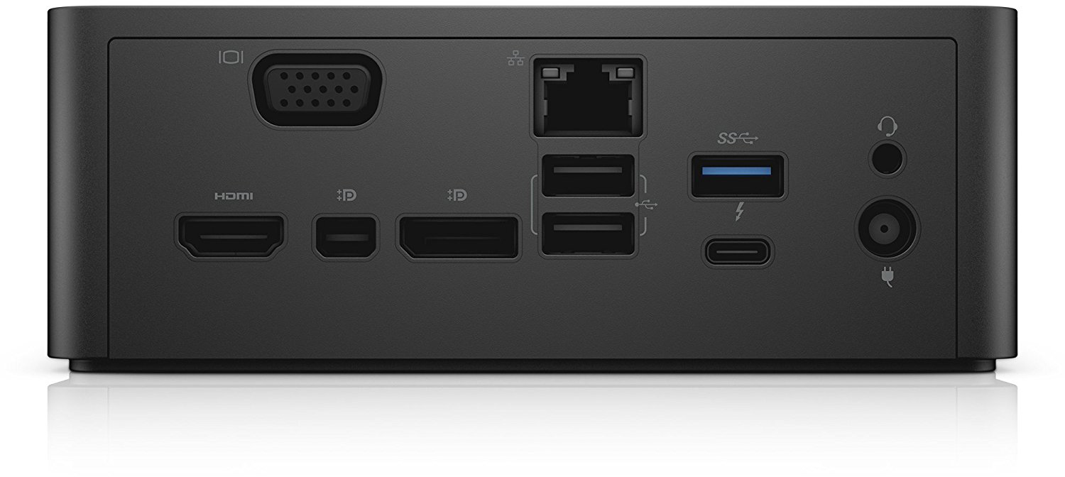

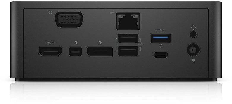

Like this???
Dell Thunderbolt WD22TB4 4 Dock 130W
or
Dock TB16 Thunderbolt 180W
or
Dell DELL-TB18DC - DUAL-C THUNDERBOLT DOCK TB18DC - EUR PRECISION 7530 AND 7730​

Like this???
or
The Dell Thunderbolt dock I have is smaller than those but looks very similar. I've no idea what 'feature' it is which allows it to work - I would guess that those would work identically.
However, as I mentioned, buying a dock just to use an old iMac as a monitor is probably not worth it - a new screen would probably be a better idea: yes the iMac 'screen' works, but it's not as convenient as a 'real' screen (e.g. need to boot the iMac, volume and brightness controls don't work on the 'new' / source Mac, require the iMac to have a keyboard attached, and it uses more power than a plain screen) and a new screen would probably provide a better image for the same / similar price.
I do like the environmental aspect of reusing rather than creating more rubbish / eWaste all the time though.

To turn on TDM:
sudo ./smc -k MVHR -w 01
wait 1 second
sudo ./smc -k MVMR -w 02
To turn off TDM:
sudo ./smc -k MVHR -w 00
wait 1 second
I confirm it works on Sonoma.
sudo smc -k MVHR -w 01
sleep 1
sudo smc -k MVMR -w 02
But the brightness control still doesn't work. The brightness stays at maximum.

Just wanted to share that on my iMac 27" 2010 running macOS Sonoma, the process differs slightly from what you described. Specifically, I have to use the MVHR key as a toggle and the brightness logic follows a 4-digit hex format where the first character represents the 16 native macOS brightness steps.
Adjusting brightness for me requires stopping and restarting the mode in this exact sequence:
To enable/change brightness:
sudo smc -k MVBO -w 5fff (where '5' is the brightness level from 0-f)
sleep 1
To exit:
sudo smc -k MVHR -w 00
sleep 1
sudo smc -k MVMR -w 01
The main difference is that 0fff results in minimum brightness for me, while ffff is the maximum. To get around 30% brightness, I found that 5fff works perfectly. It seems the controller on this model/OS combo strictly ties the first hex nibble to the 16-step backlight scale.
