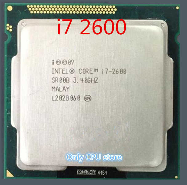

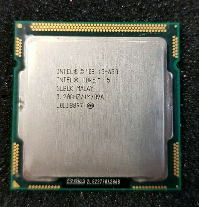

cut outs different...
You are a real genius here.
Try to fit a CPU designed for LGA 1155 slot to a LGA 1156 slot.
Read the manual, specs, model number (printed under the aluminium base) again and try to do it right.
Base on the core i5-650 photo, which is supposed to be original CPU in your iMac, yours is a 27" mid-2010 iMac, not a 2011 one.
