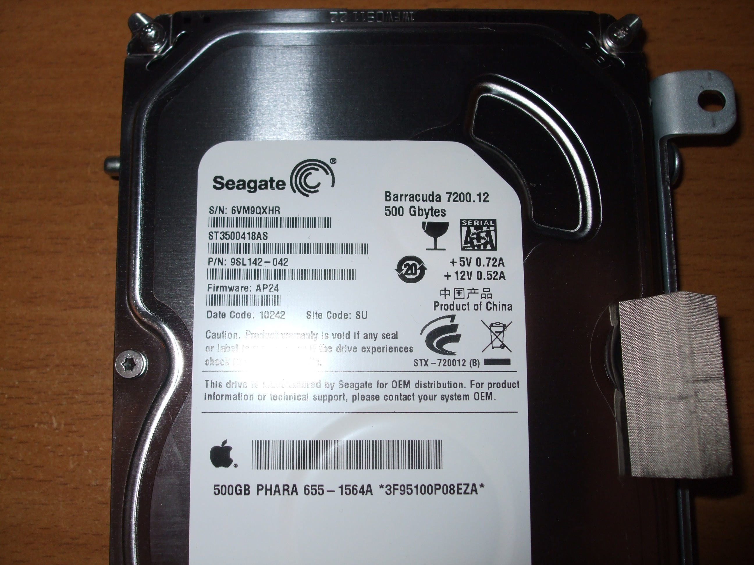

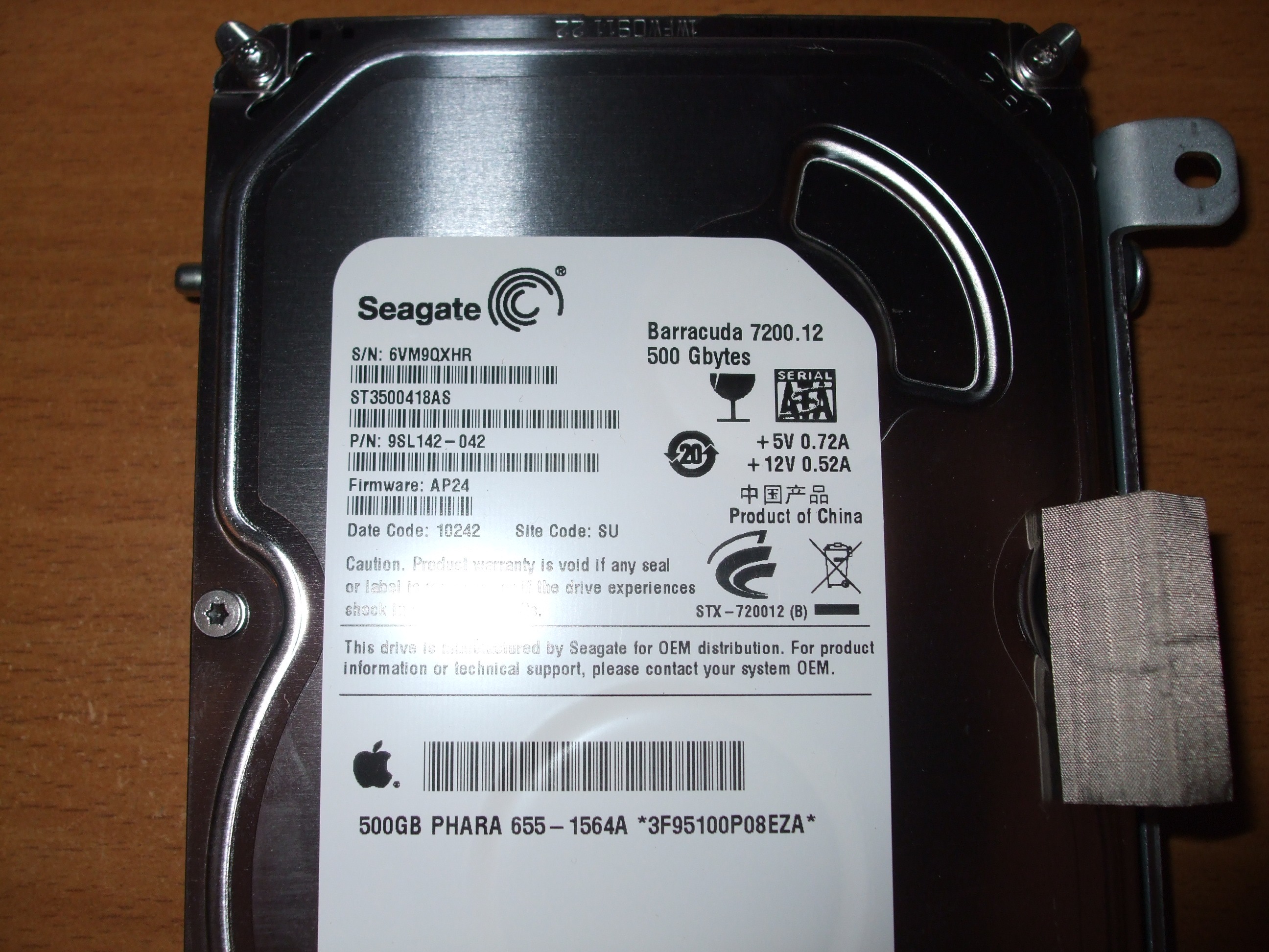

If the Original Hard drive in the iMac is replaced then you will notice the fans get up to a high RPM very quickly and will stay at this level. This is due to a Tempreture Sensing cable attached to the original drive, at present most people simply short the cable with a peice of wire. I personally wanted to find away around this....
The Seagate Drives that come with some iMacs are standard Barracuda Drives, i.e the connection at the bottom of the Drive for the Temperature Sensor will be on the same Model range (500GB, 1TB, 1.5TB and 2TB) The only difference is the apple firmware and the sticker on the drive. For some reason Apple has added a Q to the drive model under System Profile (About this Mac, more info). The sticker on the drive does not have the Q and uses a standard Barracuda model number.
This means that the Drive can be swapped for a larger drive without shorting the temperature sensor.
I'm sorry to have to correct you here, but there is a definite problem with non-Apple drives in the new iMacs. Even when replacing it with a new drive of the same sort, the issue with high RPM on the fans persist. We tested with putting a WD Green 2TB drive in a 27-inch, the drive originally had a WD 1TB Black. The jumper pins look exactly the same, but does not offer the same function in the third-party drive (not Apple branded). I believe the temperature sensor HAS to be shorted if you want to use a third party drive.
