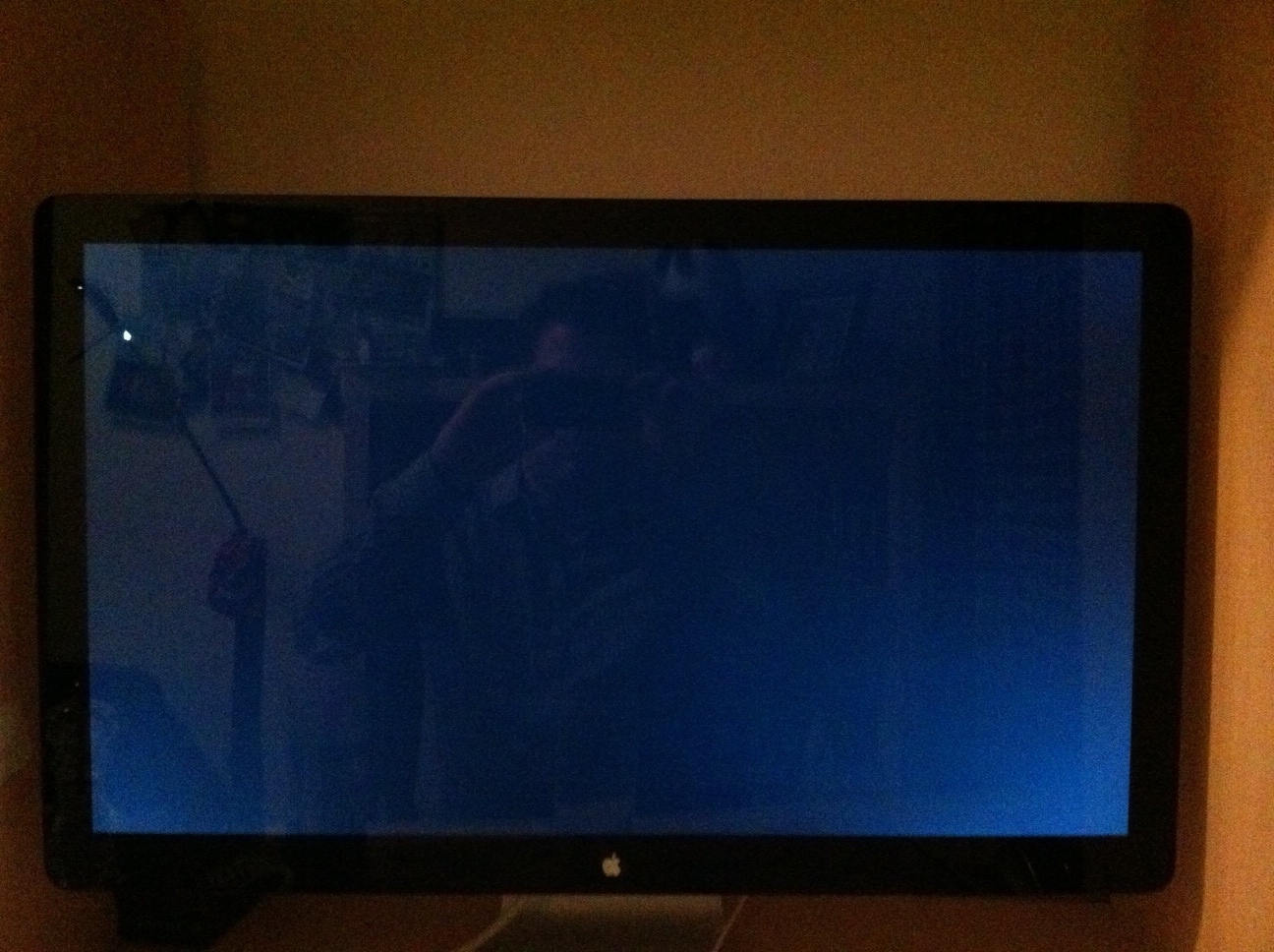

You can see from this picture that the corners, especially the lower right one it "leaks light" on this black image on the screen.
Although I find that quite extreme, I think its normal. Some people exchanged their 27" displays a few times and didn't get a better display.
However, you can always try to get a replacement. Shouldn't be a big deal in the store.
There is a simple way to test if the light in the corners is normal or not:
1.) When you stand further back from the display, does it diminish/disappear?
2.) If you move your head from left to right, does the size of the light leakage in the corners change?
If you answered yes to either of these two, then the light you see is part of the IPS glow, and not backlight leakage. In other words, its normal, and every other ADC you replace it with will have the same issue. If the light does not change no matter what you do, then you may have backlight leakage, and you might want to consider returning the display.
hmm yes it does change so i guess its normal then.
it really doesn't annoy me that much i only notice it on the sleep screen (and thats black). but good to know there is notting out of the ordinary with mine.
its a little strange that apple doesn't apply this polarizer since this is a premium display, but oh well.
thx for the info 🙂
