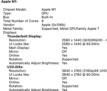

My setup is the 27" TB desktop / main display using the above $49 adapter on the TB3 port of the M1 Mac Mini.

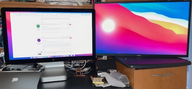

Here's my M1 setup with the second display - direct HDMI connected 4K Samsung as an extended display:

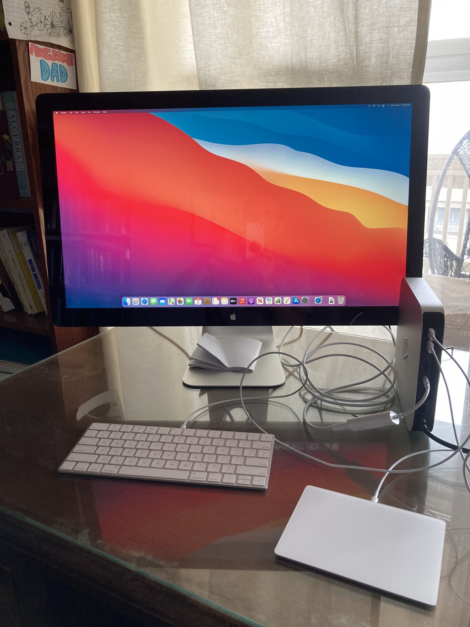

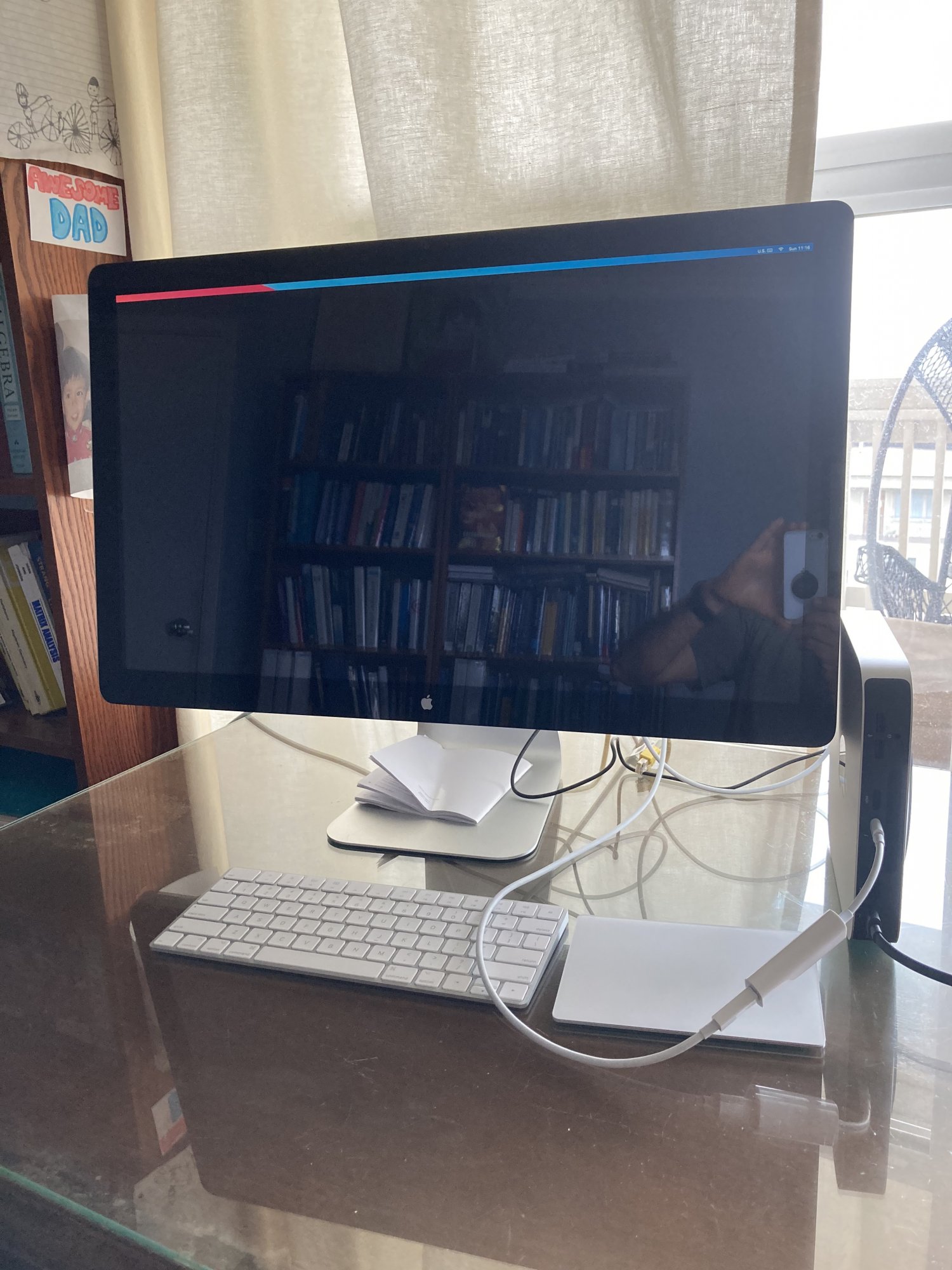

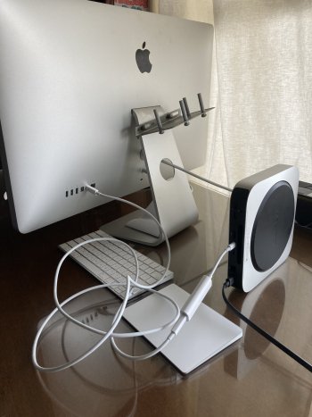

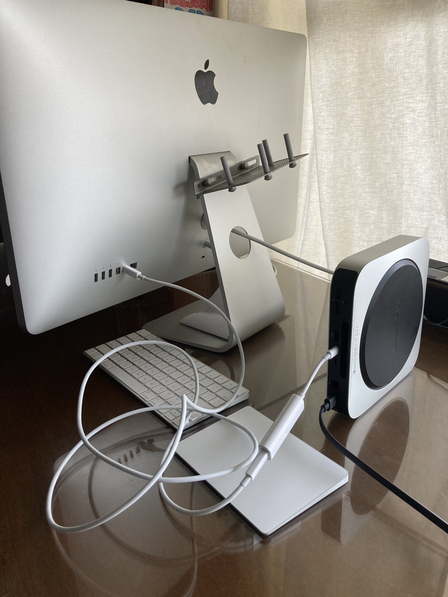

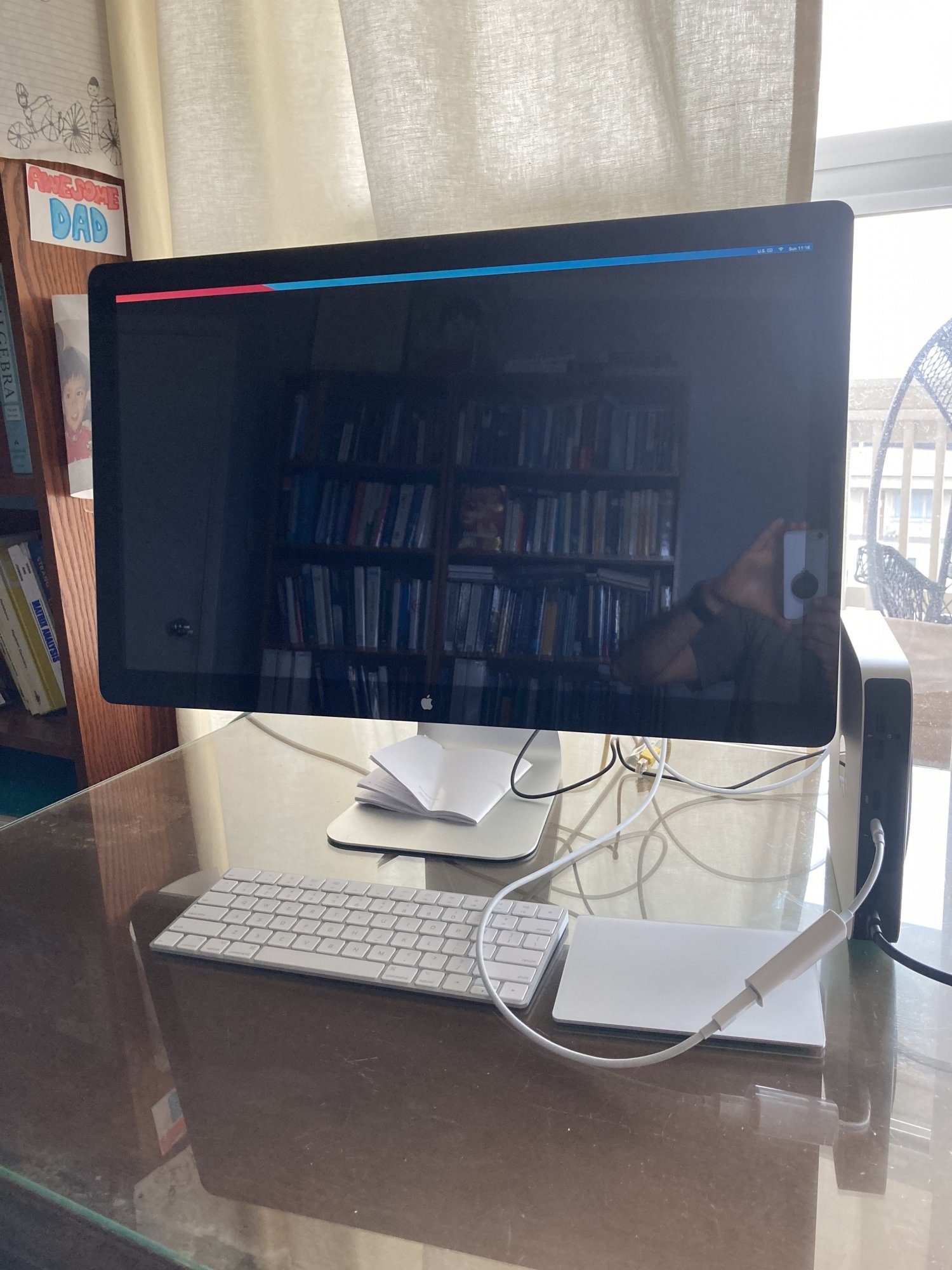

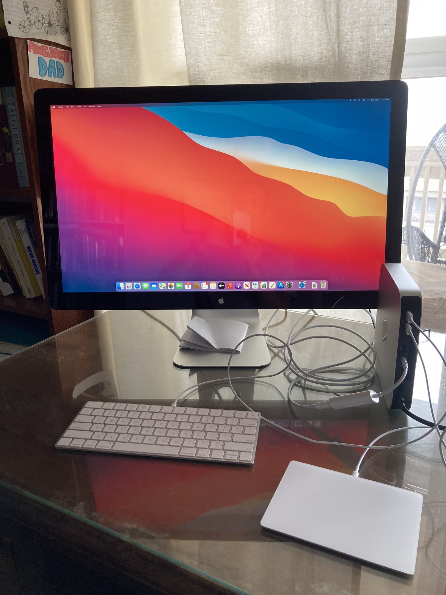

Thank you 4sallypat for your reply. Yes I am using the Apple TB3 to TB2 adaptor you have described. The third picture attached shows the back of my 2013 27'' TB2 display with TB2 cable to Apple TB3 to TB2 adapter to my new M1 Mac Mini (16GB memory 256GB storage). I also have an Apple magic keyboard and track pad. The 2 second picture shows everything working before I touch the track pad (The trackpad causes the screen to turn black). The first picture shows the screen is black (except for the menu bar at the very top of the screen) the instant I touch the track pad. Any ideas what is going on here? I will return my M1 Mini if this doesn't resolve in a couple days.
Does it also happen if you try to use the trackpad while in diagnostics mode? If it works there then it would pinpoint towards a software issue rather than hardware.
