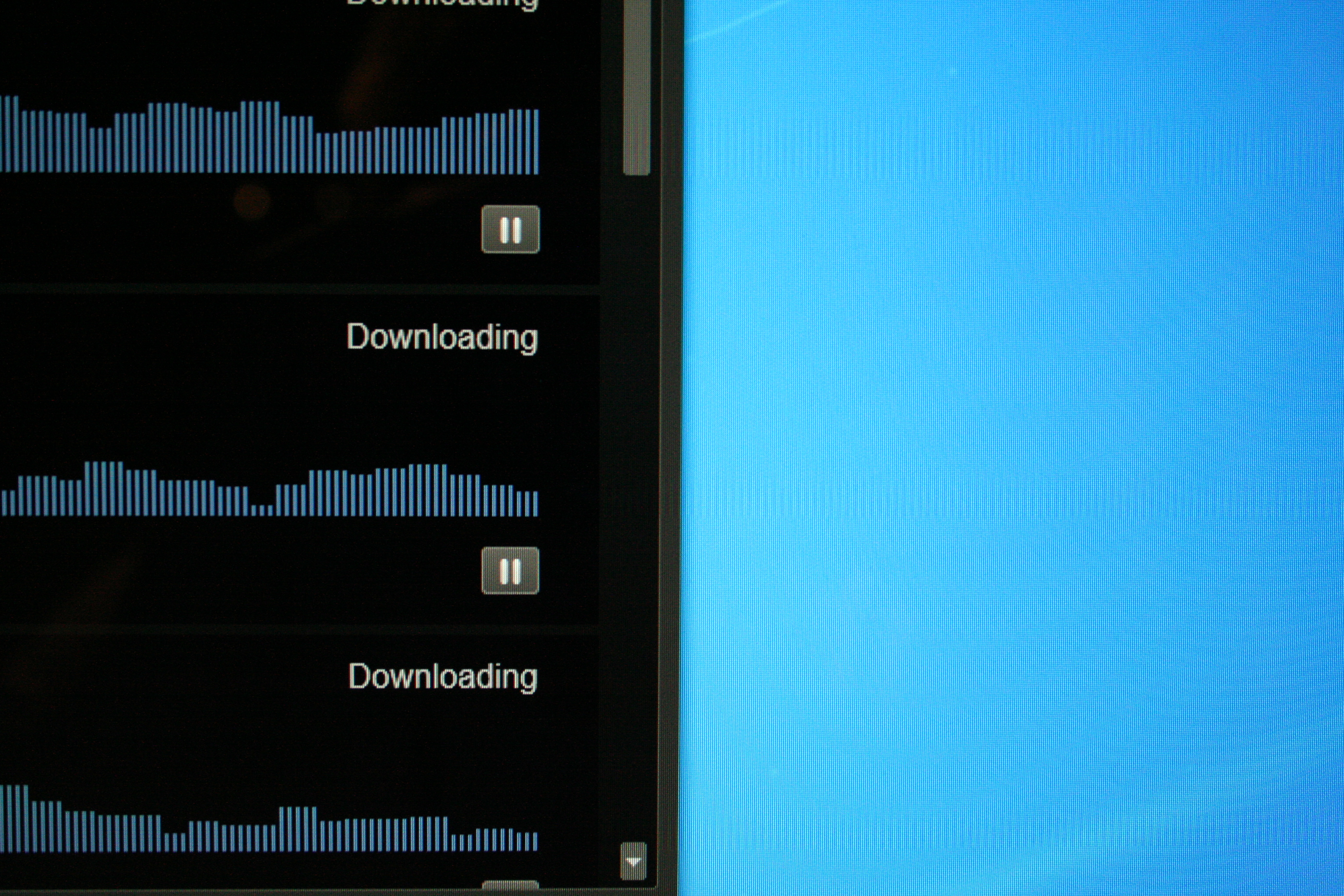

Picked up the 27" high-end stock iMac yesterday. It's mighty beautiful and damn powerful too (runs all my games on max and never dips below 60fps!) Problem is as it was downloading those games I noticed some display artefacts and I was wondering if other users could view this screenshot and tell me if you get the same problem as my photo;

The blue graph lines seem to repeat over onto the blue background. The screenshot produces the same effect under Windows 7 as it does OSX. There are no other problems, as I said games (TF2, L4D2, Portal 2, Burnout Paradise etc) all run totally fine.
If it's a common problem then I'll just stick with it. Else I'll make use of my Apple Care and take it back. It's the only thing that's dampening this brilliant machine 😱.

It's not that, if you zoom into the screenshot or move the image off the side of the screen (or just cover up the graph lines) then the glitch lines disappear. I've viewed this screenshot on my iPod and PC to test it out; they don't have the lines.

The screenshot is what the GPU is pushing out so that'll bypass any display issues. If you see the glitch lines then you've got the same problem.
The photo is what my monitor displays.

I've been quite bad at explaining this so I'll try again 😱
When I run the application and view those download bars, they spread out over the app. (Under Windows 7)
I took a screenshot to see if it was a display issue so I could view it on my other machines.
On other displays the screenshot does not have those glitch lines. But no matter what OS I'm in if I look at the screenshot I see glitch lines (like in the photo I took).
+If I zoom into the screenshot the glitch lines fade.
+If I move the screenshot off the size of the display (so the real lines are no longer in view) the glitch lines fade.
It's not the application (Steam). That's the only thing I can be sure of.

Those look like some sort of ghosting effect induced by the high contrast pattern in the download progress bar in steam. The more of those line you have on the screen, the more pronounced the ghosting effect is. Try moving the steam windows sideways, away from the screen and the ghosts fade away.

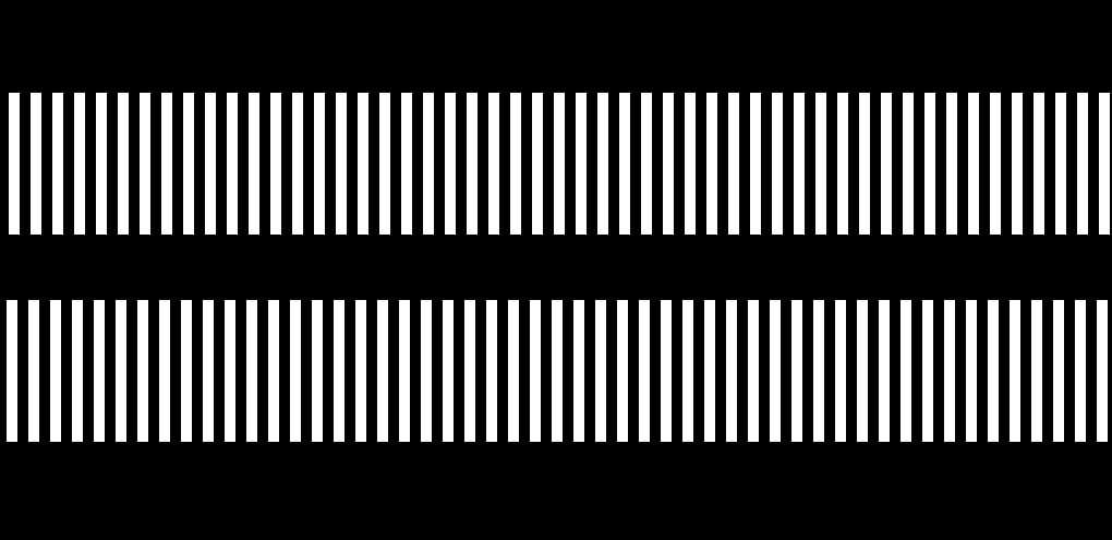

Made a test image :
attachment.php
Never noticed this before. I'd like to know how many external display have this issue. (not necessarily the iMac)

No, when you make a software screenshot (like with Preview), the lines are not in the image. (when you zoom you see that there is no variation in the background color).
Just had a look at the screenshot image above (...Capture.png) rather than the photo and I get the vertical lines moving across the Win 7 desktop blue outside of the Steam window.
I then dragged the browser window across to my 23" and the vertical bars disappeared. No refresh, just no there on the 23" ACD but they are there on the 27" ACD. When having the image split across the 2 displays the bars are there on the 27" and then disappear on the 23".
I jumped to my conclusion above a little quickly but am now really intrigued????
Presumably this has this do with the way the 27" ACD processes the signal coming from the GPU for that combination of blue and the high contrast bars in the Steam window???

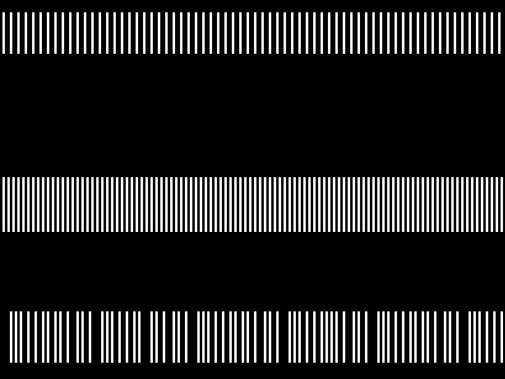

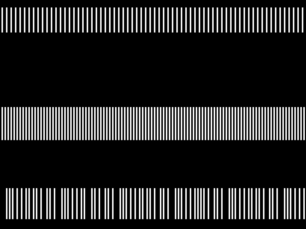

I have tried to create different pattern of black and white, they all don't make the "ghost lines".
1st line : 1 space white, 2 spaces black, 1 space white, etc...
2nd line : 1 space white, 1 space black, 1 space white, etc... (like my first one)
3rd line : irregular pattern.
None of these give any problems with my displays. I did notice however that the aliasing pattern happening with the .png image supplied above not only gives the lines across the remainder to the image in the browser window but also across my OSX desktop background all the way to the edge of the screen (more apparent in negative contrast mode, Ctrl+Option+Cmd+8).

The magic number is 2px by 2px.
