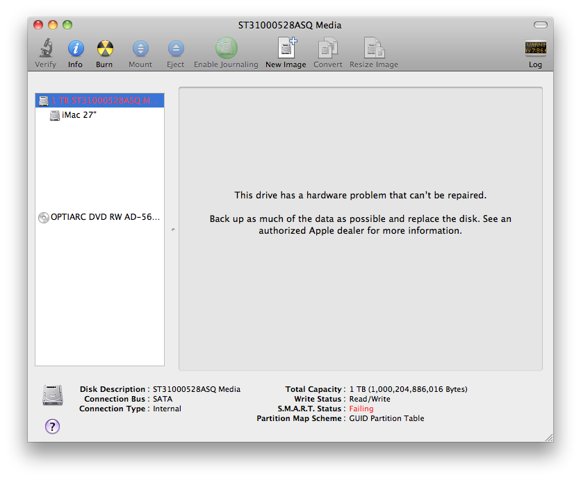

Did a Disk Utility open to try to mount an external drive and low and behold the internal 1TB drive in the 27" iMac was in red highlight - saying:
This drive has a hardware problem that can't be repaired.
S.M.A.R.T. Status: Failing
What is the MTBF (Mean Time Between Failure) on these drives installed?
I do use this iMac for watching TV, using EyeTV with a 20GB buffer, but would have thought the drive would be able to handle it. Its not on 24/7, about 4-5 hours a day on average, then movies on VLC for another 2-3 hours.
I do have care so will be covered but what's your thoughts on EyeTV on this machine, too much for the drive to handle?? or should be fine and not an issue. 😕

I doubt it's the TV tuner. It's a hard drive and sometimes they just fail. I assume u backup regularly so it's a non issue and you'll take it to apple for repair.
