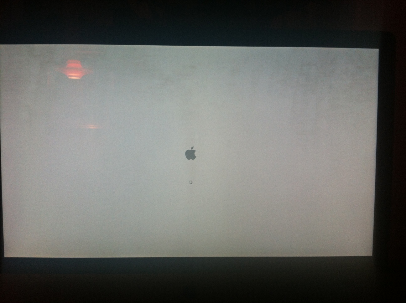

Hi All
Bought a refurb i5 2.66ghz 27" at the end of last september, had to have the screen replaced about a month and a half later, now the marks in the top left corner have reocurred in the same spot. Is this a problem from heat from behind the lcd or what is it ?
also has anyone successfully had their imac swapped because of this issue ?
Im just about to have the display replaced for the 2nd time
picture below
all advice and help appreciated
Uploaded with ImageShack.us
This seems to be an issue which is starting to appear for iMac users who have had the system for a while - there has definitely been an increase in threads / posts in the last month or so. In an increasing number of cases Apple seem to unfortunately be claiming "environmental issues" with respect to the location of the computer and claiming it's not covered by their guarantee - what are we meant to be do, keep the iMac in an airtight bubble? Personally I believe it's a case of an under engineered chaisis - combination of heat dissipation and dust being sucked up by the fans which enter the LCD array from the rear - possibly if they had fully isolated the screen component from the computer / fans it may have prevented this issue. Unfortunately Apple's pursuit of the slimmest all-in-one seems to have consequences.

its twice happened me after a month and a half on each occasion,alot sooner than the other posts ive read

Like I said on another thread, of the 5 iMac 27 i5's I returned three of them had this issue from the outset, also light leakage has been an issue on all of them.
Needless to say went for a refund and waiting what a refresh brings on the iMac but I am also looking at the mac mini once that gets a refresh with the 27 inch display as I have not heard about any issues relating to the display.
After reading alot about this my impression is that this has been affecting some imacs the last few years. I think like many others it's because of heat from the machine (esp. the GPU) or direct sunlight. I think the higher performance and bigger screens have shown the iMac design to have a flaw. Using smcfancontrol to keep the temps ok should prevent this from happening if it's just a heat issue.
I'm really interested in knowing how the environment temps are, and how exposed the screen is to direct sunlight, which according to many articles is very bad for the iMac.

If I understand correctly, the GPU is what generates all that heat in the upper left hand corner of the iMac, the same location where most people experience screen discoloration. (FYI, I've had the screen replaced once for discoloration and it's starting to show again)
just brought my imac back to the store to have the screen replaced, every 27 inch imac in the store was suffering from the same problem/marks on the screen
sales assistant got rather tongue tied when i asked him what the marks where
I went to my local apple reseller today, who almost only sell apple products. None of the displayed models had any issues with the screen, I checked for everything. I also spoke with a guy in the service department about it. He said the yellow tint thing was fixed in august after a major wave of problems. He wasn't too busy fixing iMacs nowadays. The models before that has some kind of film in the screen, turning parts of it yellow if the machine is handled rough (shipping for instance).
He had seen some cases of black dots like described many times on this forum, but according to him it is very unusual - especially if purchased recently. He also said that if such a thing would happen to your screen they will change it no questions asked. In Norway they do this for 5 years after purchase.

This is a very bad design flaw in the panel: the panel's edges are not sealed, and dirt creeps between the polarizer (I think) and the lcd panel. Apple started recently to replace those screen (sometimes, when they can't blame it on the user) with a new panel with sealed edges, but all owners of an affected iMac without a warranty are left out in the cold.
