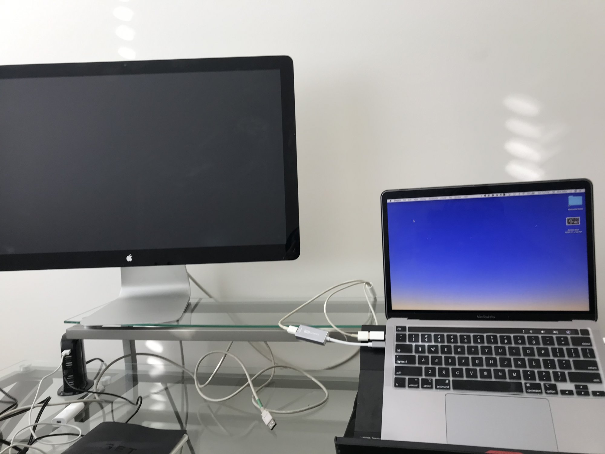

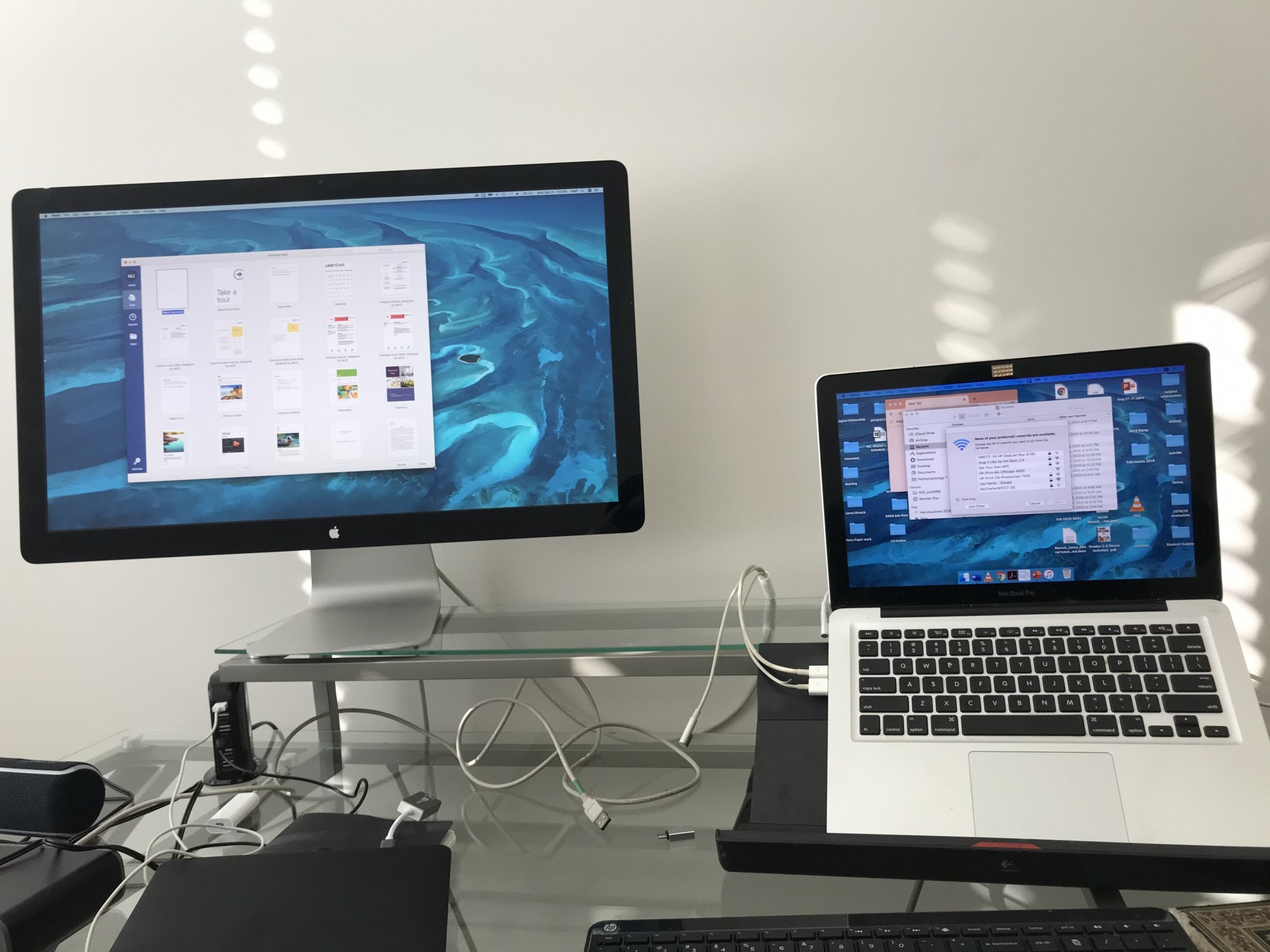

I'm trying to use a 27" Thunderbolt 2 display with my Macbook Pro 2020 running Catalina. I have the Thunderbolt 3 to Thunderbolt 2 adapter. Getting nothing. Nada. Not even a sign that the display is plugged in.
The display is definitely getting power as the USB ports on the back are charging my phone. It also works fine with my Mackbook Pro 2015, which requires no adapter.
So it's either
- bung TB3 to TB2 adapter.
- something else.
I've reset NVRAM and SMC.
Anything else this could be before I take a trip to the Simply Mac store?

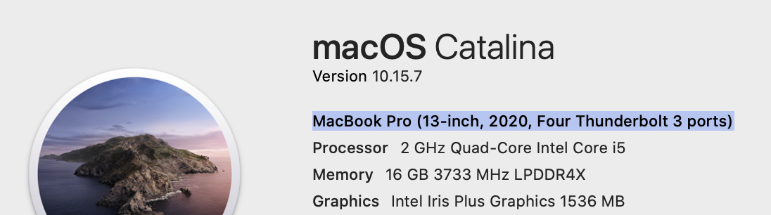

Hi all - thanks for the replies. It's a 2020 Macbook Pro running Catalina.
It may be a bung adapter, I'm heading to a Simply Mac store today to test it out.
@poorcody thanks for that advice, not sure how to check if the ports are sending data?
Anyway, off to the store I go to see what's up.
Well, you are using an Intel Mac, so it should work.
The first post wasn't clear about it.

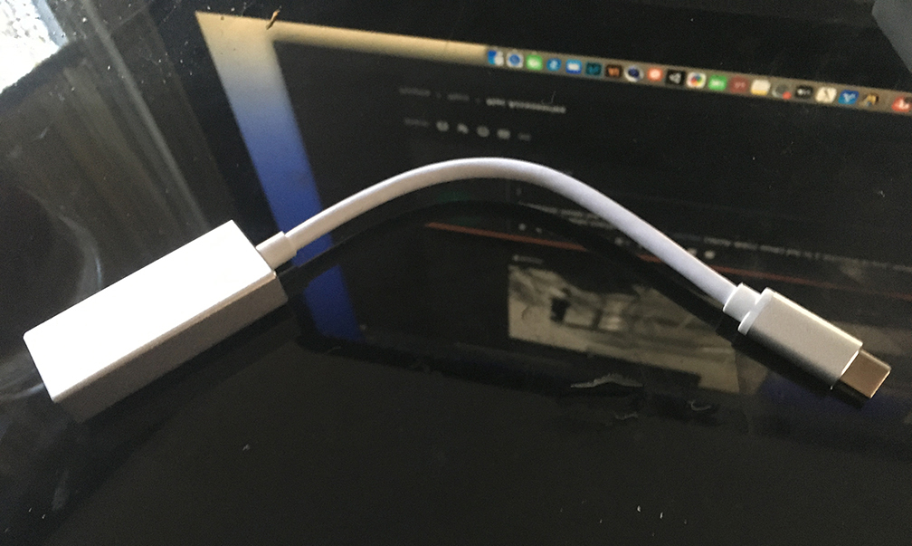

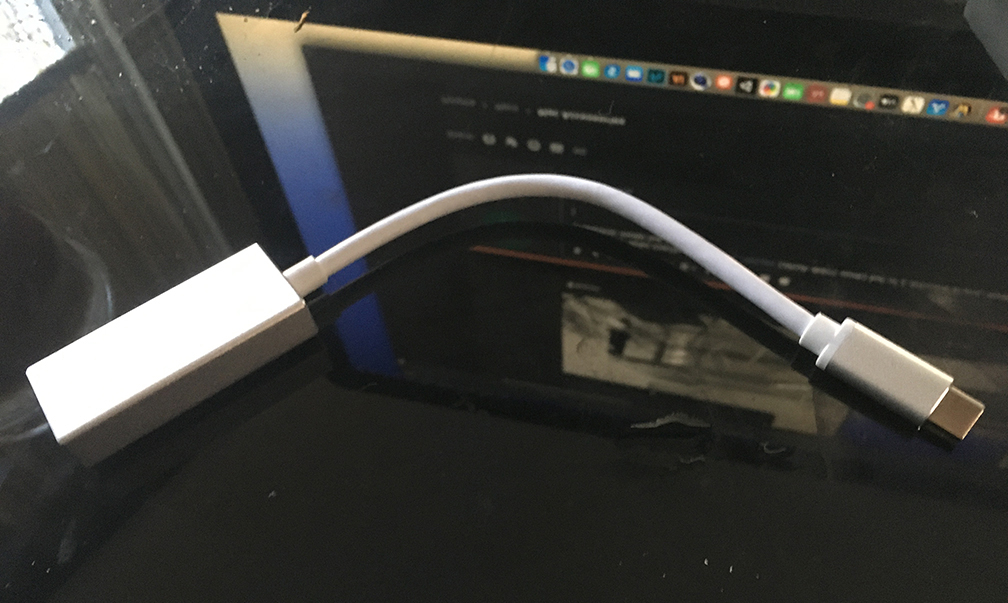

Justashooter - yep it's actually a Cinema display, I got a mini DP adapter instead. Still no bueno unfortunately.
Which adaptor did you get so we may avoid it? In the thread i linked above a user has reported that the Choetech one works, although some photo proof would have been nice.
Your adapter looks exactly like mine (which didn't work) but of a different brand, must be the same production model but rebranded. So to people in the same boat, don't buy these i guess.

Hi all - thanks for the responses. Problem solved and the Cinema display is working great.
The Itanda adapter turned out to be a dud - link
This JSAUX adapter for much cheaper is working great - link
