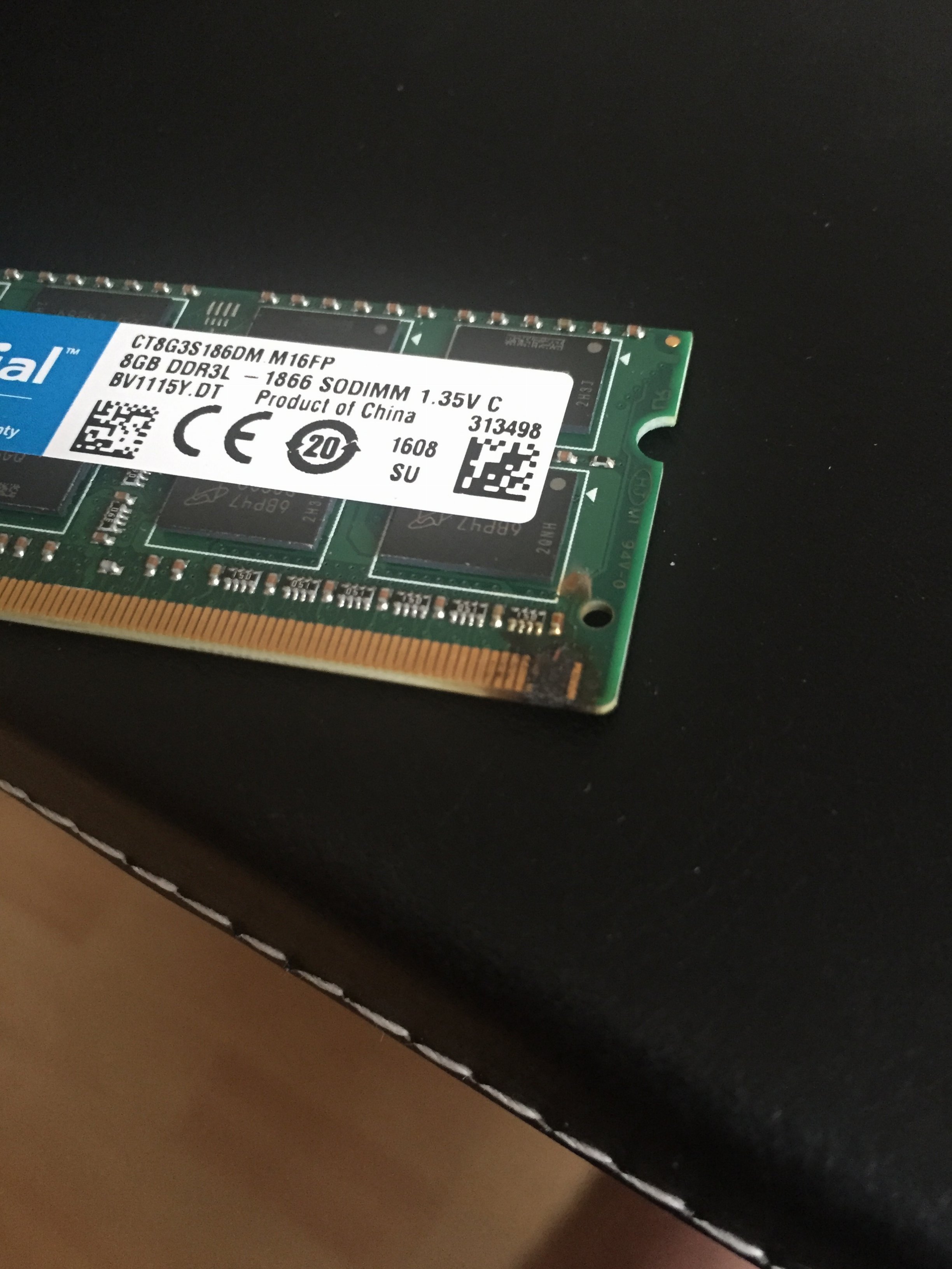

So turns out the left hand side of the top bay won't fully be pushed. But when I check the stock ram and crucial ram it's not normal that the edges are burnt right?!?!

Definitely.
Take your iMac in for service. It's likely that your iMac RAM slot is now damaged.
That might happen if the RAM stick was not seated correctly, then you tried to boot with the stick "almost" seated.
Just a small burn mark there, but may have damaged it enough so you can't boot until it is repaired.
It's not just that one stick, it's 3 of the 4. Like I say the only reason I noticed was because I only had two installed and when checking my iMac version noticed one wasn't recognised.
Seriously, I love apple but I've never had as many problems as I have done in the last few years with their products.
If the burn spot resulted from a mis-seated stick, and you got flash damage at boot, then you may have blown out the memory controller, or at least the slot interconnect. Anyway, you probably need to have the logic board replaced (unless you are very lucky... )
