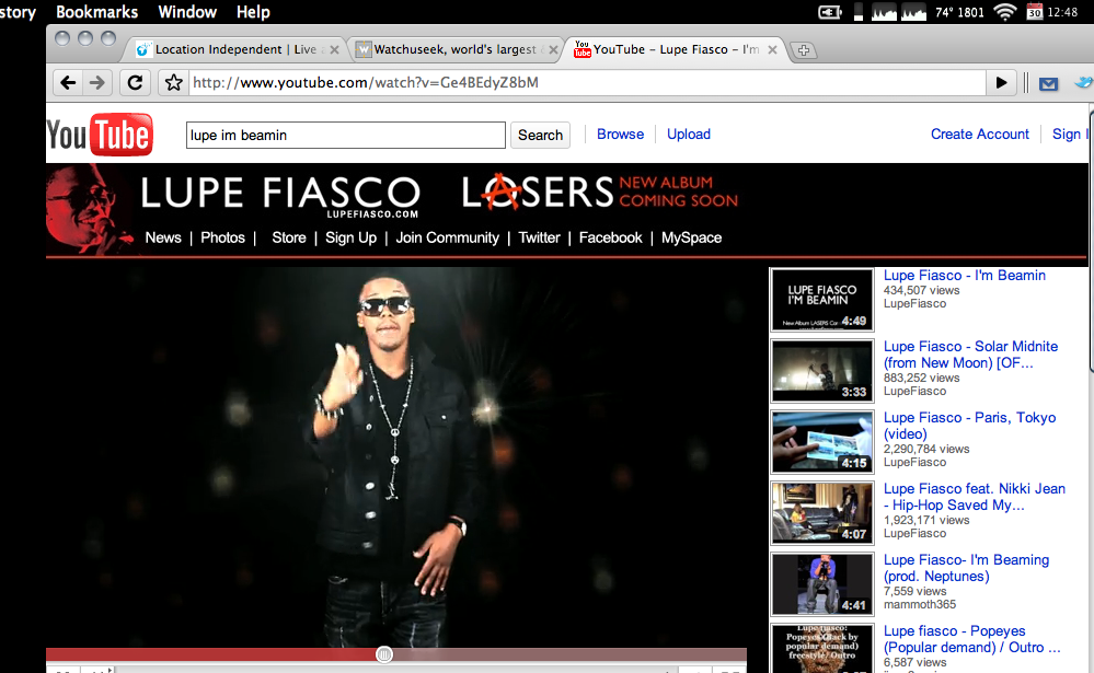

I just went through this. I have the last gen BlackBook before they went to unibodies. My 10.6.2 computer was getting up to 90 degrees celsius and my fans were spinning past 5000rpms at times. Usually only when using flash videos. Tonight I backed up my 10.6.2, upgraded to 10.6.3, and then took it apart with ifixit's heat sink guide. When I took it apart, there was paste all over the processors and heat sink. Cleaned it up, put on some AS5, and the fans have been much calmer.
For anyone with x3100 or older macbook's who are having little issues like this, I really recommend having the thermal paste looked at. If you do it yourself it won't cost you more than $15. I got my AS5 on ebay for like $7 shipped. I wish I had a photo of how it was before the fix, but this is how it is after:
