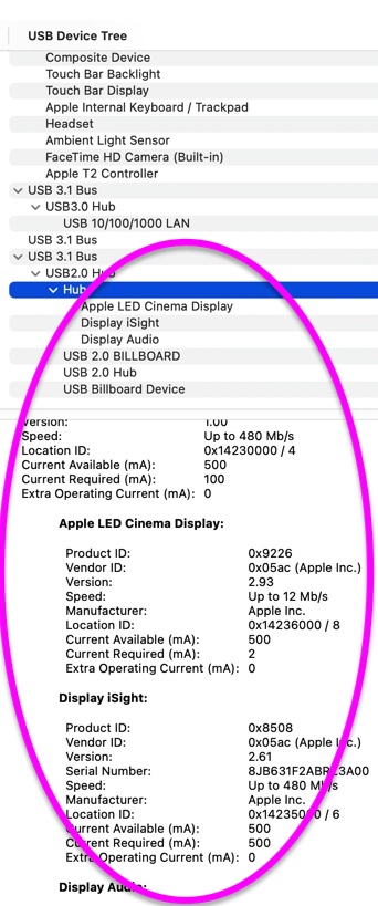

You are correct - the USB-C / TB3 port will not display on a Cinema Display using the MiniDP plug w/ adapter.
But the 16" MBP can still 'see' the Cinema display connected with identification as the correct monitor, speakers and iSight camera:
