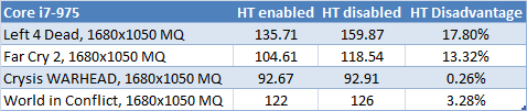

Hyper-Threading may even slow down some games so for gaming, just go with the i5.
Hmm, why's that? From the benchies I've seen in PCs with the i5 2500K and i7 2600K the i7 wins in games that use the extra thread and is usually the same in games that don't.

And for Hellhammer .. wow how so an i7 can possibly slower than i5 for some games? Does the hyperthreading decrease performance or what?
No worries, and no it wouldn't. The PS3 uses it's on GPU and CPU, etc.
I haven't really seen any games taking advantage of more than four cores. While the difference between the CPUs in gaming seem to be negligible in newer tests, there isn't much point in getting the i7 if there are no other CPU intensive tasks involved.
